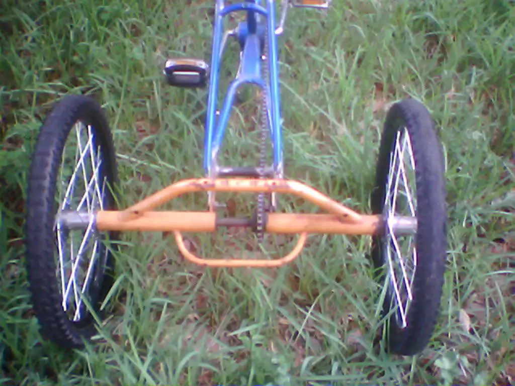

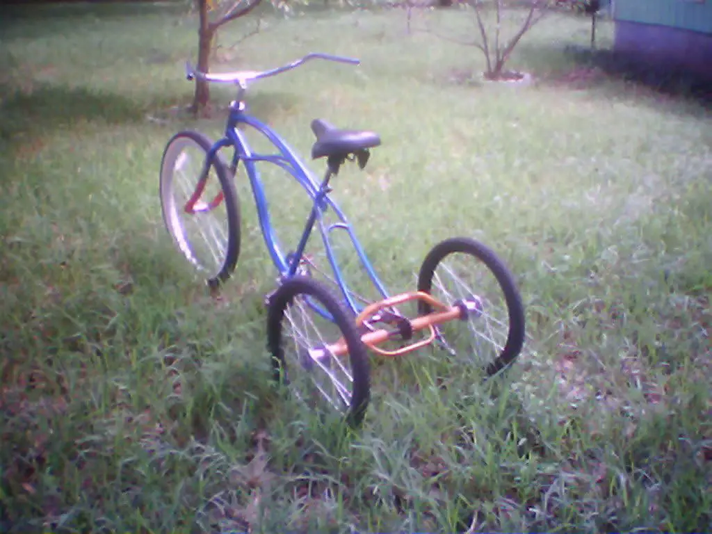

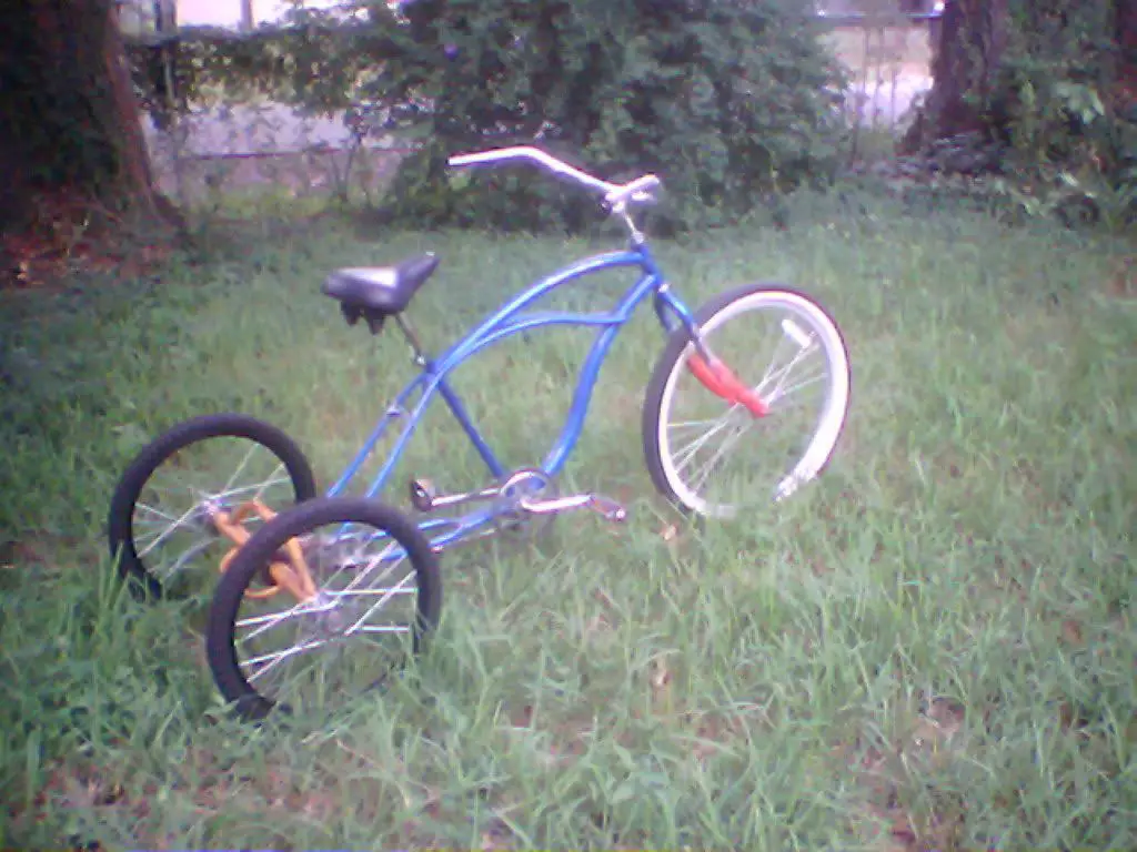

The electric dyno glide is coming along.
The back is from a Miami Sun trike, the rear rims and spokes are from a 20" Huffy Rocket. Seat and handlebars are moondog.
Front fork extended 3". 26" front wheel.

rear end. It's bolted on with 4 bolts so it will slide a little to adjust the chain.
I beefed up the mounts on the bike frame to make a solid mount.
Plans are for a wood flatbed on the back. A little flat bed truck.

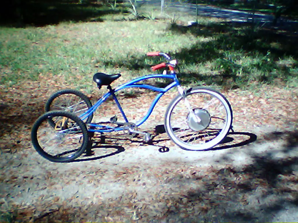

Front wheel electric hub.

updated picture. Motor fitup. I changed the fork and made it lower. It handles good sitting so low. The front fork is off an old Huffy cruiser, the handlebars too. The chainwheel is off the Huffy Rocket bike.
