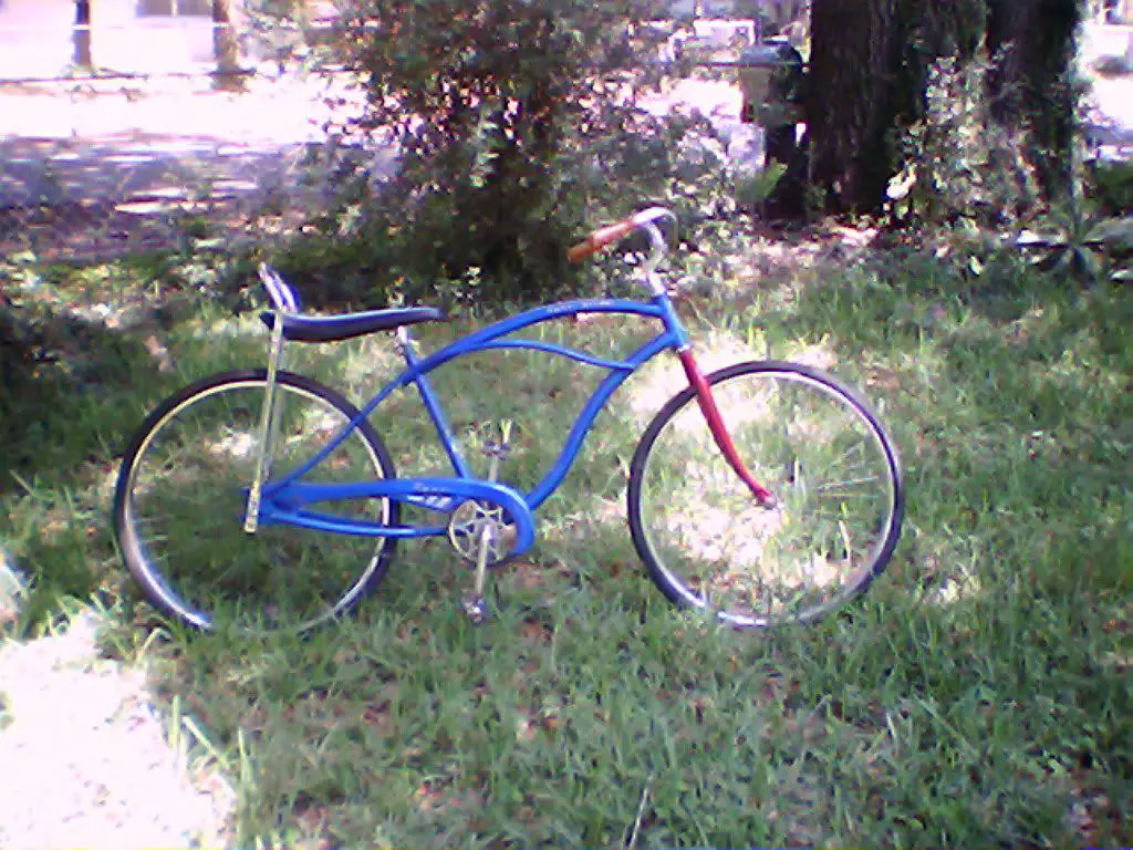

Got the electric hub kit Friday ! Nice kit. Pictures will come.
The fork that is on the Dyno will not work so now I am looking for a different fork. The one on it is not the original. I bought the bike for $10 with a broken front fork and replaced it with one off another.
Time to search eBay.

Hi deacon,
I like your bike ! ! ! It is like no other I have seen ! ! ! Cool ! ! !
