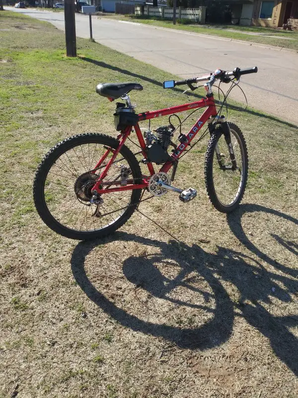

I'm currently in the works in putting an engine on a cannondale quick 8. I had to customize the front mounting bracket, the spoke on the wheels are 32s but I ordered a rear 36 and sprocket adapter on eBay. I had to use metal straps for the fuel tank.
Still a work in progress but it's getting there.

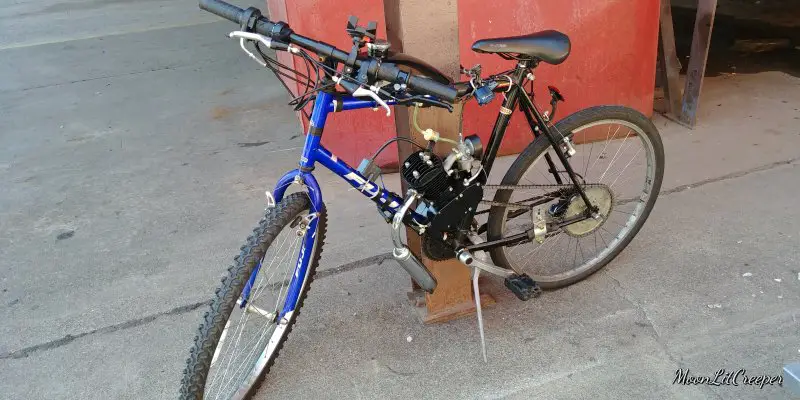

not a road bike, but a real light aluminum mountain bike. I have put over 2,400 miles on it and it runs great. I also ride it on trails and in the dirt, never had a problem or crack. I got tired of the tank being in the way and sliding around, so used a lawnmower tank, works perfect.

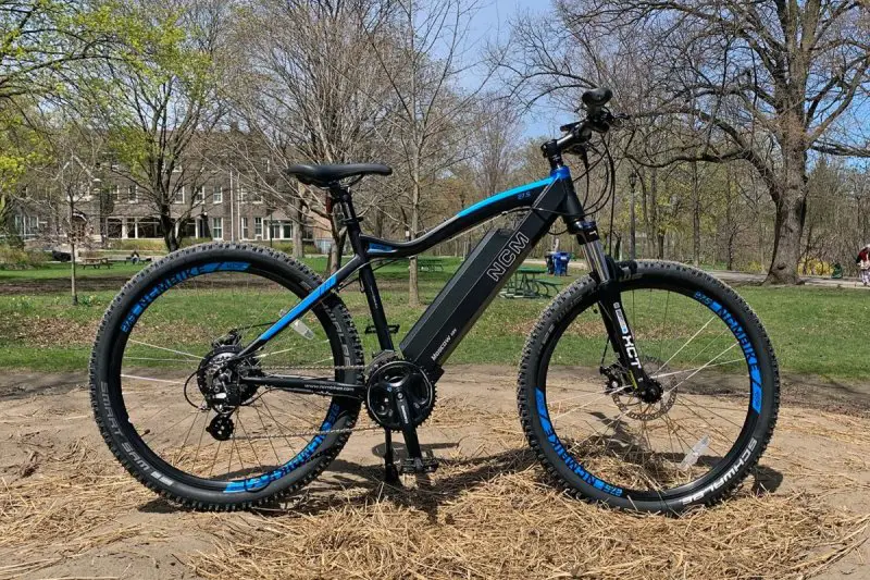

Since then, I purchased a NCM Moscow e- mtn bike that is far better for 1/2 the
price. In spite of the name, it's made in Germany. I guess the idea was to market
it in Russia. Anyway, just because of the name, they haven't sold well here.
They are presently going dirt cheap for $1059, absolutely the most bike you can
buy for the price. I paid $1300, still a bargain. It arrived from LeoncycleUS in
Seattle the day after I ordered it. (I live on the 'other' side of Puget Sound).
This bike will climb a tree.
The Germans are
finicky about engineering & use, be sure to read the manual carefully if you buy.
At this price there's plenty of wiggle room to personalize the bike.( see the EBR
review for spec, etc)
