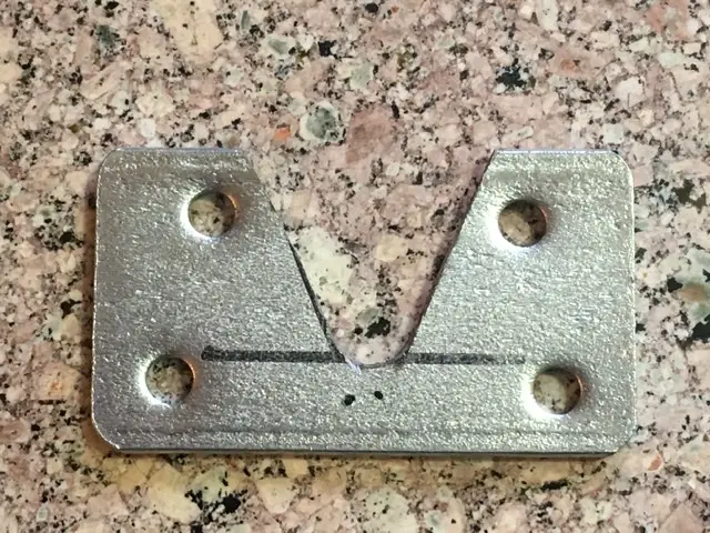

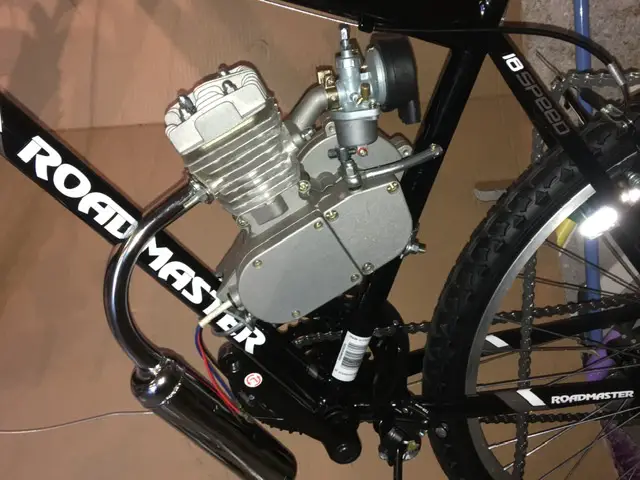

View attachment 104639 View attachment 104640
I have shortened one mount and notched another to get the motor sitting lower in the frame. Worked extremely well.
