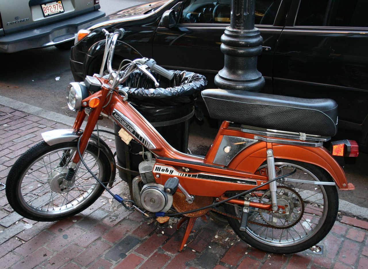

Would a 100cc two stoke engine such as YZ, RM, or KTM100 fit on a motobecane style moped?
I thought about doing a 50cc 9hp denardis set up, but I don't know if it has the torque. Another thing about the smaller engine is that you have to rev it high and run it hard be in the power band.
That is why i'm swaying towards the older, larger, and milder, 100cc two stroke engines from the 70 and 80's. Or Modern two strokes if I can find a
deal.
Would it be more cost effective to part out a dirtbike or build an a bought engine from ebay from the ground up(top and bottom end rebuild) and outward (exhaust, intake, ignition etc)
Thoughts?
