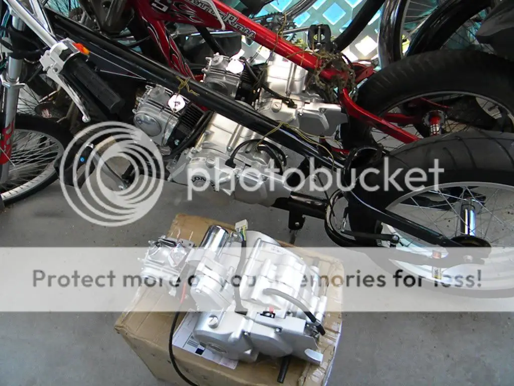

Here's a Honda crf 50cc pitbike/dirtbike cloned moped 4-stroke engine it's currently being mounted in chinese made mopeds, and yes these are Real 4-Stroke Mopeds With Pedals!
This engine is bare bones no pedals, intake, carb, cdi, wiring hareness all will have to be added:
If you look closely you'll see a lil red tipped lever above drive sprocket this is where you switch between pedal power & engine power.
