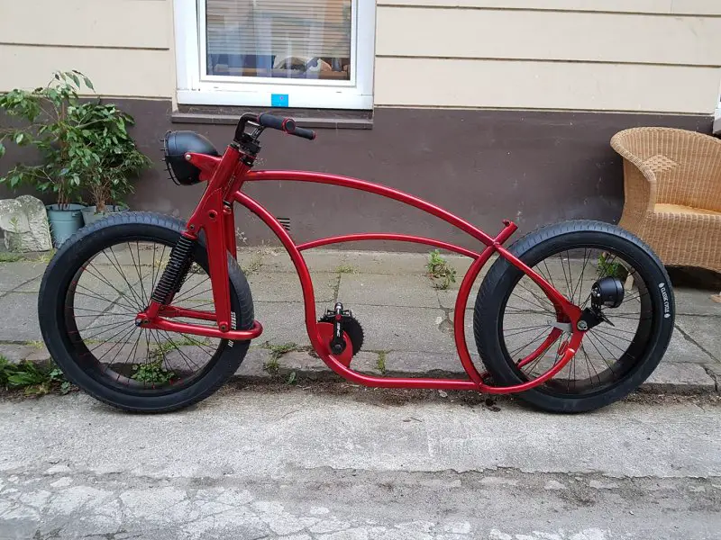

Hi, guys. I have a question, would moped forks take a bicycle hub?
This looks at a first glance like a bicycle hub, but I am not familiar with hubs:
