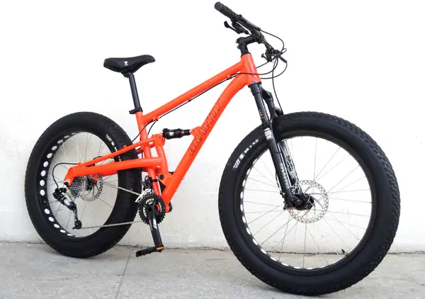

Full suspension on a fat tire is silly to me, the thing already floats along over everything with no shocks, though a front shock might be nice.
