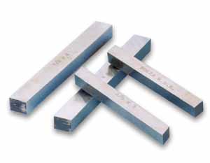

A few of these:
And one of these:
Is all you ever need for working aluminum on the lathe. Much better cuts with sharp, honed HSS edges on low horsepower machines.

You'll be able to shape that tool stock exactly as you need it. Should work just fine on aluminum for you.

learn to grind lathe tools and blanks to grind

LOL Dan. Carol wants to make one of the practice tools. She was worried it would not come out right. I told her it wouldn't first few tries but like a pencil, we can just resharpen it.
So we are having a tool making date night, tomorrow during the day. Just tried one my self. Butt Fugly but will work. Bit of an art to it. But kinda fun.
Curt, did it on the lil POS (piece of stuff) HF 3" grinder. Can'tbeat that thing for $19,95 -coupon.
Thanks again for the suggestions, FFV & Greg!
bottom pic is the pre-made and top is the DIY.
