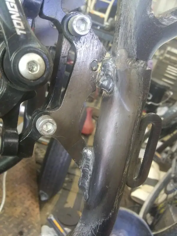

Scratched that. I'm just going to dedicate to it being just electric. I chased the assumed stripped threads on the disc mounting holes for the electric rear wheel. Now I've got a disc brake mount welded to the frame. This Seattle was meant to be the Single Speed.
To mount this I bought one of the cheapy adapters, flattened the bends out and checked the caliper with the wheel on. I had it in a ballpark so I vice gripped the adapter in place, removed the wheel, and welded it in.
If I didn't do this I wouldn't have had any way to mount rear brakes, except maybe make my own scrub brake.
The calipers have a lot of room for adjustment to the left or right, so I can really dial it in.

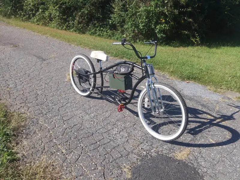

Very very temporary mounting solution for the battery right now. Ammo can held to the top tube with hose clamps level temporary.
Even with just a 750w controller it can carry me uphill thanks to my headway cell battery.
Not really any good way to mount this inside the bike though, I'm leaning more and more towards a sidecar with a trunk to hold the batteries. I also need to look for a stronger controller, maybe a 1500w one. Also need to find a twist throttle, this thumb throttle will get old really fast.
Also brake cables. I'm just riding it up my driveway and back for testing. I have a 6 speed derailleur on the wheel but it's locked in on the smallest gear for alignment. When the motor starts to slow down going uphill I just start to pedal assist and it gets back up to speed and stops groaning.
That Troxel seat is extra comfy, too.
