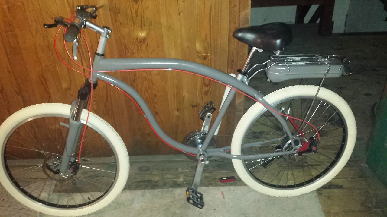

Hey guys finally got the picture of the bike. Got it running for a ride around the block today and when I went to go take it on a longer run the engine started squealing on start up and then wouldnt keep running. I think its a carb issue but I dont know for sure. I am working through it. It was a strong runner last year so this is surprising.
Anyways here is a picture!

Check your head for tightness too. Could have been squealing head gasket leading to loss of compression and no fire.
You were right it was the head tightness. Now I just need to readjust my needle valve for the proper idle and it will be back to being a strong runner! Thanks for all of the help!
Joe
I like the fact that used the red cable housing, my theory is the black ones are so ugly but you gotta have em so accentuate them with color NICE!
