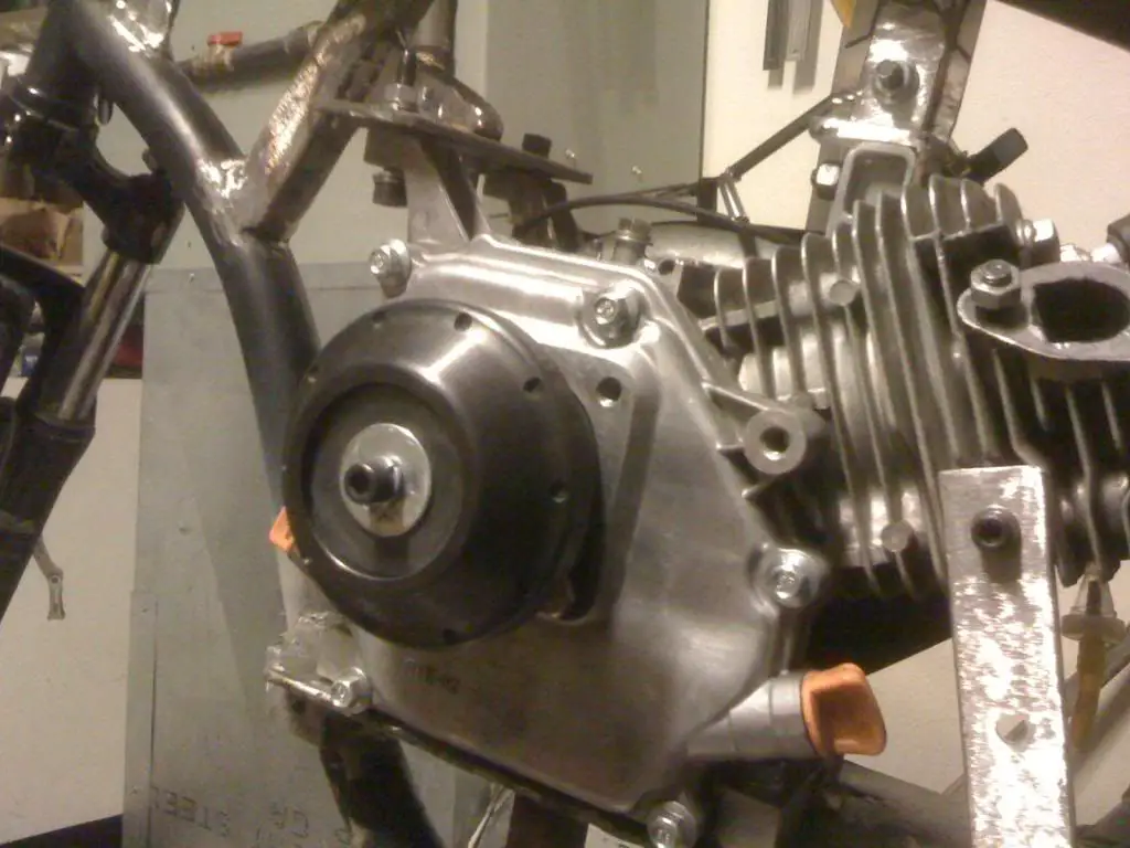

It is a nice looking unit, and I will be putting it in a build soon.

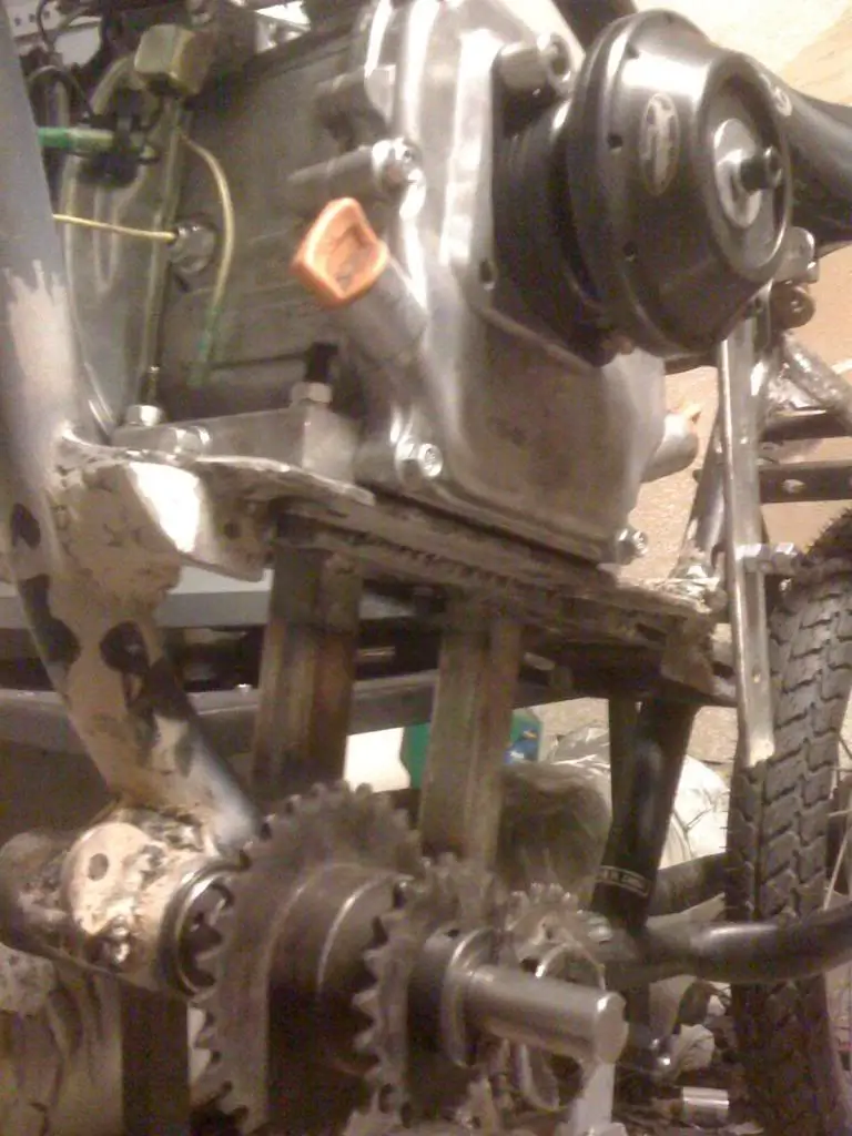

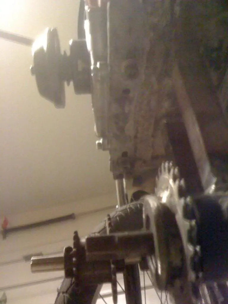

i"m working with it now. I have to completely rework the jackshaft position as the spacing between the clutch sprocket and my rear wheel sprocket is 3.16". It doesn't help that my motor was mounted 1/4" off to the left neither. Anyhow, the clutch sprocket is 4.75" to the left of the bike's center line for my setup. If I have my shaft on the seat tube, and the sprocket installed, it would eat my thigh up. So I tried using the SBP HD freewheel but the 206mm (just over 8") spindle is too short, and with a 54t sprocket installed, it probably would eat my calf up if I'm not careful. I ended up fabing the jack shaft in front of the down tube. I feel a little safer with it in the front.
Spindle too short
I still plan on utilizing the spindle to drive the rear wheel. With the shaft mount up front, I have enough room for disk brake, and also to drive dc permanent magnet to recharge the battery.

I had it on a bike for a little bit. Works well, bump starts are good. Ran it hard for a few days to check it out.
I am in the middle of changing the 35 chain setup. Running over 6000 with 35 chain in the primary is not the best thing to do. A few days had the 35 chain beat up a little.
On a lower revving engine like a 212 it should be a very nice clutch.

I will put the clutch back on a bike & try it again. Never had any trouble with the clutch, just the chain. It is a decent clutch, a little different fell than a wet multi-plate motorcycle clutch. It feels very much like the dry single plate on my 1926 Harley.
