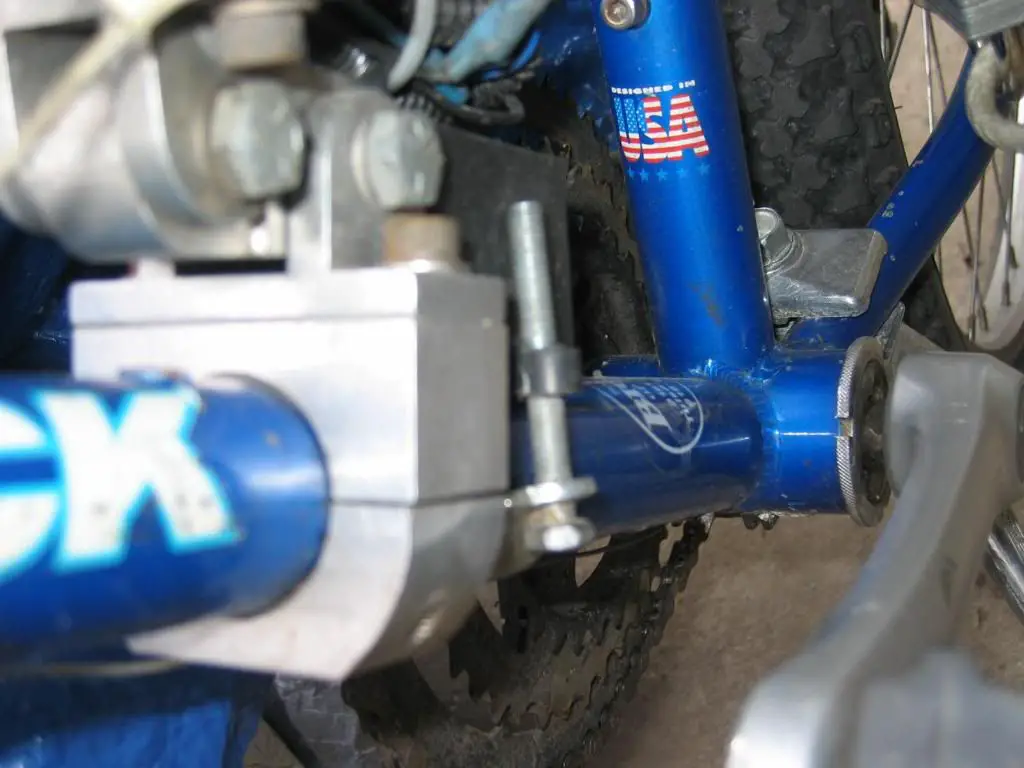

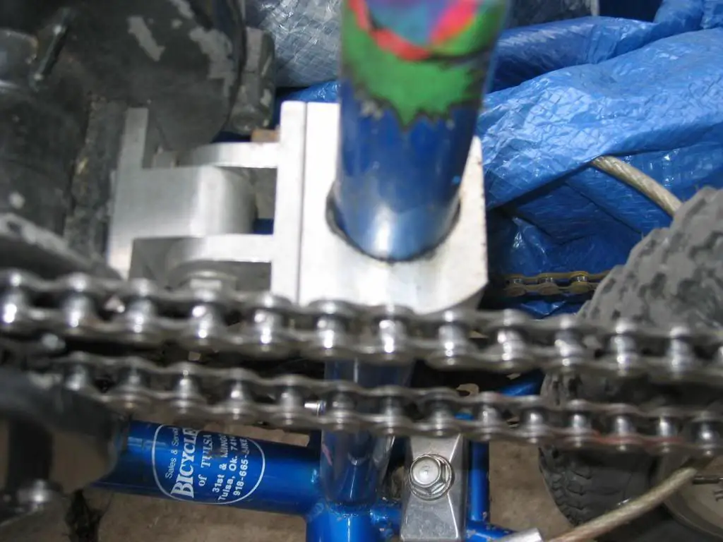

I have a few pictures of my installation.I'm currently in the process of trying to sell my motorized bike because I'm losing my house very soon turning 18 and need to have money for somewhere to stay..Its terrible here in Illinois..Anyway his products are much worth the wait guys and I've had no problems with the motor mounts they dampen most of the vibration produced by these motors and all I can is wow had a great time using them on my setup.Totally worth the money!
