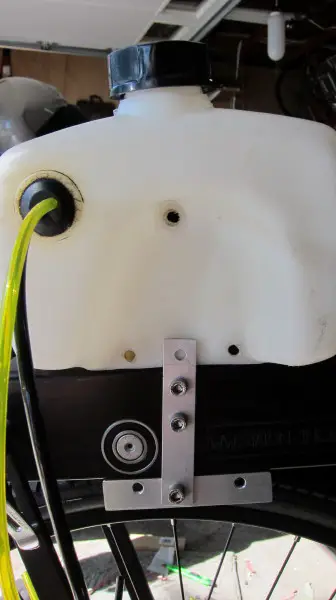

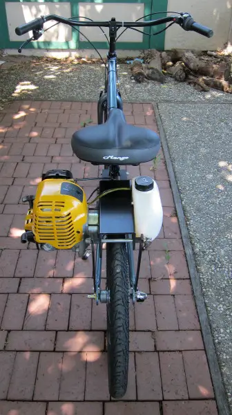

Added a remote gas tank. This is the 50 oz tank that Staton sells, which doubles the fuel capacity. A couple of aluminum bars, some drill & taps, nylocks and spacers and we are ready to go.
The tank is secure and works great. No leaks, started up 2 pulls after I primed it and it ran around the neighborhood fine. Lot better balanced look I think.
Also a lot easier to gas up with the cap right up on top and not tucked under the motor.
Since the motor looks so much better w/o that gas tank under it, I went one step further and sliced off the little extension on the recoil starter.
I think I got this looking just about as good as a friction drive can look - :)

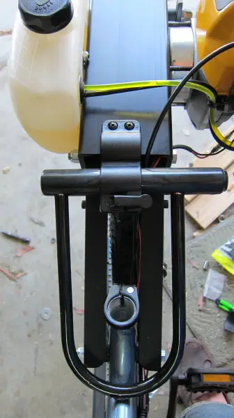

Added a bike lock. Wouldn't work on the seat post, so I put it on the drive bracket. I am getting a good lotta use out of my drive bracket - :)
