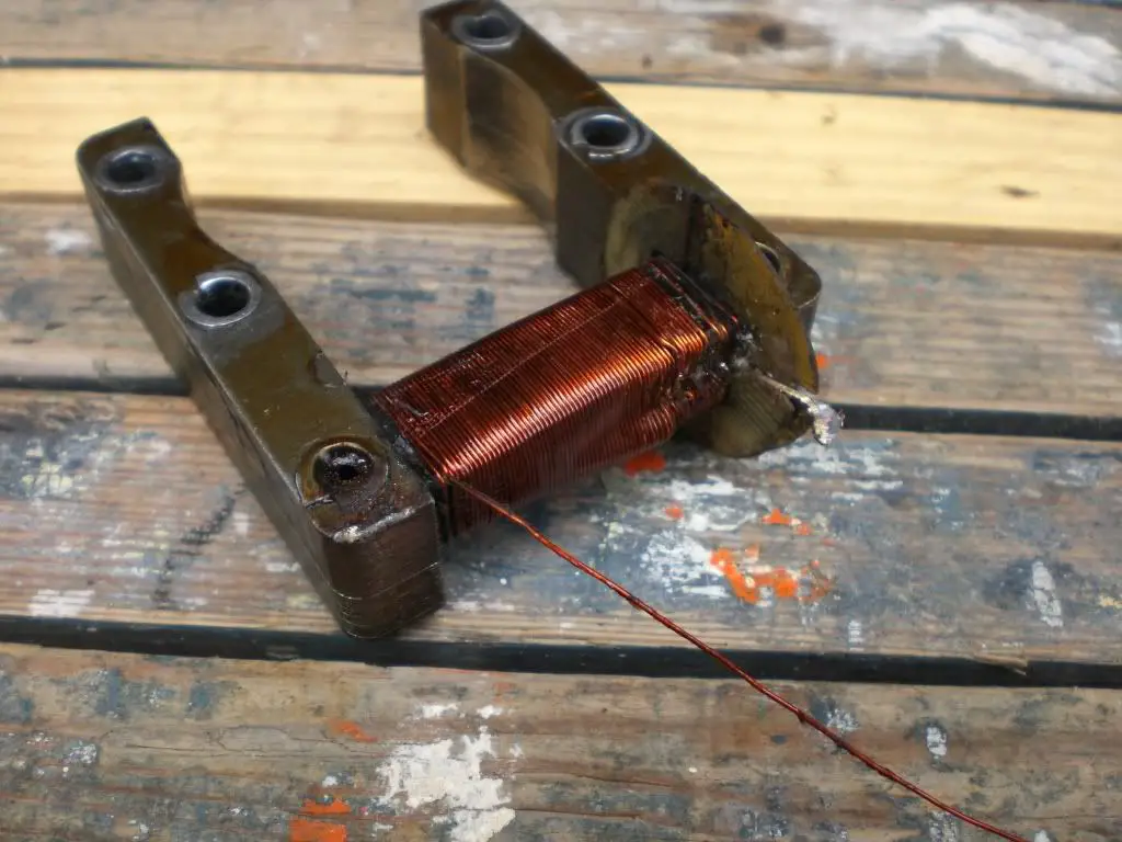

I got a kit from bikeberry, the motor itself has lasted 60 miles or so, I've burned out two magnetos and one cdi...possibly two with the latest malfunction...I tore apart the magneto out of frustration figuring I would just rewind it at some point...it was burnt out completely, black spots in the secondary finer wire, smelled like melting and burning epoxy, no good...rewinding it shouldn't be difficult, not with the ideas floating around in my head anyways...think drills and crazy glue and a stop watch...anyways, I'm broke so I can't go and get the wire to rewind the mag with...but eventually I will...btw, I have beaten on the motor...it's just the ignition that is completely lacking...if someone wants to send me some wire so I can figure out exactly what will work or not that would be great...I was thinking of using a slightly larger diameter wire going from a possible 28 gauge to a 27 gauge...I'll figure out how much more current that might draw...if when I get the money to, I am able to rewind the magneto, and get it to work, I will post details...but the process really is straight forward...it's just the number of turns and diameter of wire that makes it difficult

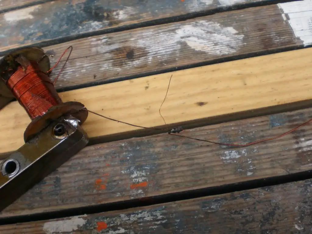

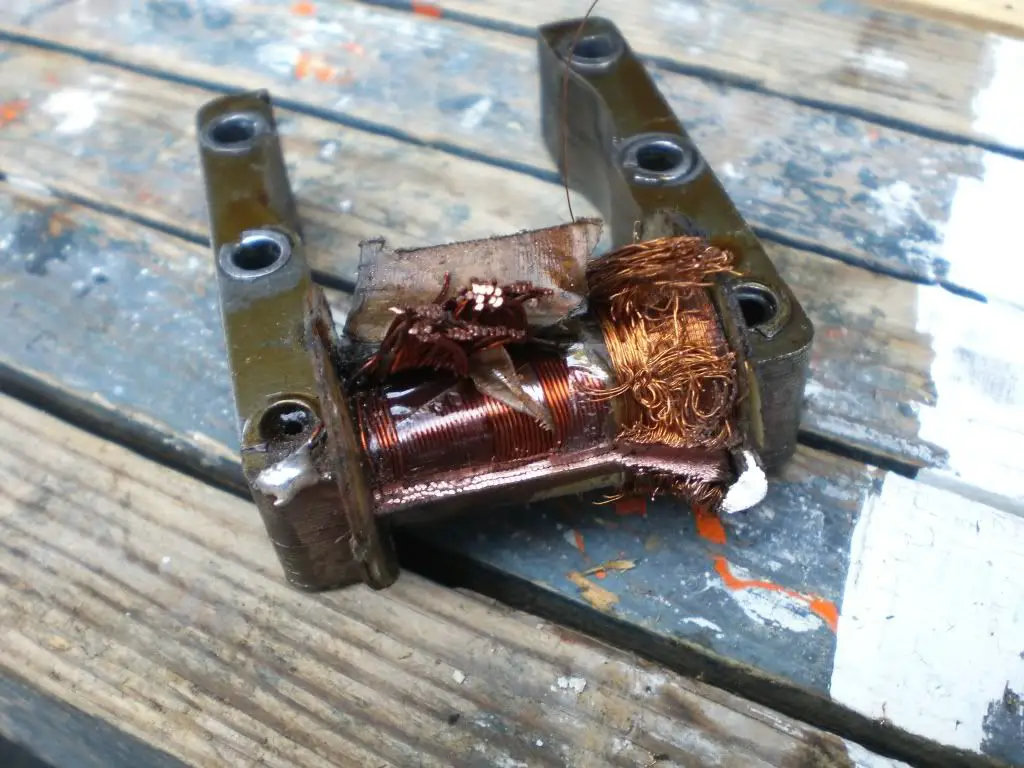

I just totally ripped apart my magneto and what I found was this the bulk of the thin gauge wire is the blue wire connected to the ground and the white wire. The first part of the windings like 5 layers (a layer of tape separate them) is the white wire a thicker gauge than the blue it is connected to the ground and the blue wire. So both the blue and white have a common ground. The rest of the layers (no separation of the layers) blue is just spun anyway the person who did it felt like.
Pictures below
White wire
You can kind of see where they are all connected in this pic
You can see the separation of the layers of the wire here and the blue windings most of it taking off (note their is a layer of tape between the white and blue layers).
I am going to rewind the coil and separate the grounds between the 2 that way their will be loss of power when I want to hook up light system to it. Their will be just 4 wires coming out of the magneto cover instead of 3. I will also get rid of the ground soldered to the magneto.

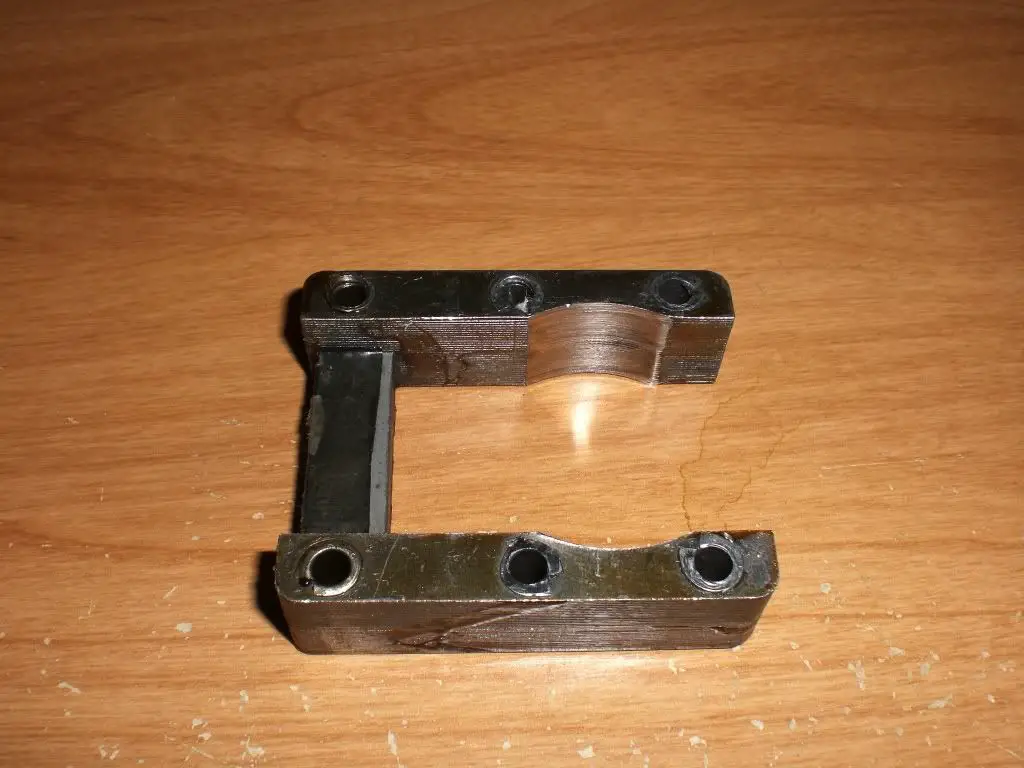

empty magneto
