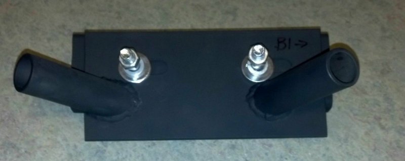

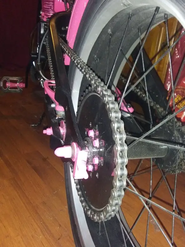

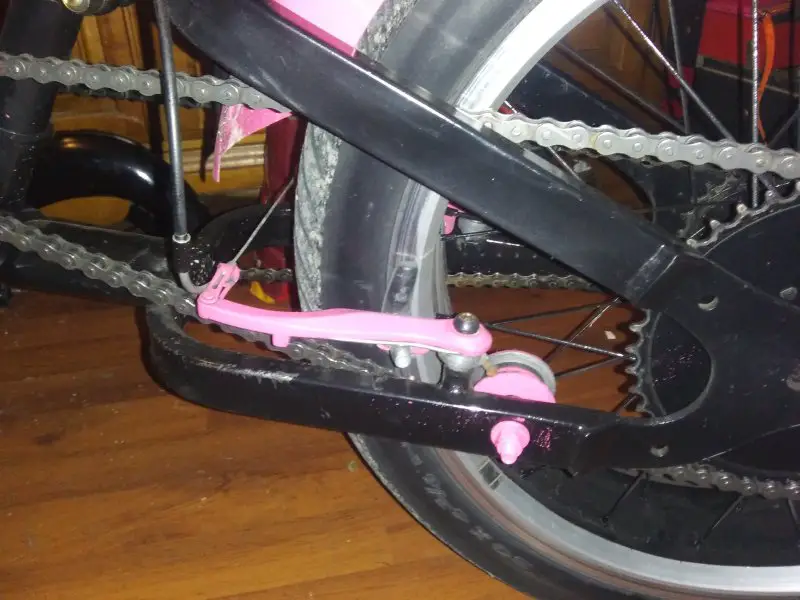

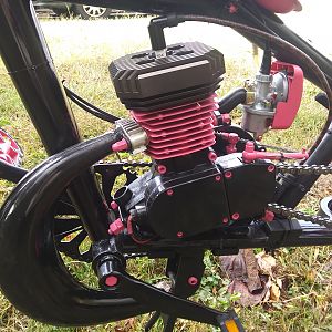

that depends on the bike frame, my OCC runs a 4.25 rear tire width and the motor mount offsets the engine to do that, but its nothing like a standard V frame..the mount i currently use was ebay you can see the mount in the picture.... kelly

Hay......Kelly, good lookin set up ,couple of questions n stuff , cannot see the tire angle for your chain drive if you can photo maby from the front wheel axle height to the back wheel wondering how close the chain rides and your exhaust looks great bet its loud late at night ha that's great but is that a spacer between the flange and cylinder and what's the purpose? To make the header longer for more low end power? Or to clear the fraim style? And a totally bitchen job on the paint A1 for sure ,ok thanks

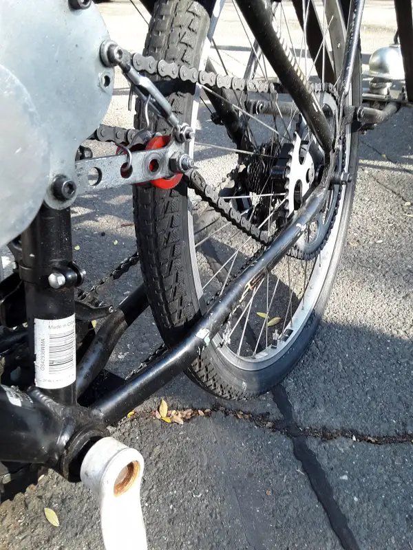

This the work bike chain with hub adaptors and 56t CD sprocket on a 26in wheel on a29in bicycle the original went flat this works for now ...........lewdog... over

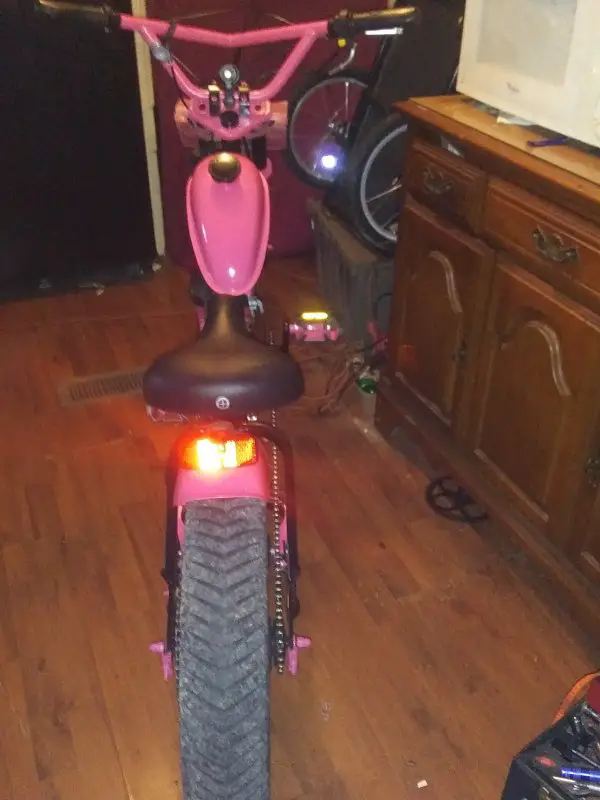

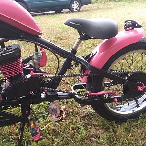

my daily rider is often a case of works for now : ) the little exhaust port is called an X-Port and was originally bought as a performance thing but its about worthless in that regard, but i needed pedal clearance on the pipe so i ground the x-port off in a wedge nothing on one side down about 3/8 on the other end and that turned the pipe inward enough for pedal clearance .. some pics of the rear on the OCC got it out and rode today it needs a cleanup ....kelly

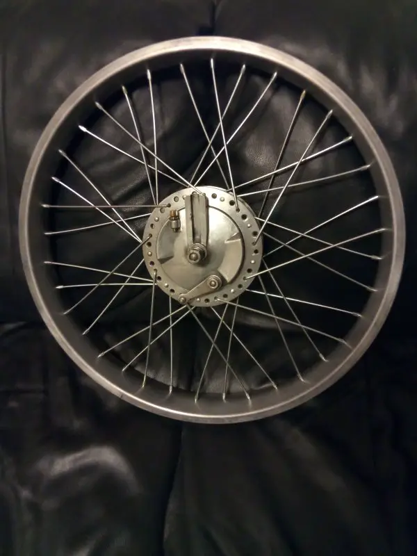

Trying to find a 24x3 rim is a *****, too. I got some weinmann dhl65's a few years back, but the place I got them from is long gone. There's a place in Germany you can get them if you want to spend the money.
https://www.robsson.de/en/wide-rims/36-spoke-holes/double-wall-rims/24-rim-size/

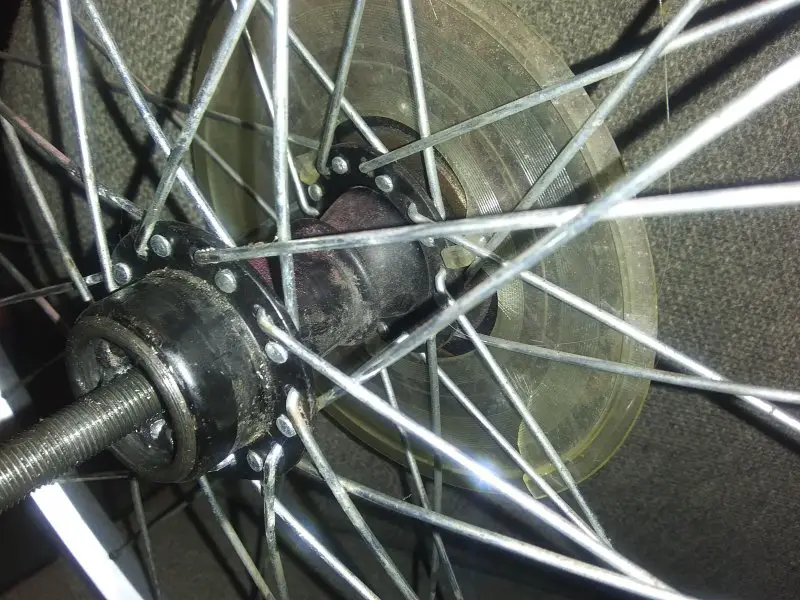

huskybicycles or worksman have heavy duty wheels. I've been building and riding a bit less than 3 years and I can only speak of my own experience. Ive seen a lot of problems and things break mostly do to my own ignorance or getting in a hurry, but i havent really had problems with spokes, poor maintenance on bearing has been more of a problem but not spokes not even on cheap wheels for average use i dont see any real problem with spokes. Including a picture of my most recent break down the hub is kinked real bad at start up the bicycle chain bound up but the motor caught and this was the result the hub is shot but the spokes are hardly even bent and i was using a rag joint as well.... kelly
