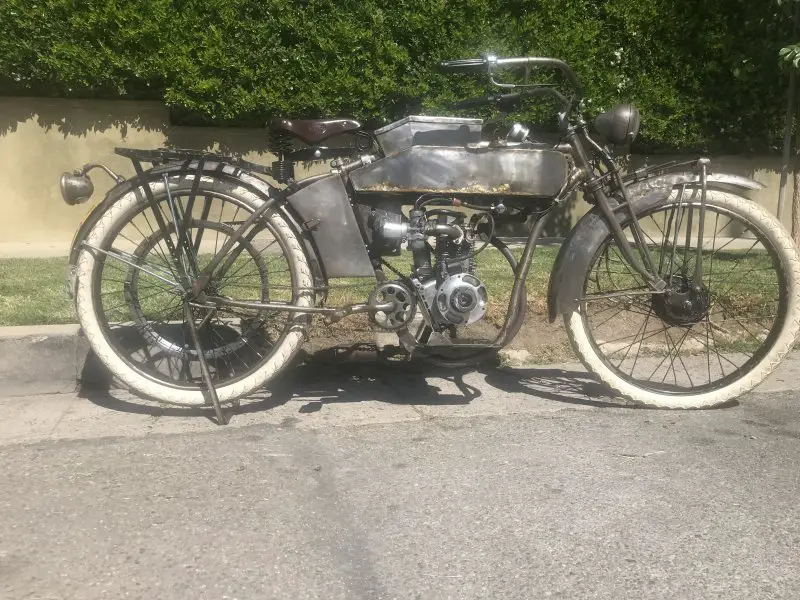

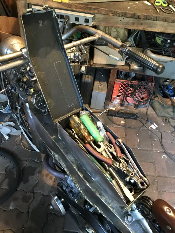

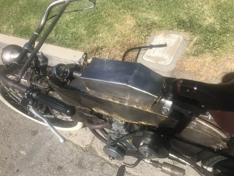

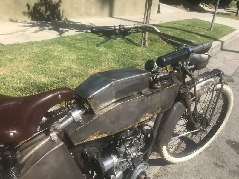

Hey Everybody,
Sorry I’ve been away for so long. I’m still riding and wrenching, just not posting here.
I recently made a toolbox for my bike. I like to have LOTS of tools on hand, as I ride fairly far away from home at times, and something invariably breaks, comes loose, or otherwise needs maintenance on the road.
I usually use a folding canvas tool roll strapped onto my gas tank, so I decided to try and build a metal tool box like some vintage 1900’s motorbikes.
Just thought I would share.
Stay safe,
Gilbert

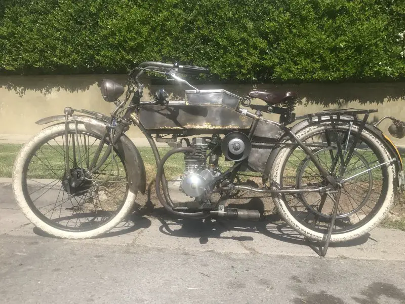

For instance, a few months back, I was riding with my friend Bob and we stopped to discuss routes, then he looks at my bike and says, “Is that a crack in your frame?” Sure enough, my down tube was cracked all the way around near the head tube junction. Scary, but I still finished out the ride, because I figured it had been that way for a while,
Once I had it back in the shed, I had to dismantle to the bare frame and brazed in an outside sleeve over the frame crack,
I had to do a similar frame repair on my chain stays near the bottom bracket about a year ago.

Thanks for the compliment. I finished this bike (my only bike) in 2012, so it’s 8 years old. Miles and n the bike? I don’t really know. I would guess it’s in the thousands, but how many thousand, no idea.
I hear you on the frame cracks signifying something, but I built this frame as a custom one-off using a vintage women’s step through frame, cutting it up where basically the only original frame parts are the head tube and the seat post tube. I bent, shaped, and brazed the new down tube and top tube using interior lugs. I also cut, lengthened a few inches, and spread the rear chain stays to fit the rear sheave.
In other words, hours and hours of work for me, and it just seems easier to braze the crack, then sleeve mend it and add gussets if necessary. Less work, and hopefully I‘M making the frame more robust In the process.
