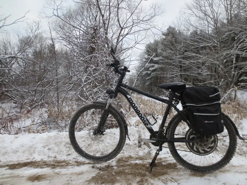

Im Running 72v 15Ah batteries, with a Crystalyte Brushless hub motor, It gets me up the hills when I need to get there, I peddle to get it up to speed, and to get up the hills faster.
Im about 190, and Ive carried people on the back of the bike on 2 separate occasions, 1 was 150, the other was 230. Both times we went up hills reasonably well (I helped with both but it was easy to maintain 15 and pick up to 20) on the flats and slight downhills we picked up to about 30 Once I add a sidecar to the rig I intend to put a second hub motor on the sidecar wheel. That way Ill have Zero trouble with hills of any kind, with or without passengers and be moving at my cruising speed, closer 35 :)

thanks for the reply, I had forgotten about this forum, until I got an e-mail with your reply. In the end of summer I was planning to get on this, but I loaned my ex-roommate and ex manager $1000 and he was going though some financial stuff but hasn't given the money back yet. Another issue I have now is that unlike where I use to live (where everything was in regular biking distance) I now live in the suburbia where you get in your car drive to the island shop... basically everything is so spread out, and the cool hippie/ progressive things aren't even close to me at all. So I've been thinking about getting a car... bleg! but just so I can get around. Luckily my work is just a 10 min bike ride but the grocery store for instance is... Well I guess its not that far its 2.4 miles. Can a bike like that handle longer distances? I like bike riding alot more + my license expires in a year and I dont want to renew... my paranoia I guess about not wanting an updated picture.
I cant afford this right now, but do you have any links or info on the products you used? I'd like to make this a hobby when I can.

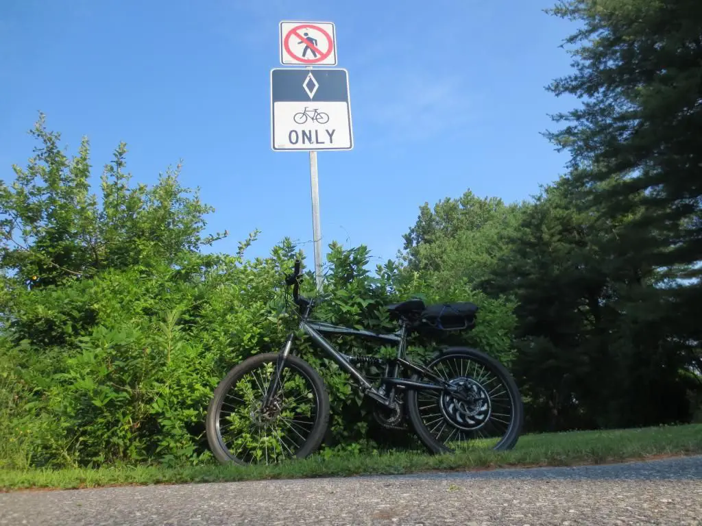

Nothing special in any way yet still feature rich (regen, lighting options, cruise control ect), my plain ol' beater/commuter gets roughly 30/30 with limited/no pedal assistance (30mph for 30 miles) for less then a grand total investment, including the bike;
48V 15Ah V5 LiFePO4 $533 http://www.pingbattery.com/servlet/the-12/48V-15AH-V2.5-LiFePO4/Detail
26 Inch Rear Magic Pie 2 Conversion Kit $267 http://www.goldenmotor.ca/products/26-Inch-Rear-Magic-Pie-2-Conversion-Kit.html (note, fully functional but dated, they've the MP 3 & 4 now)
...you can shop around & try to save a couple few bucks with ebay/generic hubs if you're willing to take the "no returns" chance, but the one thing with an ebike you shouldn't scrimp on is batteries. For simplicity & longevity bite the wallet & throw down the pennies for LiFePO4, you'll not regret it ;)
About three years of constant abuse later, same hub & batteries, different bike (old one was fine, this 'uns fully bouncy is all lol);
