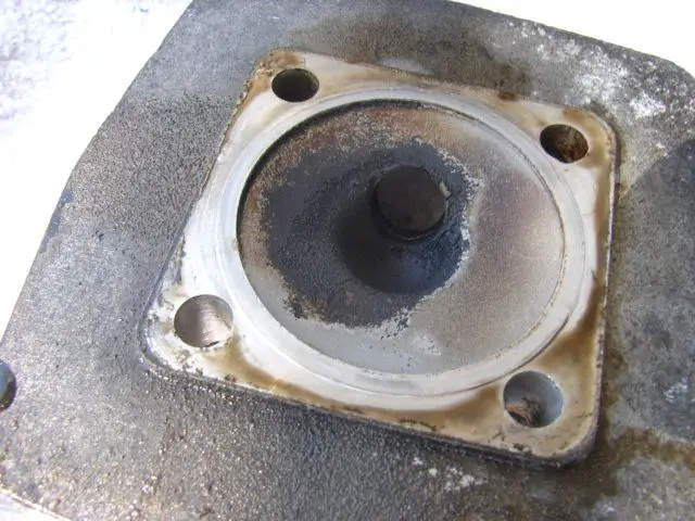

Look at my cylinder and tell me whats been happening...
borntofli

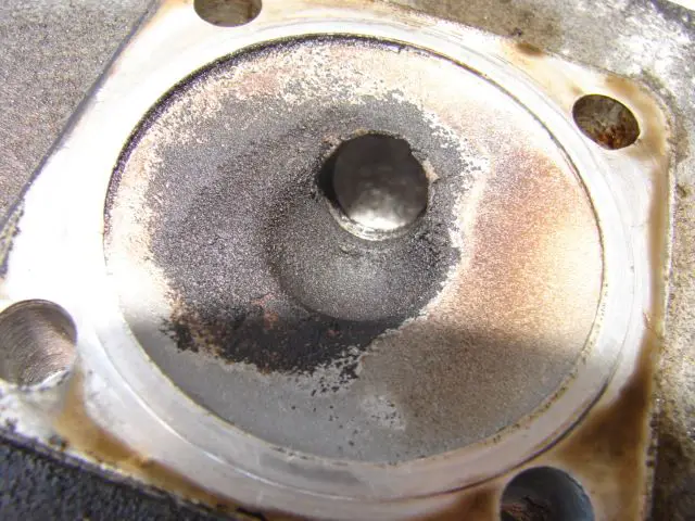

Took the cyl off an engine that has about 600miles on it... It was leaking out the base gasket...
The head......
borntofli900/DSC06382.jpg[/IMG]
More pics next post..

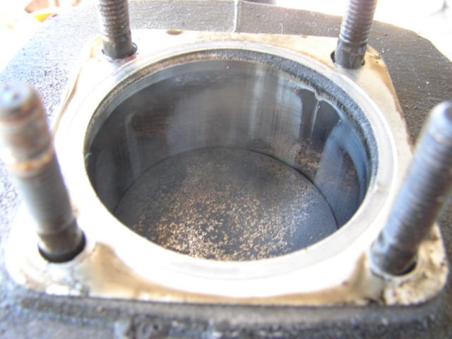

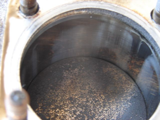

And the cyl...
http://i599.photobucket.co[IMG]
[IMG]http://i599.photobucket.com/albums/tt79/borntofli900/DSC06384.jpg
By the looks of this can you tell me whats been happening inside my engine???
What parts are still useable??
Looks ugly to me, but im inexperienced in this....
Your engine actually looks great, however, what oil to gas ratio are you using? Judging by the large amount of oil in the cylinder, it looks like you're running a lot more than you need to.
50:1 amsoil after breakin...
Should I just clean everything up good, dremel out the burrs I see on the ports and plug hole... Replace the upper needle bearing and new gaskets...
It kinda looks like you may have pushed it too hard while it was trying to be broken in.
The rings had not yet sealed well, and there was a lot of carbon rich blow-by.
It's a chinagirl... clean up the piston real well with solvent, and the ring lands, replace base and head gaskets, scuff the cylinder in a nice pattern with some wet n dry paper, and give it a shot at breaking in again.
I think, (again), many folks expect too much performance from these little baby motors and push them too hard. Maybe try a real easy break-in???
The full synthetic may not be the best to use for break-in oil, too...
Good luck
rc
Looks pretty decent to me. Clean it up, replace whatever needs it, and keep on ridin! I'd also say the oil mix was a bit rich from all the brown stains. As long as the cylinder is smooth, it's healthy.

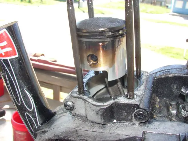

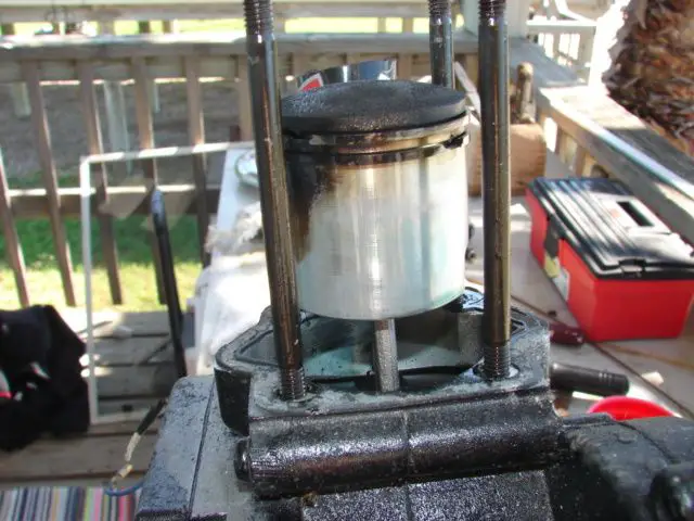

actually just blew my top end...not very happy about it...but all i can do is fix it...was riding and it made a funny noise then just stopped running...no compression...after removing the head i noticed a lot of black burnt oil...too rich by far...but when i raise the piston without removing the jug and peering through the intake port i noticed that i could not see the rings at all...and yea i definitely have been running it a bit harder than i shouldve...definitely operator error...any suggestions for me? anyone? ill take every bit i can get cause like some others im very dumb when it comes to mechanical stuff...

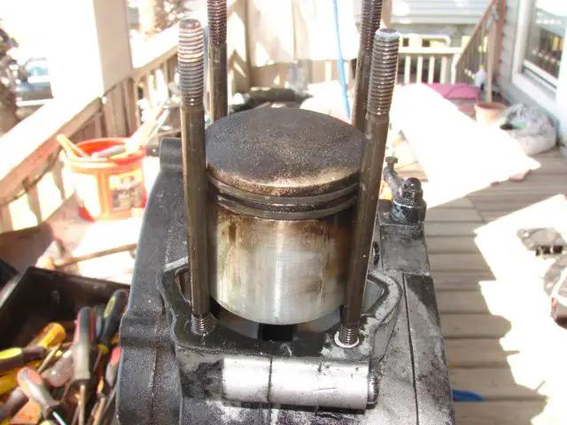

After cleaning up all the burrs in the ports and cleaning all the carbon off i put it back together....
I have about 250 miles since this teardown.....This is one fine running engine now...Super smooth and good throttle response... It's like riding a motorcycle now...
