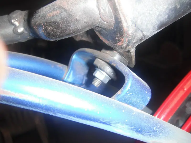

Mark, the most likely cause for your pipe breaking is vibration. Personally I like a rubber mount out at the end of the pipe and here's a pic of mine to give you an idea of what I mean.
That's a grommet with a metal sleeve inside it for the bolt to tighten up on. No metal to metal contact. The idea is to go ahead and let the end of the pipe vibrate thereby relieving stress on the thin metal they're made out of.
Your situation is obviously different but I hope that helps.
