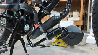

heres what i got so far
66cc zoom engine
ported 2mm x 2mm ex
2mm x 2mm in
4mm deep boost ports in between the transfers and intake, going as high as the intake
piston skirt cut to match the intake
no base gasket
head has bin lathed to remove the flat spot in the combustion chamber to allow the piston to come up farther (acting as a stroker crank and real swish
port mached everthing
stock looking chrome pipe, its a lot better then the stock loud as **** black one.
stock carb, missed with jetting and clip a bit
so what would be some things i can to to make it less noisey ?
