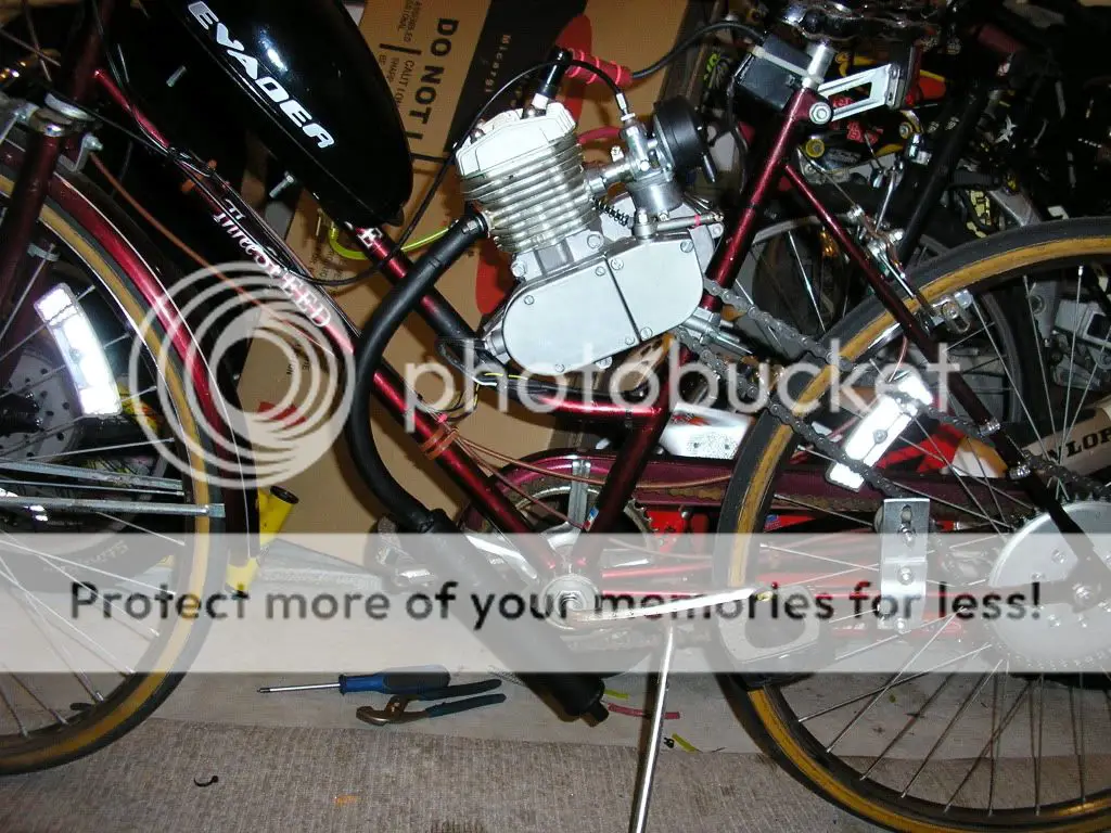

Well I found this Bicycle behind a garage, and the lady was happy to give it to me. I had a 4 stroke lying around with a seized motor. Look, you get these Chinese 4 strokes, replace the clutch, or risk fixing or replacing the motor. The clutch broke first day I owned it and motor clammed up because of it!
Montgomery Ward Hawthorne Ladies Bicycle, 24"

2 cycle oil is stinky. And she can just gas up with no hassle. Putting a full synthetic in it. Actually, I am kind of jealous, this is a sweet ride! I will probably upgrade the fork to a sr curved suspension fork if it comes in 24" Only thing about this bike is it has wishbone in the back behind the seat. It has absolutely no give to it. If you ever road on and hit a bump while sitting, you know what I am talking about. Suspension seat post likely in the future.
