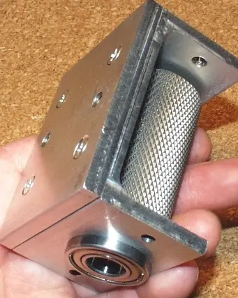

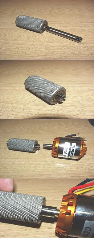

Thank you. Logic told me that was probably the case. That leaves me with an unthreaded 8mm shaft that's only 1.25" long. There's only a square hole in the front where the weed eater cable connected. How in the world will I be able to connect a roller...
How about a sleeve as Ron stated and drill a hole in the shaft and attach the sleeve/roller to the shaft with a roll pin.
Here's an example I've found on Endless-sphere.com:
http://www.endless-sphere.com/forums/viewtopic.php?f=28&t=22187&start=120
Granted, it's for an electric motor, but should still work for a 25cc weedeater.
http://motorbicycling.com/attachment.php?attachmentid=47441&stc=1&d=1335510124
http://motorbicycling.com/attachment.php?attachmentid=47442&stc=1&d=1335510263
