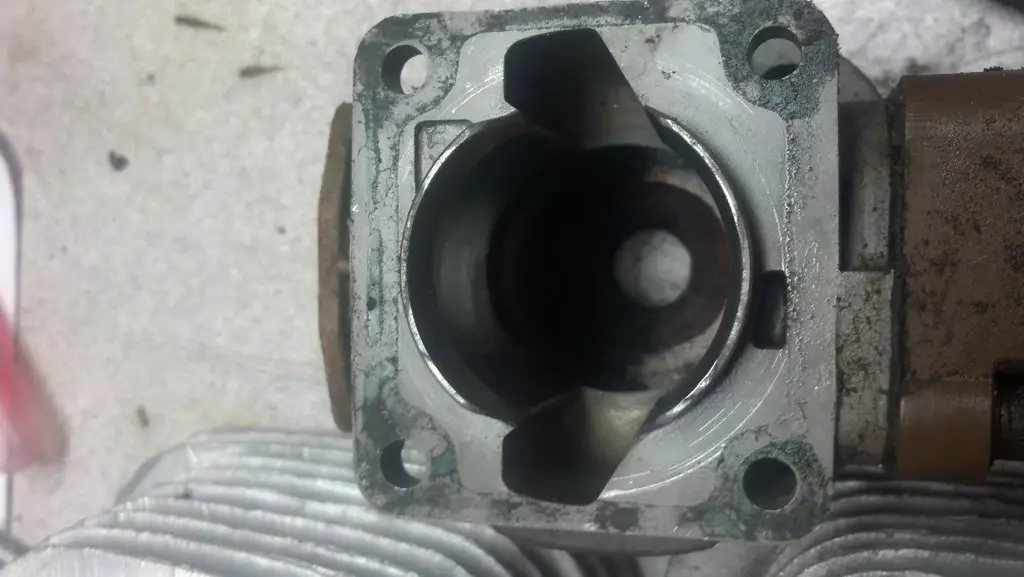

I have the transfers dead nuts even on both sides, from the factory one port was like 3mm lower than the other... thats some serious torque loss in the high R's.
My transfers where pointing toward the intake port stock. on my previous build i had that 3rd T port added remember? well this new cyl is not running a 3rd t port, i want to see what difference i will notice.
from cylinder to cylinder the one on my current bike has way way less T port work than my brand new one and still resemble the stock pointing towards the intake.
Anyway i think that the only thing will happen is the powerband will kick in at a higher rpm. Once that scavenge of fuel reaches the tuned part of the yz80 pipe it will kick ass!

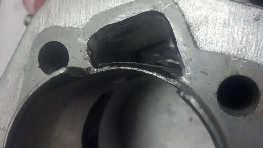

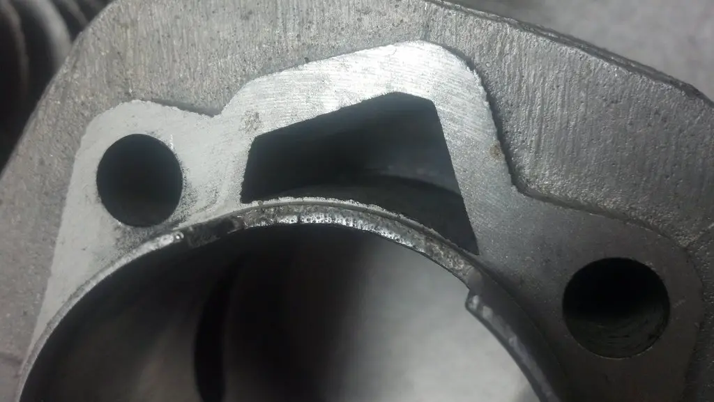

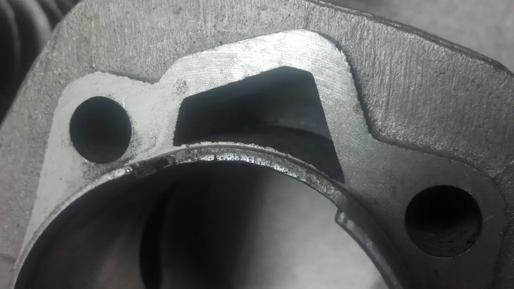

Alright so your going to wanna sharpen the wall on the T port sides of the base of the cyl. You can see the first pic on my junk cyl that the cyl wall is jagged and not smooth or arrow dynamically sharp.
With the base of the T ports ported as well with the case ported the same will gain a lot better flow and more.
I also have a pic of a weed eater engine cylinder to show that there isn't even wall in between the T ports.

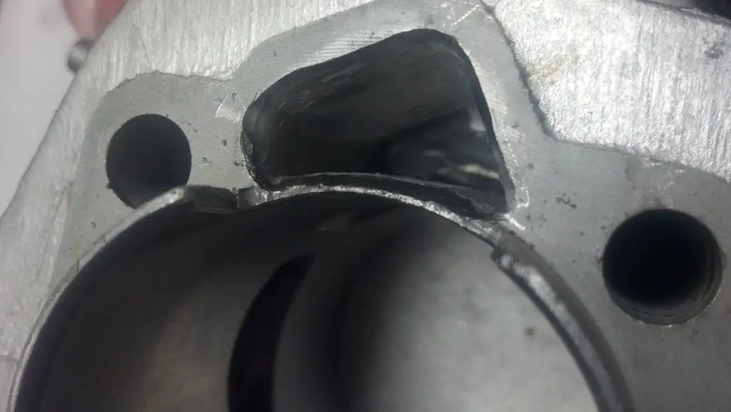

Wow, out of the box your transfers are better than mine. Mine point about 10-15 degrees toward the exhaust on the exhaust side (intake side is good though). Your corrected transfers are much larger and at a better angle now, I bet that thing screams compared to stock, especially with that giant exhaust port. I was actually considering removing the transfer walls in order to gain more flow but apparently the disturbance from the piston would just screw up the flow, not to mention the transfers arent completely uncovered anyway so it wouldnt do anything for me. What sort of intake are you using? You said you run a YZ80 pipe, but if you're using a stock carb/intake you could probably gain a ton with a larger carb, and even more top end with some arrow reeds and a boost port

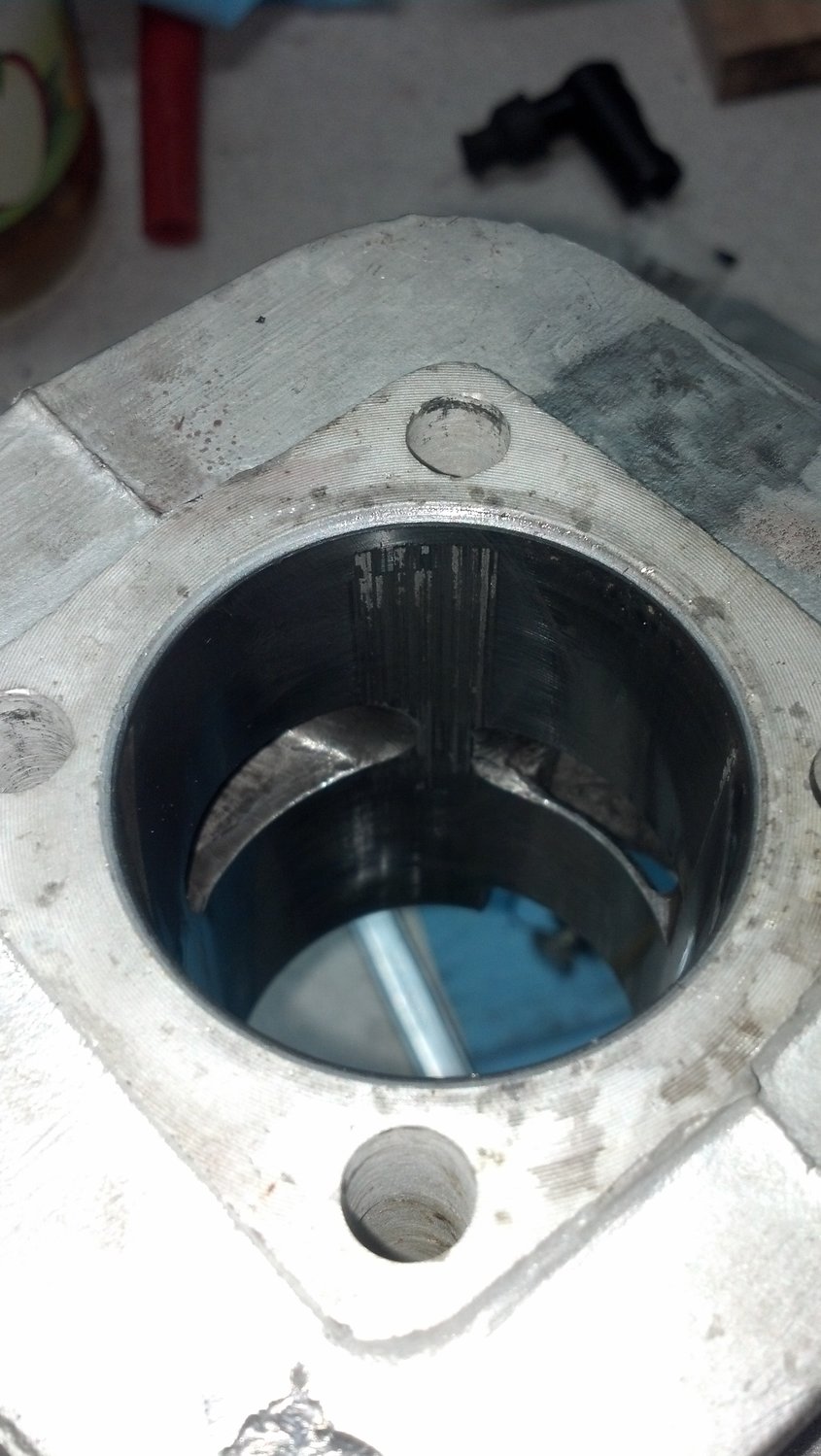

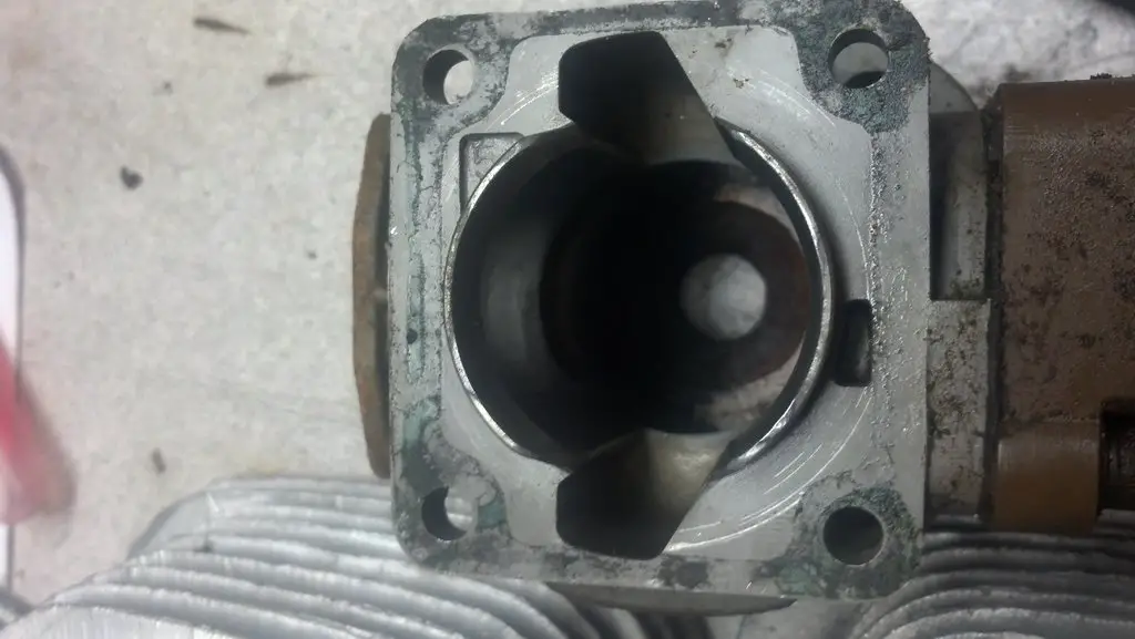

Unfortunately this is what happened when i first started it, about a minute of running it... cyl was well lubed so there was no dry start. I may have revved it too high too soon. My mistake so now i gotta get yet another cylinder and do it all over again! yay!
Is there no such thing as nikasil plating in china?

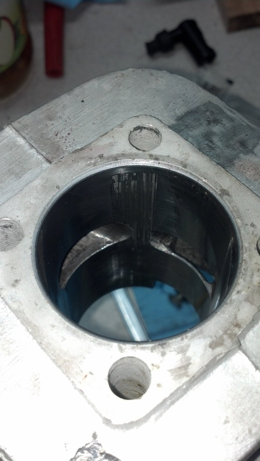

Ouch man, the rings are good though?? That looks like something snagged and got dragged along the cylinder. Maybe note the ring gap positions and see where they line up with the ports, perhaps they're different than ours (ours are designed so they dont run by any ports, maybe your exhaust port is too big?)
Then again it's hard to tell, my cylinder has markings similar to that, but they're mostly aesthetic. The motor doesnt run anymore?

The engine ran just fine! i shut it off and just pulled the head off for the **** of it and seen that! and nope all my ports where chamferd really well. Thats not the only spot it did that there are other spots 1/8 to a 1/4" wide. My other motor has a 95% better looking cyl than this one with 1 min and it only has 7 Hrs on it.
The piston ring gaps are located in the same spots on the piston as ours.
This shouldnt have happend even if i revved it a little more than i should have...
Just comes to show they are really thinly plated and you have to keep the R's 3g and under untill the wall has formed a glaze on it. It was not entirely my fault most had to with thin wall plating and i was anxious to hear it run!
Im going to try and get a replacement cyl from warranty with any luck but well see how that goes lol...
