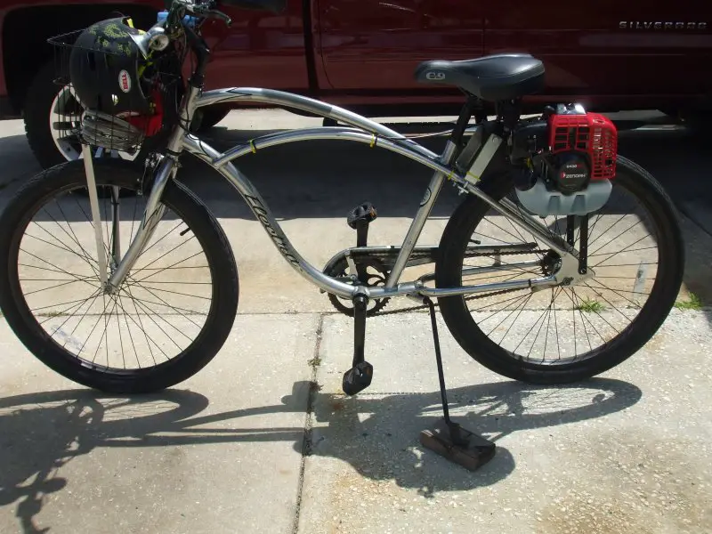

If building a in frame i would stick to steel frame. But if your are building a friction drive i like a alum. frame like my Electra.
