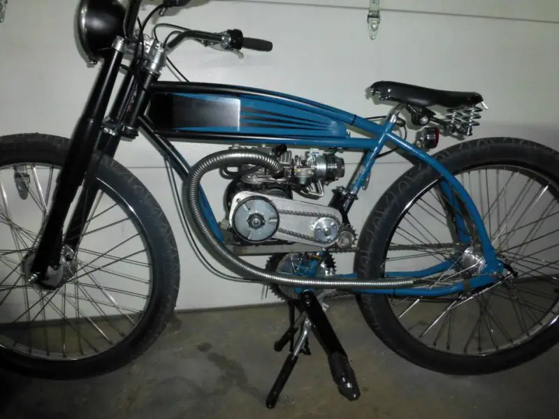

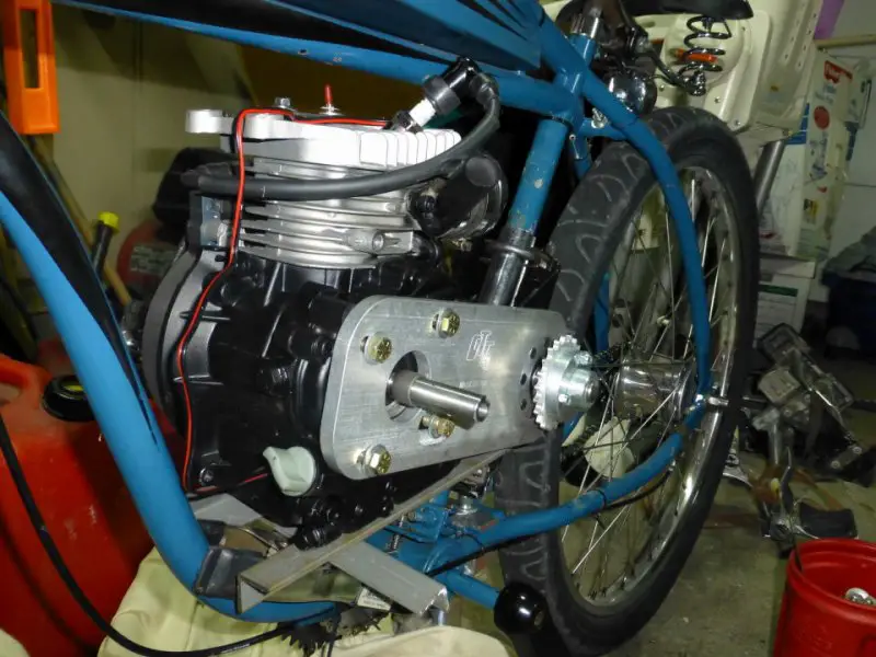

yes! Angle iron or bed frame and some muffler clamps.Maybe Check this pictures .. front and back will have a small section of angle iron bolted to them . Then drill holes for muffler clamps to attach to frame. Place clamp between frame and angle iron.Then connect rather U from to the clamp
