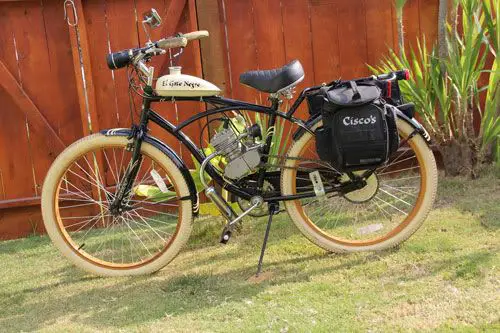

similar to this one, i suspect
Believe that bike belongs to a fellow on here by the name of Heycisco.

about the same cost as my cranbrook build though i went the extra 75 and bought a 36t sprocket and adapter.lots of people here put down huffy bikes i might have got lucky but had no real prob,bike shipped with bent rim called huffy and i had a new one in a week or so,they told me to keep old one,straightened it and had spare. good luck with yours.sold mine,customer hasnt come back complaining.
