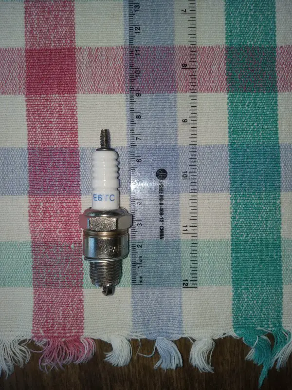

I'm getting rather exasperated with this bike and it's general refusal to run, and am trying to acquire a new spark plug. Should I contact the manufacturer to obtain a new plug under the warranty, or are they easy to find?
I've included a picture to help identify. There's no other information written on the plug besides the "E6TC" visible in the picture.
it’s probably not the plug. A fouled plug is not a worn plug.

Ngk BR6HS gap to .028 the kit plug is garbage.. the part # 3922

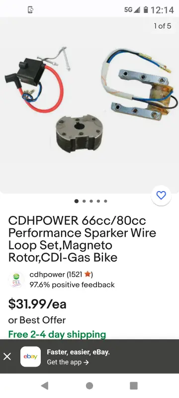

Should I get this CDI from a specific supplier or contact the manufacturer to receive an identical one under warranty?

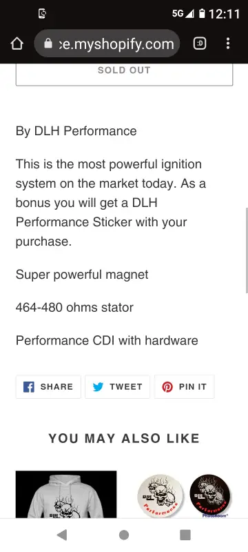

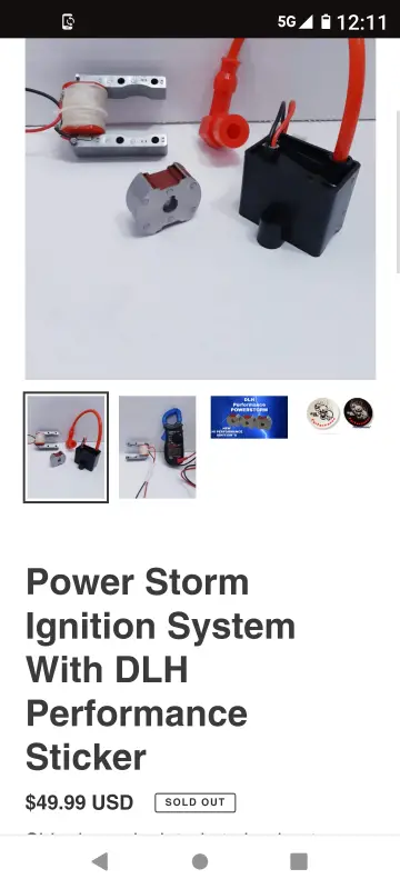

CDH power has a decent set or you can wait for the DLH best of the best to come back in stock...

Dude get any spark plug with the same thread length!!! I used iridium spark plugs and champion (lawnmower plugs) all day!
Bikeberry Super magneto

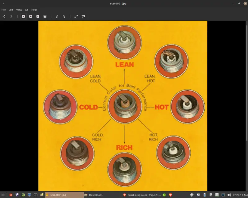

Reading the plug will get you to the proper plug... I sudgest a 6 but if you're in summer a 7 in ngk is a little colder the oil ratio and how rich or lean the air fuel ratio is and how you ride can effect it if you're putting around or full throttle effects it also.. the point is use the posts on here as a guide but it's going to be your specific engine and these other factors that will help you dial in the plug and jets that your eventually going to find work best... If you start out rich and cold you won't damage your engine and as it breaks in they will lean out a bit as it's making more power after the first few gallons...
