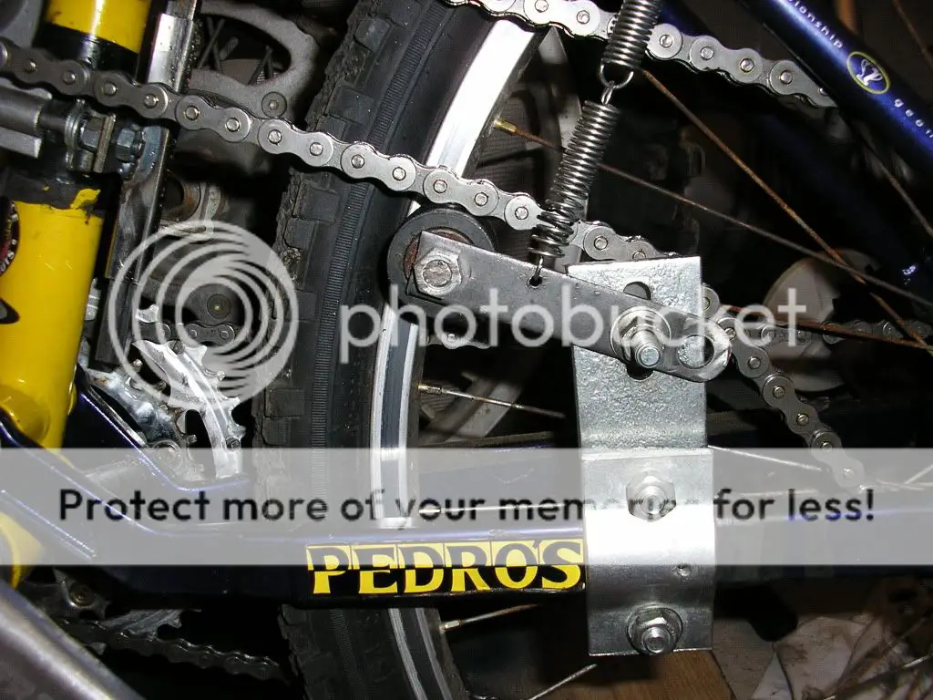

idea for a tesioner
rohan3ni
http://i999.photobucket.com/albums/af118/rohan3ni/IMG_6947.jpg
if everybody out there ave problems like i had with mines i found this fix. all i did was get a peice of metal from home depo.
Looks like a great idea to me. The spring would take up the slack on acceleration and decelleration as well.
It looks a little crude but...
Holy cow.
What did you do, use the whole length of the kit chain? Or is there something out of picture that forces the bottom of the chain to be that high?
You can get a little hand held screw type chain link breaker from Ace Hardware for $6.
Done properly you don't need a tensioner on either chain if it's not a frame issue, let alone your... ummm, creative solution ;-}
This will help.
http://motorbicycling.com/f3/chain-flop-18361.html#post177601
thats the chain i got. and i did take out some links out. if i try and make it shorter the master link wont able to connect. i took out as many as i could. and no frame issue. i dont see how its a crude way..... i think its pretty cool. lol this was the main problem when i got the kit. i did what alot of ppl told me and this idea worked.
yea but as a mechnic i kinda like it lol. its look big one it but its not really for show just something to do with extra time. i like that kind of work ya kno?

Creative that's what its all about!! I noticed in the photo it looks like your coaster brake arm is attached to the stock piece of metal?
Um.....it's mechanically good(except for what looks like the same stock wheel) but it looks like a tank. My wheel broke off on the first test run but I still had all the mounts. It looks as though your chain is at least two links too long too. That was my problem. Way too much tension on the roller. Here's my fix. New bolt and I just put three skateboard bearings on it. Used gorilla grip tape over the bearings so it isn't metal on metal. The tape actually got eaten up just enough to make grooves in it which acts almost as a tape sprocket. It gooed up into little spikes and now the chain doesn't even move. The metal bracket I bent was from before it kept jumping off but now it's perfect. And you can tighten the bolt ad much as possible with the bearings still able to spin because of the bearing spacers like the skateboard.

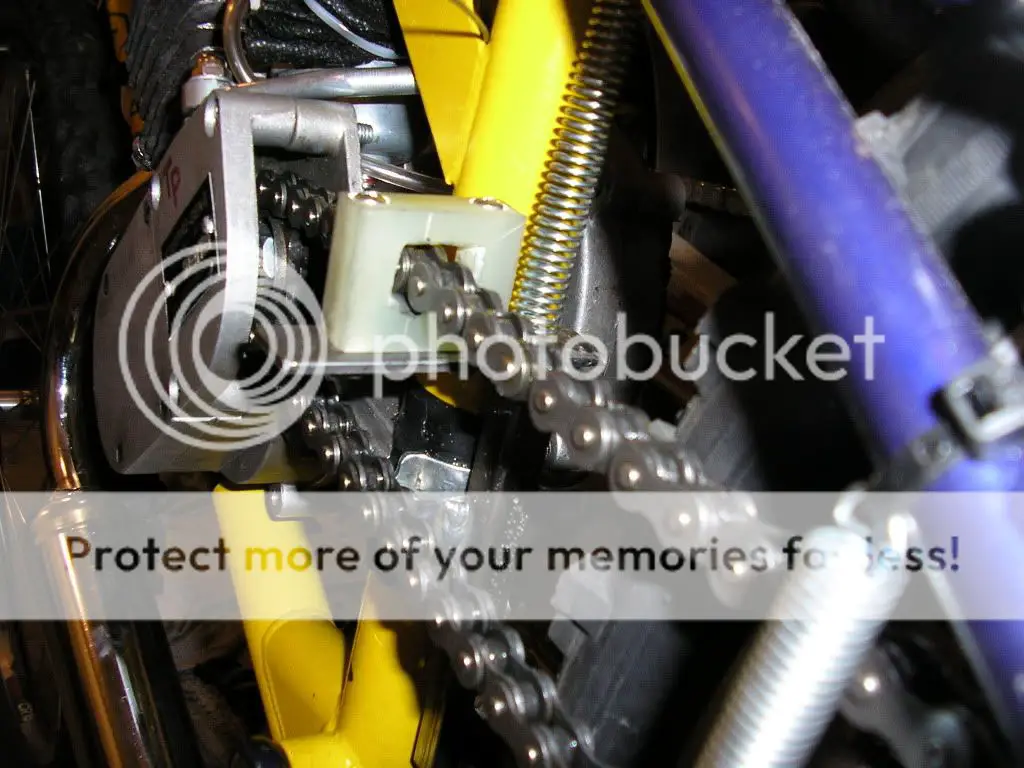

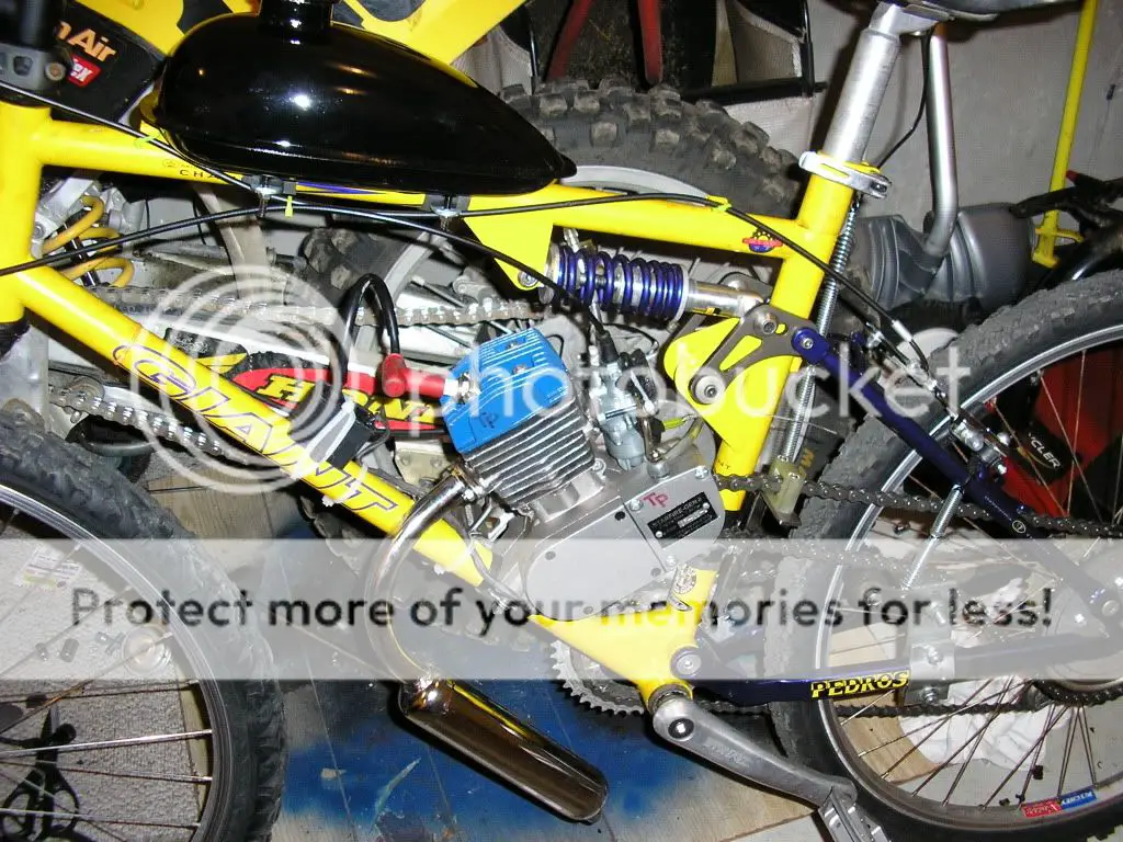

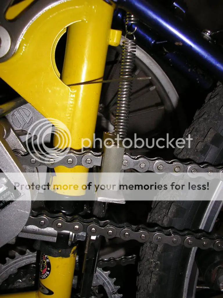

here is my full suspention setup the normal roller is replaced by a cr 80 thru 500 roller and the reason for the frt one is to take up the slack when the rear susp compresses as the pivot point of the swingarm isnt centered with the countershaft

clever boy....i'd only add that double nuts are in order, maybe w/ a split washer in between......you have accomplished a fix any farmer would be proud of...i like how you picked up the brake arm strap...so are their different quality tension rollers??? i'm amazed the chain doesn't just destroy the nylon roller that seems to be the same no matter the kit..... really nice fix. i do love clever fixes! charlie in baltimore.duh.
Damn!! That thing is MENTAL!!! bad time to try and put mine up cause u just came along and shut this **** down. Where did u get the rollers and the square guide?
thanks lol the roller is off a honda cr 80 thru 500 and the frt square i made everything except the modified oem chain tentioner and the square is a special epoxyboard from a friend he wont give anyone the specs on what it actually is i guess its top secret lol
pirate cycles and i are working on a quality chain tentioner no promises on a release all i can say is someday lol
yea i use bits here and there to make up the whole thing. the only thing i had to buy wat the 4ft metal.
