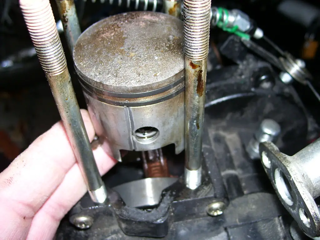

    Okay, here we go.... Laptop live in the garage today. :)
    In have pulled the head and jug, and the news isn't good. The lower piston ring was broken,and there's a large fragment unaccounted for.. it quite likely dropped into the crankcase, I see no sign of it around the work area.
    On top of that, the piston and cylinder are both pretty badly scored from the second ring down in a couple of places. Here's pics pf the piston:
    Intake @ right:
    [email protected] Bottom:
    [email protected] Top:
    [email protected] Left:
    Pics of the cylinder next post.

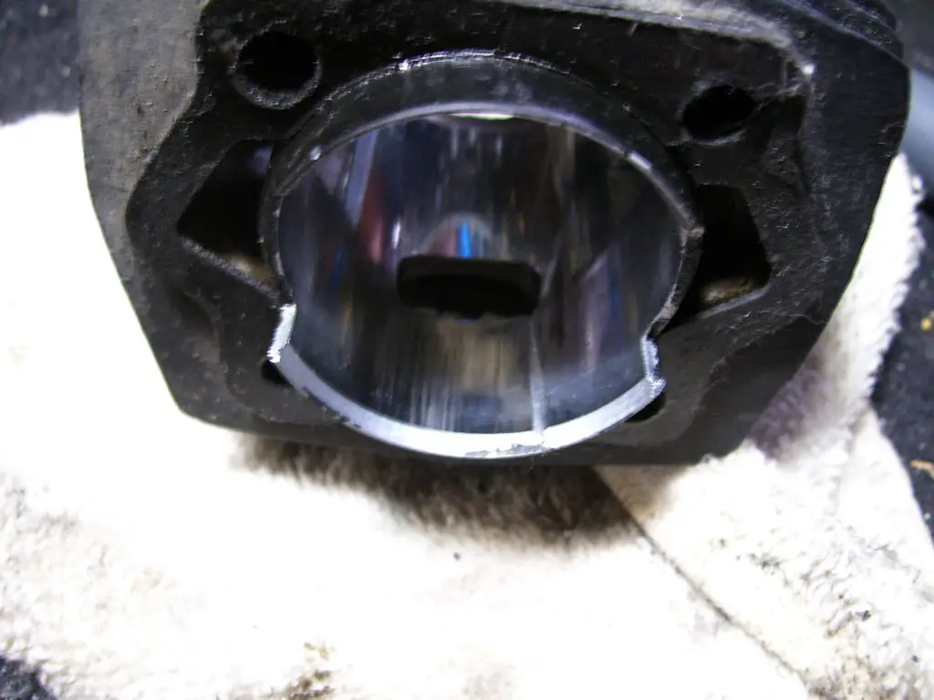

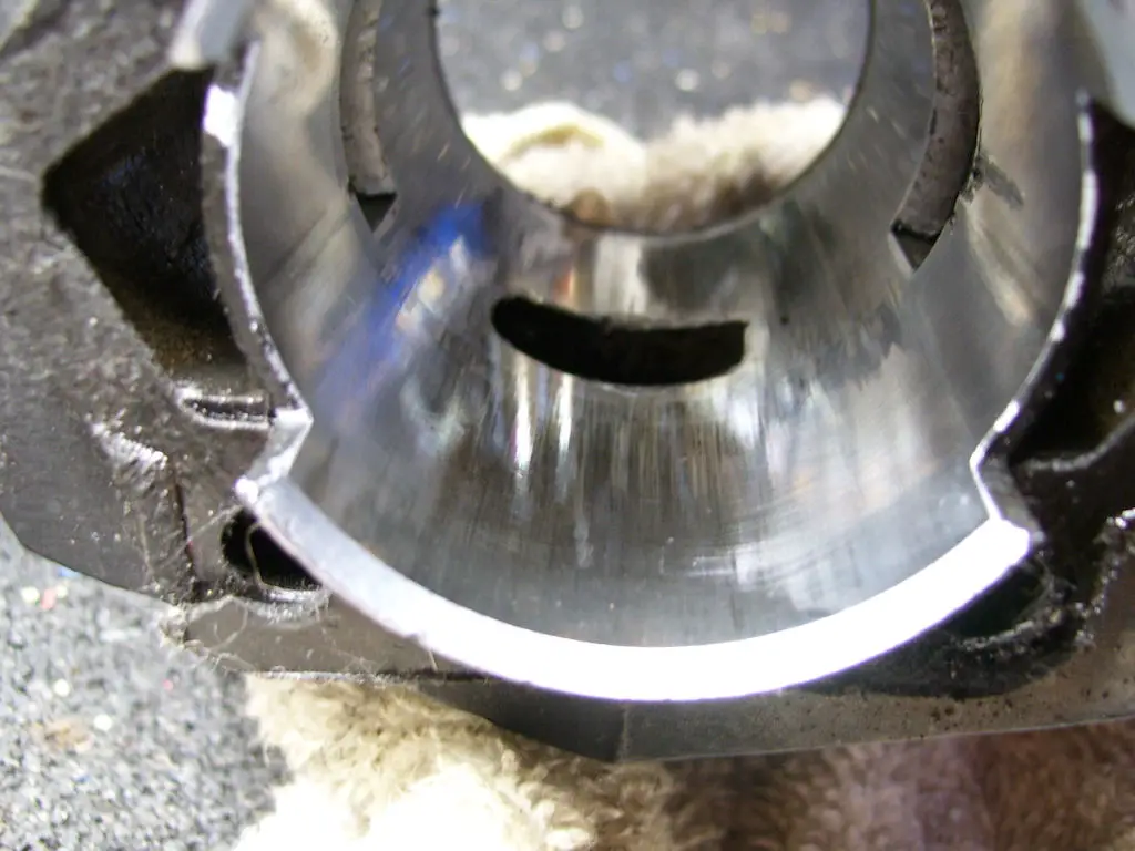

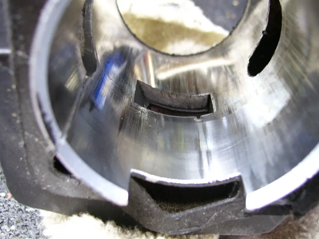

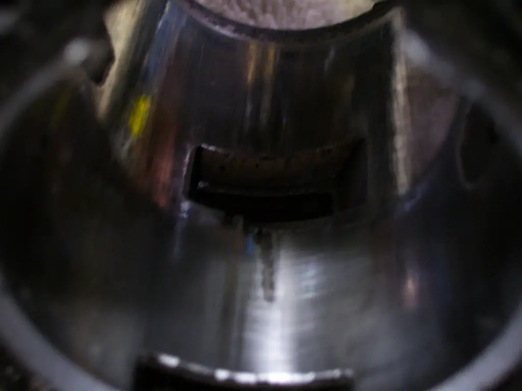

  5. CTripps
    CTripps Active Member
    Joined:
    Aug 22, 2011
    Messages:
    1,311
    Likes Received:
    Here we go.....
    These should be in the same order going around. Looking up from the bottom of the cylinder, since the upper half is nice and smooth.
    So What I'm seeing makes me think that I need to replace the cylinder, piston and rings. Or (more likely) swap motors and set this one aside for a full tear down.
    Your ideas are welcome, I would really like to have things running for the trip to work Monday but I suspect it might not work out that way.
