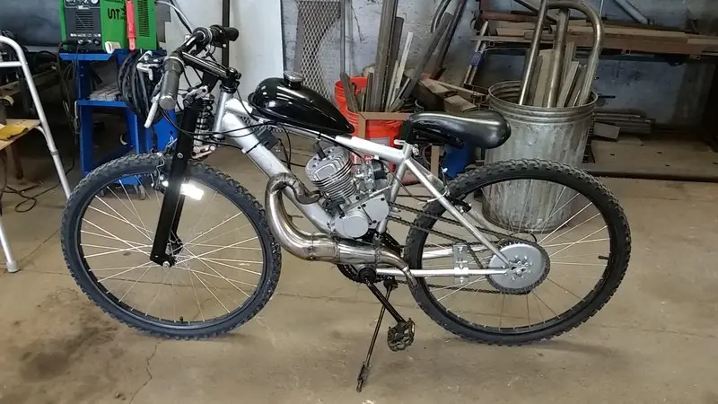

I don't have enough space to mount my carburetor between the engine and the frame
claytoncarpenter8
Sep 21, 2015
Tennessee
Is there any way I could extend the carburetor witha piece of pipe or anything to make it fit. The reason it does not fit is because I installed the universal U-Mount because my frame was too thick, and that raised the engine, making me unable to install the carb. I have the NTTC Carburetor from my kit.

You might be able to buy an offset intake tube.
I think I've seen people do that.
Other than that, it might be a cut turn and weld job.

Definitely post a pic... the last thing you want is to have to use an offset intake... especially if you like going fast...
Mine had clearance issues and I got mine to fit on with a shorty intake, i had to notch the air filter housing a little tho, but it all fit... barely...

One of the members here, Powertool, used a copper elbow from the plumbing section of a hardware store. Slice the end going over the intake, and secure it with a hose clamp. Or at least that's what it appears. I plan to try it myself, when I install a motor on my Roadmaster Granite Peak, which is the same make/model bike he built.
Like everyone else says post a pic!

Yup, that's ugly... but if the filter isn't restricted sometimes that's what needs to be done...
A shorty intake would solve that problem tho if you can find one, it would put the carb about 1" closer to the cylinder and about 1" lower as well. It will move the powerband up just a little but that could be a good thing depending on how you ride.

Yeah, I don't have a short intake, I was considering grinding some off on the bench grinder to make it fit better, but, meh, it's been this way for 100s of miles.

Tell me again how you don't have enough room....
Where there's a will. there's a way.

I've dealt with this before. I have purchased and built longer intakes but they do seem to rob power. Best thing that I found was the combination of a short "straight shot" intake and an all foam air filter

I have put on a Billet, "Big-Mouth" Intake Manifold on it since I wrote that and now it fits perfectly.

I'm not sure that is the right price, when I got it I paid about $15. I didn't really get much of a noticeable performance upgrade, although, more fuel can flow from the carb so maybe the throttle is more immediate and responsive, I've even flooded it a few times.

No, I just smashed it down with my hands, very slowly, so it wouldn't fall apart, it bends quite a bit. However, I have put a short intake on and I got a new filter that fits perfectly since I took that picture.
