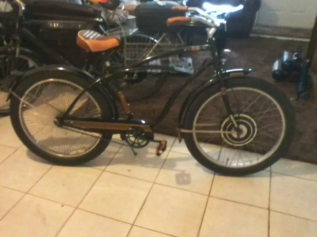

I got the bike today! Never thought I would say it but Huffy Rocks! The verdict is in, They rule. Well worth the money! Its a lot better than I expected. I added a suspension seat post. The stock wheels are really good, but, Since I have an extra 26" front wheel hub motor, 26" 144 spoke rear coaster brake wheel, and a pair of 26x3 Kenda flame tires, I put those on there too. That's it for now. Oh yeah, and I ordered one of these http://www.ebay.com/itm/251353471273?ssPageName=STRK:MEWNX:IT&_trksid=p3984.m1439.l2649 to be cont. http://motorbicycling.com/showthread.php?t=51537

By the way thats a nice looking e bike...
