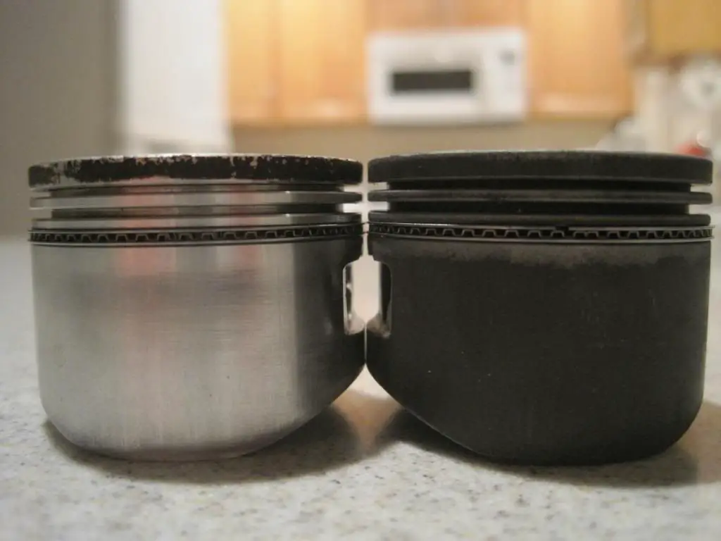

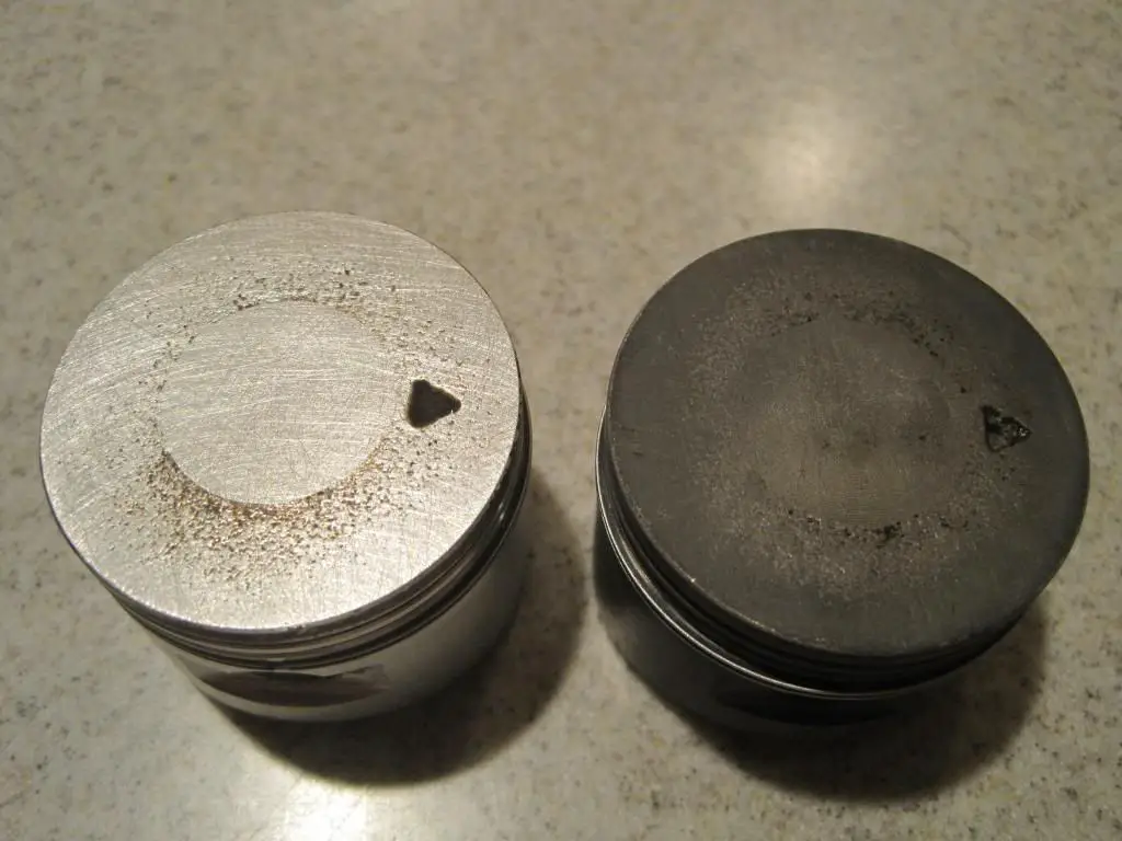

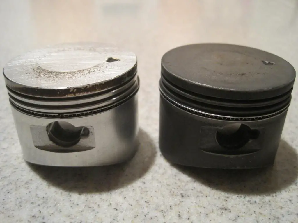

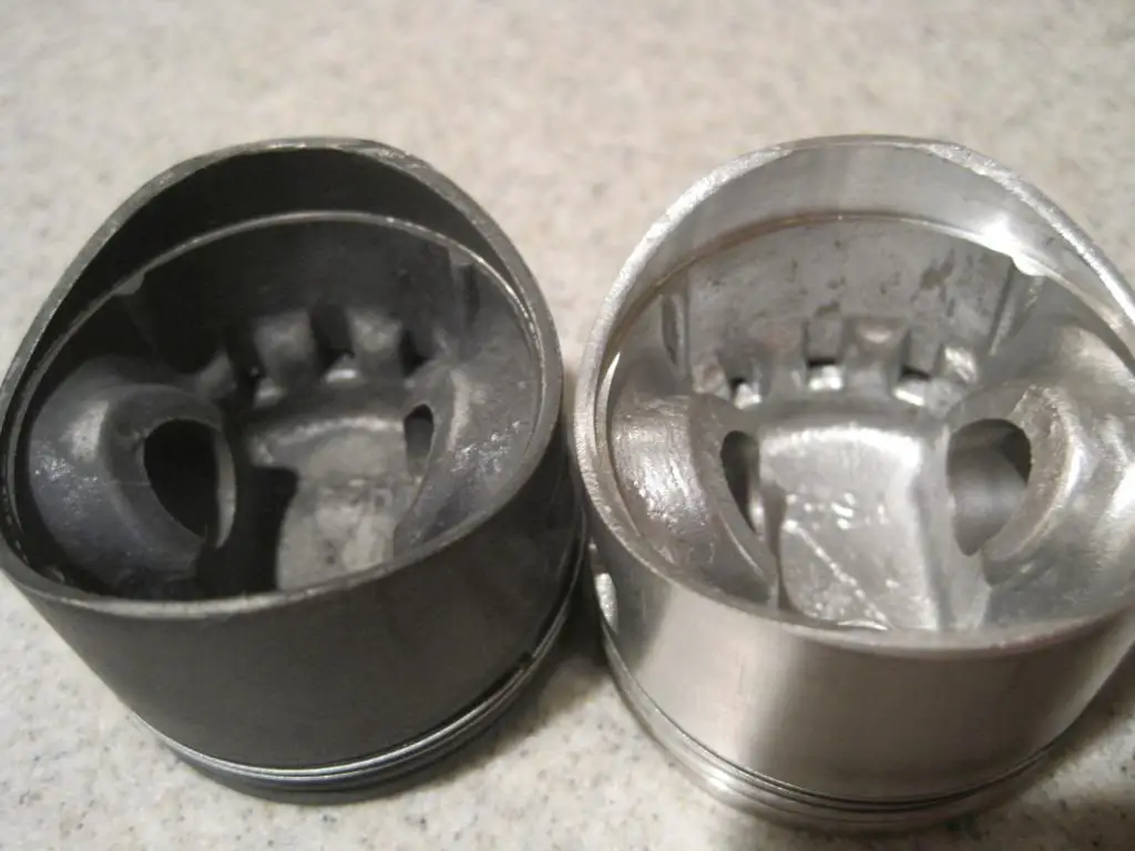

Well I took apart the engine Phantom Bikes gave me and everything is in perfect condition! I cleaned everything I am going to use in purple cleaner, the rinsed it all thouroly with water, then dried it all in my oven :D.
One odd thing that happened is the piston. I only put one piston in the purple cleaner, and this is the comparison to how it looked before and after. I have no idea if the structural integrity of the piston is compromised, or if this is just an aesthetic change. I would hate to use the piston only to have it cause problems. The texture of the surface did not change in any way though, so i don't know what to think. This color change always happens to the outside of the jug on all engines I have cleaned and if you rub the jug with your finger some dark material would smear off onto your finger. The odd thing is that this doesn't happen with the piston. Maybe you guys can figure this out.

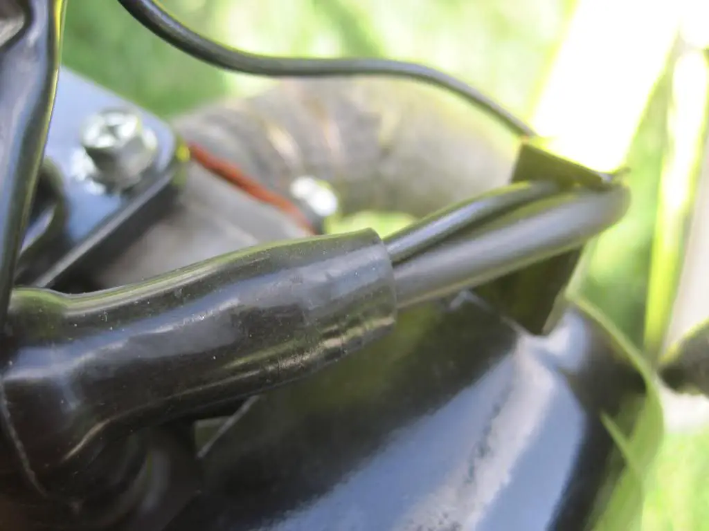

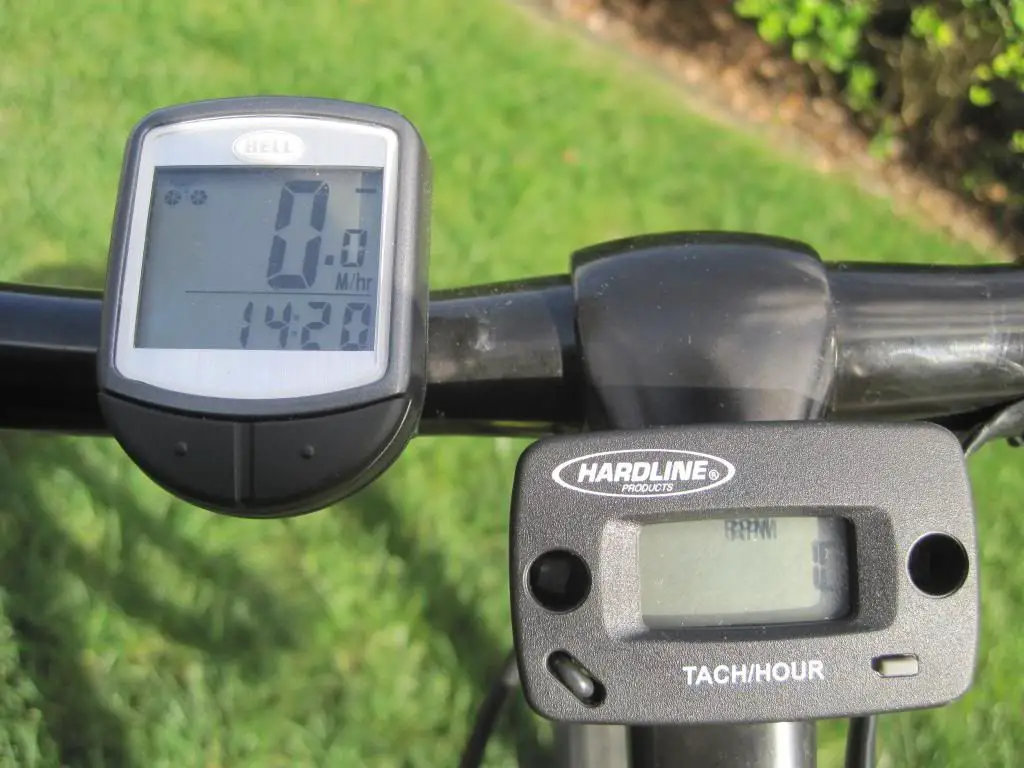

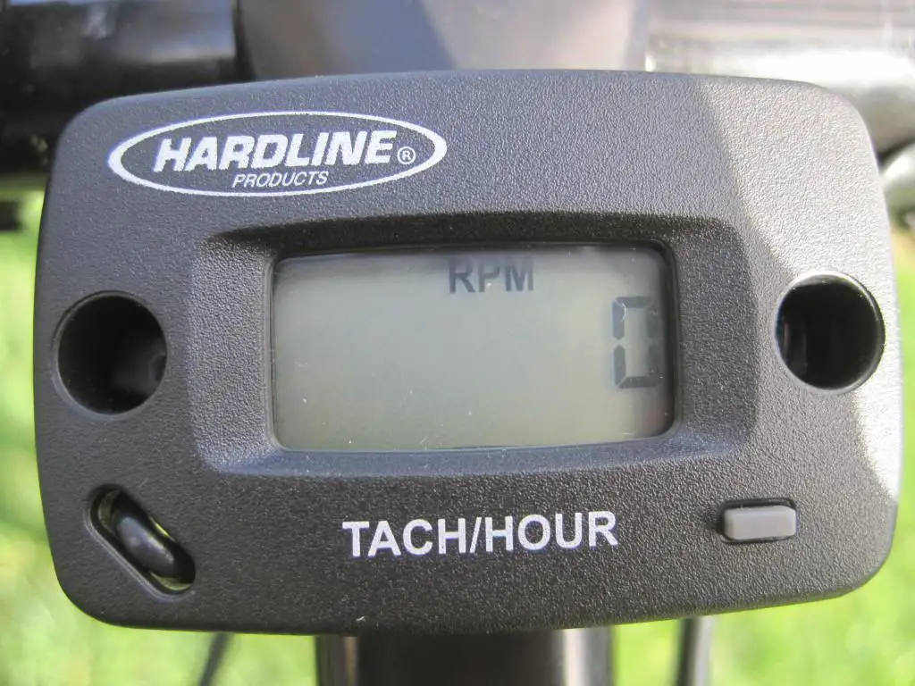

Alright, so I just finished putting my bike together (hopefully for the last time). I just got my new tachometer in the mail today (along with a Rubik's cube :D). Here are some pics of the tach on my bike. I tested it out on my dad's bike, and it works perfectly and has many hidden settings and functions that I have yet to learn.
The instructions tell you to wrap the wire around the plug wire a few times, but this looked very tacky, so I just shoved it under the boot and it seems to be picking up the signal fine.
