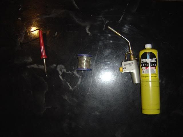

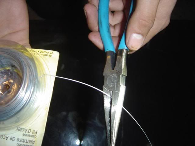

first off youre gonna need a small assortment of tools.
1. electrical pliers
2.gloves (optional but they protect your ands and let you pull tighter)
3. QUALITY 20 gauge steel wire (0.88mm)

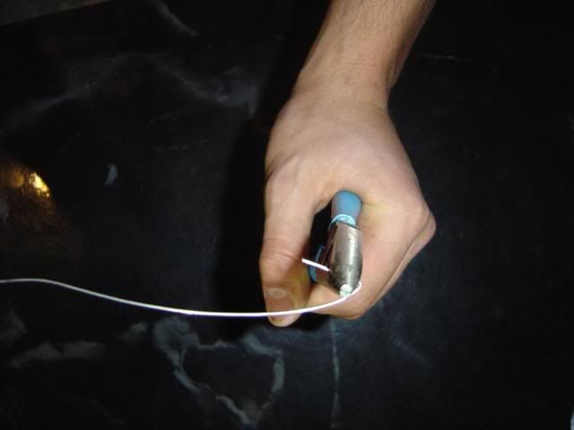

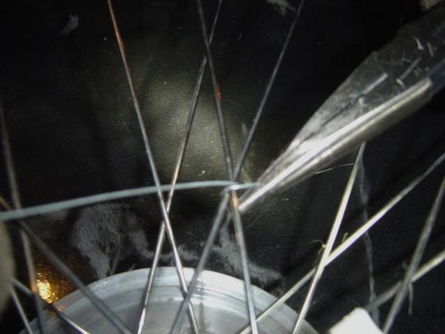

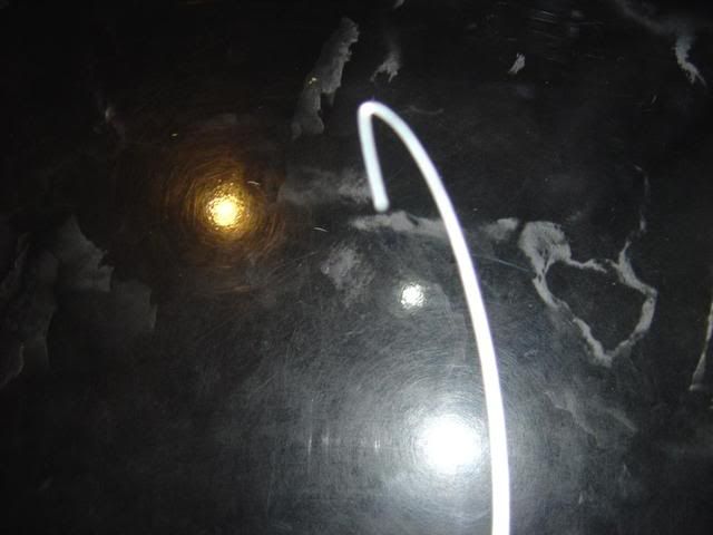

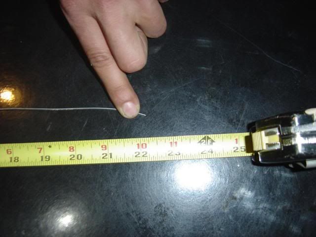

next is cutting the wire
1 pull out approximately 2ft of wire
2 cut with the electrical pliers
3 bend approximately 1 inch into a hook

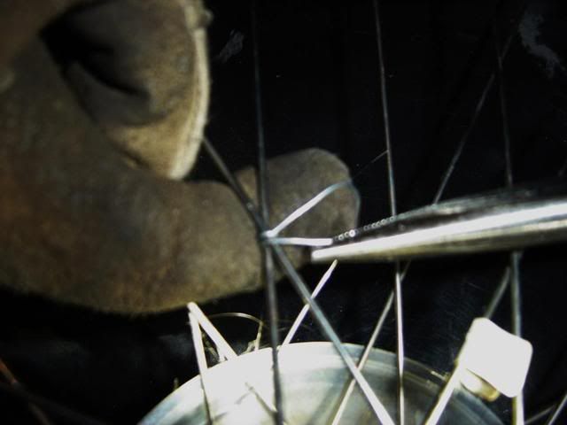

stating the tie
1 insert the hook where the spokes meet
2 pull both ends across each other
3 with your finger push the long end under the spokes
4 pull it through the other end and you have your first loop

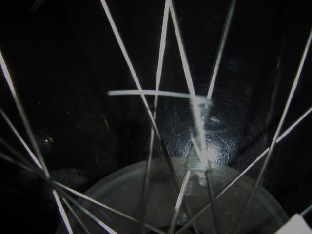

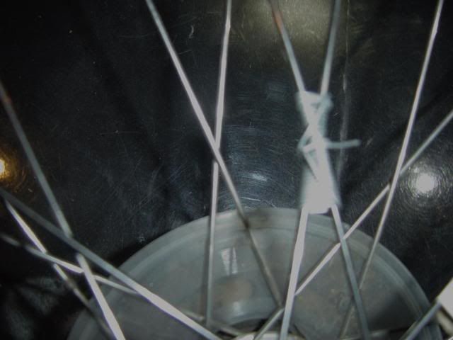

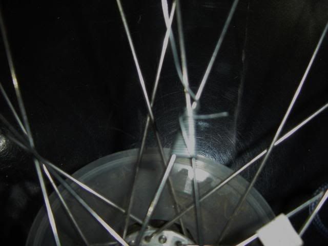

more on tying

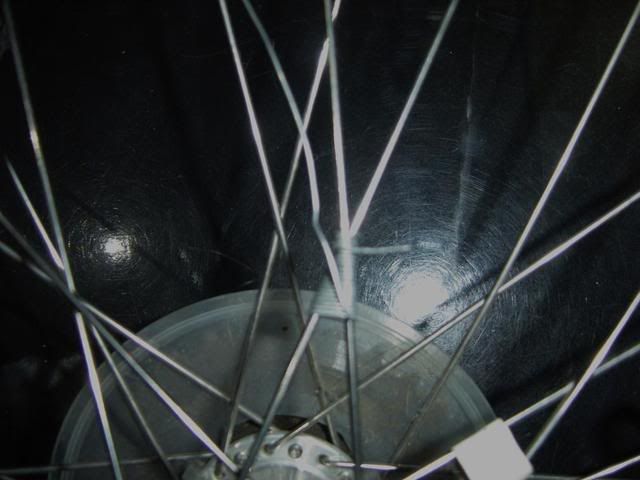

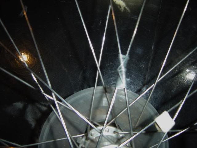

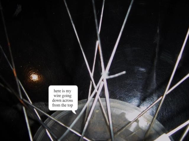

1 continue to make loops and pull them tight but not super tight because you will alter the point at which the spokes cross each other, we dont want that. once you have about 4 loops, cross the wire downwards (or upwards if you started tying down). the picture here is very blurry but its the best one I took.
2 once you cross push the wire under and continue to make loops until you only have about 8 inches left, these you can pull VERY tight (the tighter the better). then place the wire across again. it will look like this
3 push the wire under again and it will look like so
4 continue to make loops until you have about 1 inch left. again the tighter the better on these, and make sure they are next to each other with no gaps.

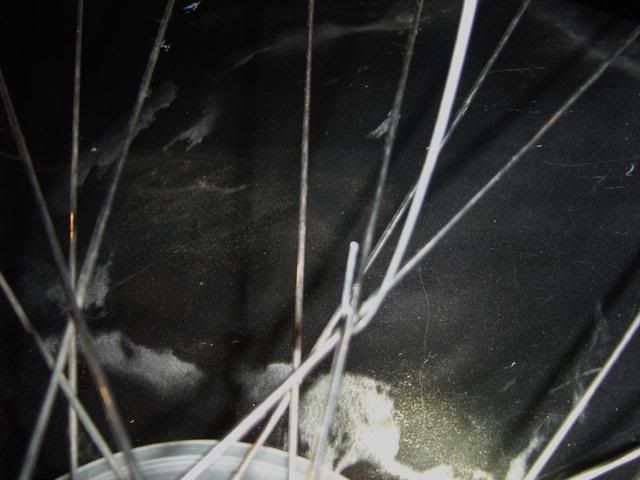

finishing the tie
1 pull whats left across and wrap around the middle
2 wrap the other end thats thats sticking out around the middle and were almost done
3 apply solder to the spoke ends or all over if you want. either with the soldering iron, or a torch if youre impatient
4 if you dont have these items then just use some jb weld. gorilla glue will do in a pinch.

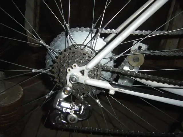

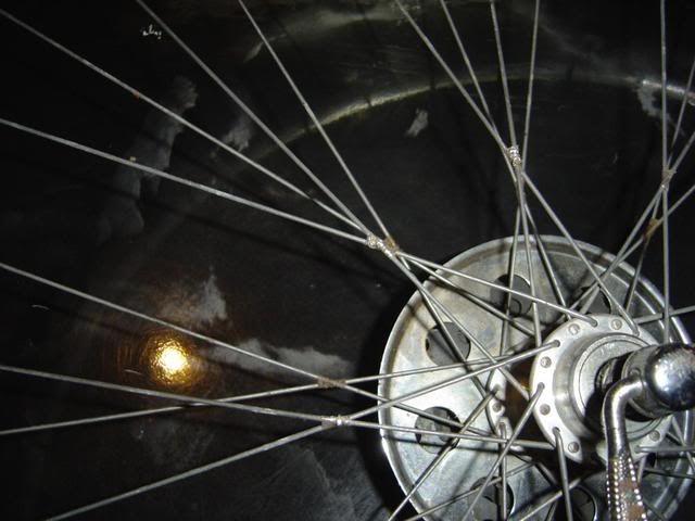

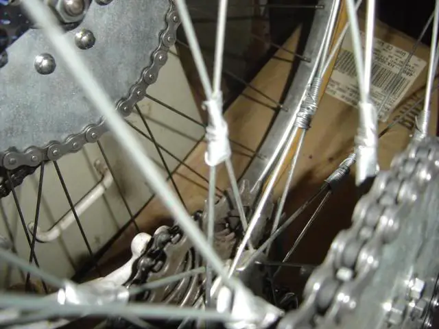

the finished product
top view
side view
just for kicks so that you can see the difference between a wheel spoke tied for normal use. this was using copper wire then soldered....a lot smaller he?
