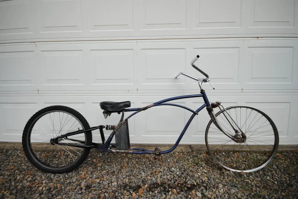

I recently started tinkering with custom bikes, and love the idea of a motor. My question is how much power will be enough? I would like to have non-pedal assisted starts and power to get up hills, but only really want a 25mph or so top speed. The stretch cruiser I'm building will be pretty heavy and I'm a fat guy, so figure 280-300 combined bike and rider. Is a cheap, simple build out of the question? by the time I purchase everything will I be better off buying a cheap small displacement street bike? I was thinking a briggs and a jackshaft is about as complicated as I would want to tackle. I know there is no way to get something street legal that will do what I want in Oregon with their 32cc limit.

A stock China girl motor should be able to pull you at 20 mph. You will have to pedal a bit from stops to reach cruising speed. If you live in a hilly area, a jackshaft/shift kit will help more than a larger motor.
Some of the rear friction motors like the Subaru are powerful and reliable but may not be suited to a damp climate.

That is a cool looking frame. Rear suspension can be a problem for a motorized bicycle. Someone with more knowledge than my one build will come along. Anyway you're off to a good start with that frame. Keep going and post pics.

Yea, awesome frame! Screamin for a Briggs, or a 99cc Predator. A spring loaded idler will take care or swingarm/chain or belt tension issues.
Are you gonna use pedals?
