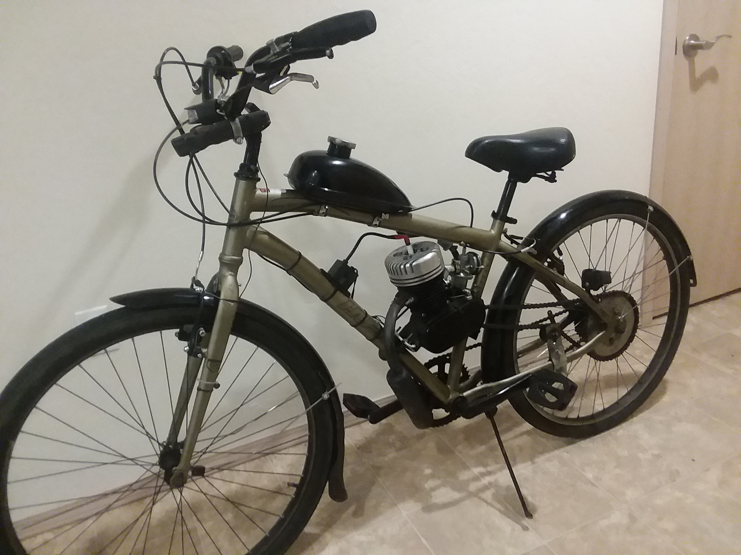

6 months started the bike project, since then have like 5000 miles so far I built my own engine mostly stock but some mods iron cylinder MZ pipe had the NT carb then the RT carb now run a 19mm Dellorto way better tune now, bike went 40 with RT carb but acceleration was poor took awhile to get speed and failed with a head wind to hold speed but the 19mm Dellorto is a power house just runs good as I buy carb parts for it. solid 40mph with a serious head wind maybe faster wind at my back? I use a 7cc head the high comp head will burn you out if you drive on the street, piston will fail some way or another from heat. 7cc head run wide open all day.[/QUOTE

So in your opinion could I benefit by reaping carbs to a dellorto or is that too much carb?
if you have an expansion chamber and the engine has a decent cylinder the 19mm will work very well. on a completely stock china girl wit only an expansion chamber? I have not tried that yet so do not really know. The cylinder I have now is ported but very limited due to the transfer ports being too difficult to modify in my case. the intake and exhaust were ported but the timing was untouched with the ports. so maybe if you have a decent stock PK80 it may take the crb just fine, I think it would be fine to tune with.
The tune on my bike is tailored to city use the MZ pipe is a mild pipe it works at all rpm pretty good makes real good low rpm power and mid range as well. My cylinder has lazy port timing so high rpm is limited but 40 mph at that rpm is good power. very happy with the performance of this china girl so far.

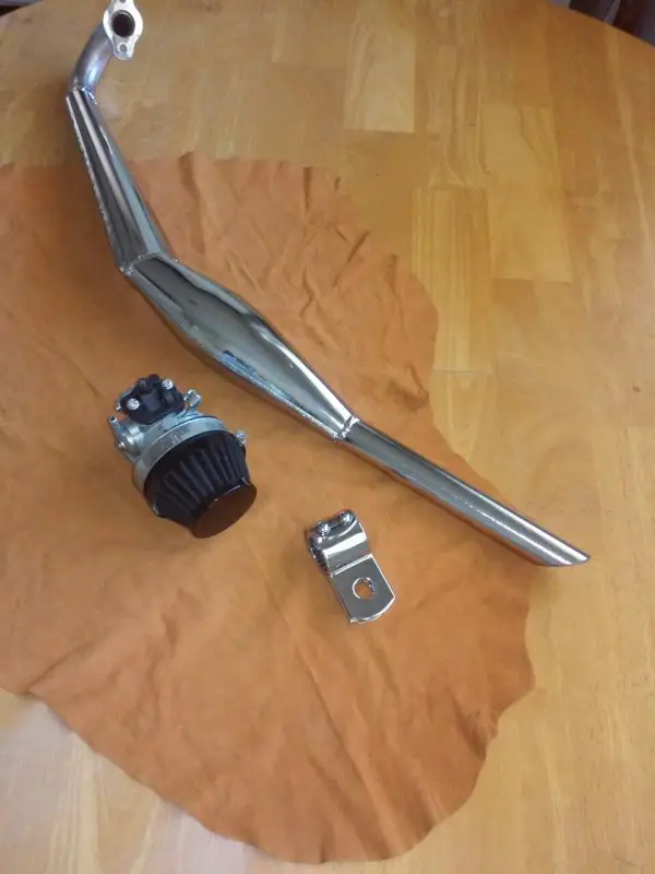

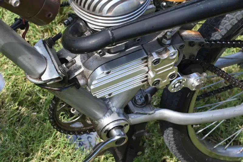

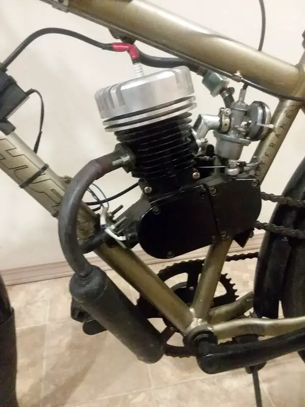

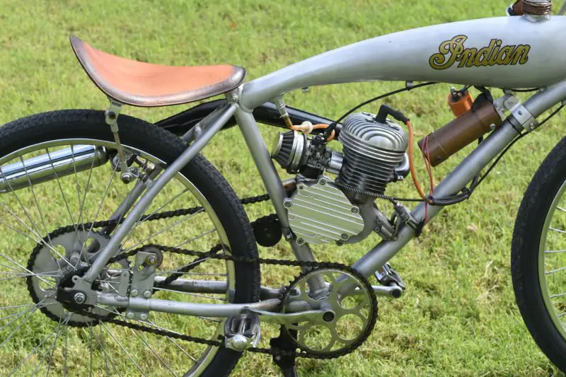

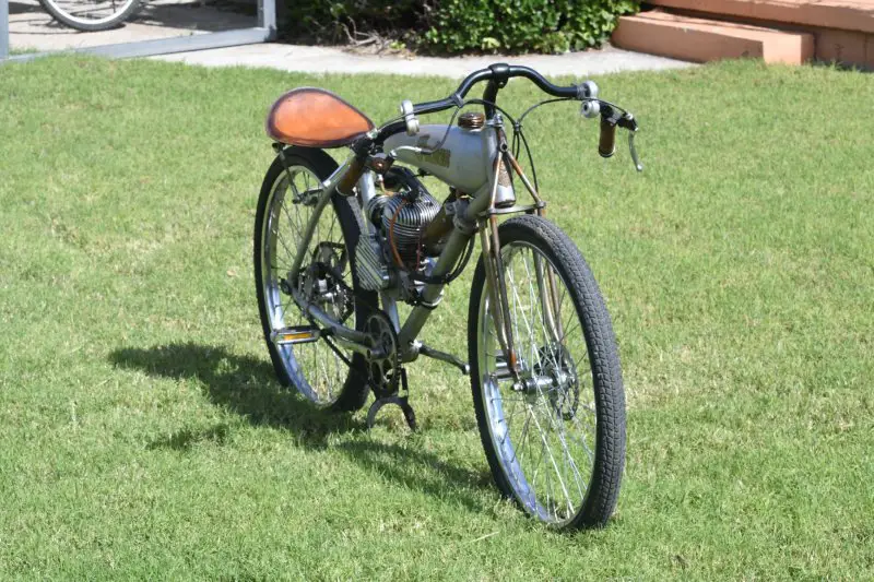

This is my Grubee frame, board track setup with what I'll call an economy expansion chamber and modified with a removable kit baffle...keeps the police cool & helps some with power band, but much better performance with baffle removed this cost about $70. The real motorcycle expansion chambers off 100cc or so competition dirt bikes are far better when fitted and tuned, they aren't just bolt on and must be modified to work on a China girl engine. Bike salvage cost from free to a few bucks...but some work involved.
This runs the Dellorto carb on a RSE reed valve with both jug and piston mods to take advantage of the reed valve setup. I'll send photos of the jug machine work and the piston window mod later.
p.s. don't mount a chain tensioner upright like shown on the pedal chain side of the photo above...180 degrees out of position! lol my bad.

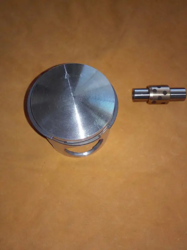

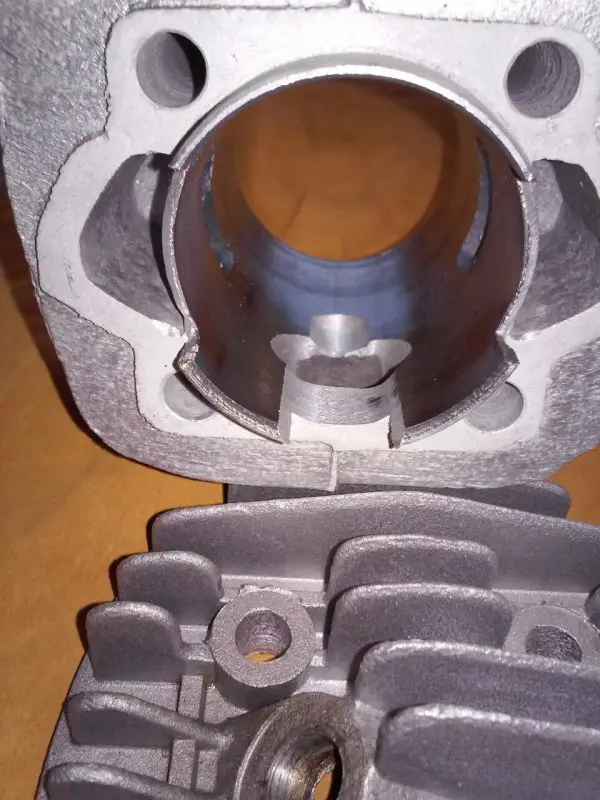

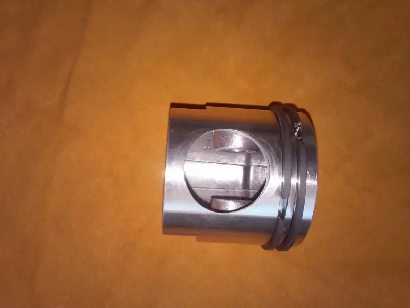

I think the photos will better explain the machine work needed to make the reed valve actually produce power. Big hole in the piston = "piston window" the photo of the inside of the jug = "third port"....using either or will produce power from the addition of a reed valve, but using both modifications produces the most.
The 19 mm Dellorto carb when jetted properly will flow more than enough air and fuel to run this setup and any expansion pipe you choose. I'm running higher than stock compression with the 7cc aluminum head...but nothing radical. Jetted down this same carb runs fine on a stock engine also. This one carb with a selection of jects has been on all three stages of tune from stock to highly modified street and ran great. Jet changes were the only mod to the carb. I've not found it necessary to alter the float level along the way either.

As the photos reveal the widow in the piston allows the cool and lubricating air/fuel mix to flow directly onto the wrist pin assembly & interior of the piston. The hole is close to 2" in diameter. I smooth out the intake port some especially if the reed clearance to jug wall seems tight the reeds should not contact the cylinder as they open. Also with the RSE reed valve I use, doesn't perform as well when adding a spacer between the reed body and cylinder. I donno' why? I've read that you can space the carb back from the reed body to use an angle adapter to run larger high capacity air filters and still clear the frame, but I've not tried it myself.
The expansion pipe shown, is quite inexpensive & works fairly well, but is available and is close to a bolt on with some frames, though rigging pipe hangers will require some thought and effort. Pretty easy compared to some pipes, but not real easy.
Machine work involved end mill, side mill, and ball mill tools on a real mill! ... & a lathe....not a Dremel moto tool!
