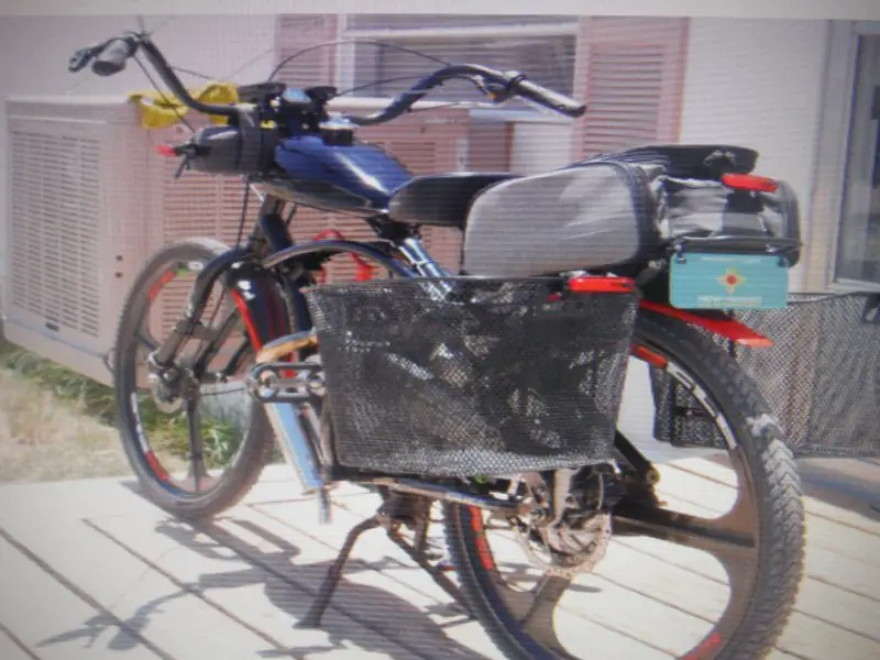

I got a magnet... You can get vanity imbossed plates and the wheaties cereal ones because in new Mexico it's concidered a bicycle... Light at night if you feel like it required...
You mean like the NM Plate Damien has go on his bike, Pretty sure it's required
You too can have a NM plate on your bike, That's if ya ever finish building your bike LOL

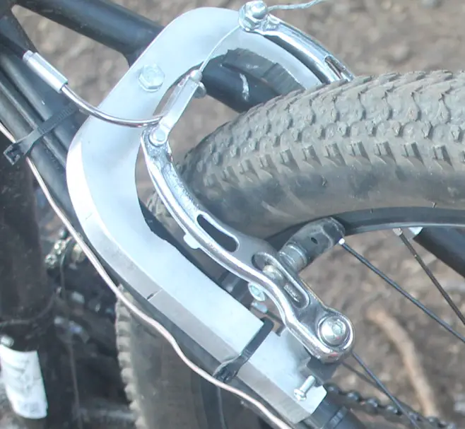

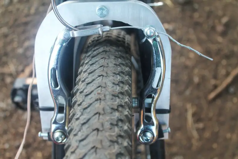

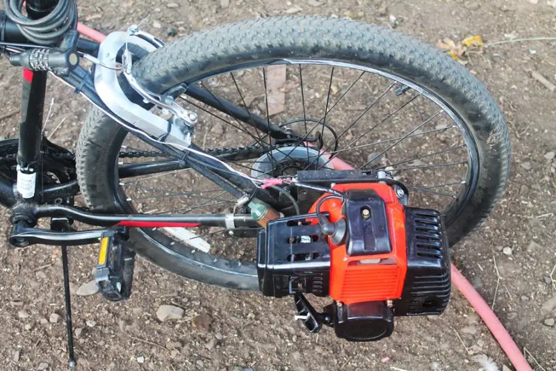

Here are some photos of my rear brake upgrade on my m-bike:
I could not use existing disc brake on rear with with disc brake in place, so replace it with a caliper brake. Braking performance was not adequate, so I decided to upgrade to cantilever brake type. I saw an adapter online, but it was $77, so decided to make the adapter. I had some scrap cutoff aluminum, 3/4" thick, so I sued it. I simply drew the design on the metal freehand and used my bandsaw to cut the piece, then drilled and tapped the holes for the bosses. Temporarily I am using zip ties to hold bottom fingers onto frame, but will make something more solid soon.
Braking power is extraordinarily good. I can lock up the wheel if I want to. Thousand times better than caliper brakes, and as good performance as disc brake.
View attachment 111443View attachment 111444View attachment 111445
