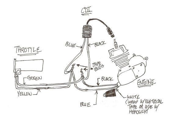

erm.... do u have the clutch connected yet? Can you hear the engine turning over? Do you have the petcock (fuel switch) in the open position? Are u SURE all ur wiring is connected properly? If all of these are yes then try to disconnect the kill switch as many are bad from the factory. I highly doubt that the magnet is not turning b/c that would mean u sheared a key and seeing that u havent run the motor yet i dont see haw that could happen. Below is a diagram of proper wring. Hope this helps Moto.
