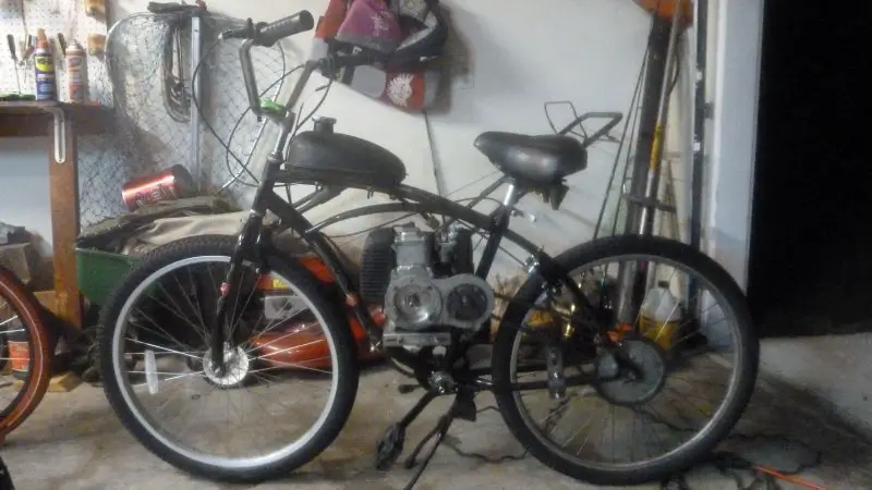

This is the new build. Chain hits the rear fender, not sure whether to cut a notch in it or just leave it off the bike. It's kind of flimsy. Sorry it's wildly humid right now so the pic isn't that great.

Oh **** the front fork is backwards. LOL. Must have spun around when I took off the handle bars.

I'd also remove that front fender........several members have endured extensive injuries from those broken front fender mounts.
Best of luck in your future adventures!!

With it backwards, does have a utilitarian sorta look, LoL. Almost with a European, economy, city design.
Would mess ya up at speed. Great turning at low speeds though.

Forgot to mention, CRP. Great looking build! Put a layback seat post and would have a bobber look. Really good looking comfortable ride.
Again, Purty work!
