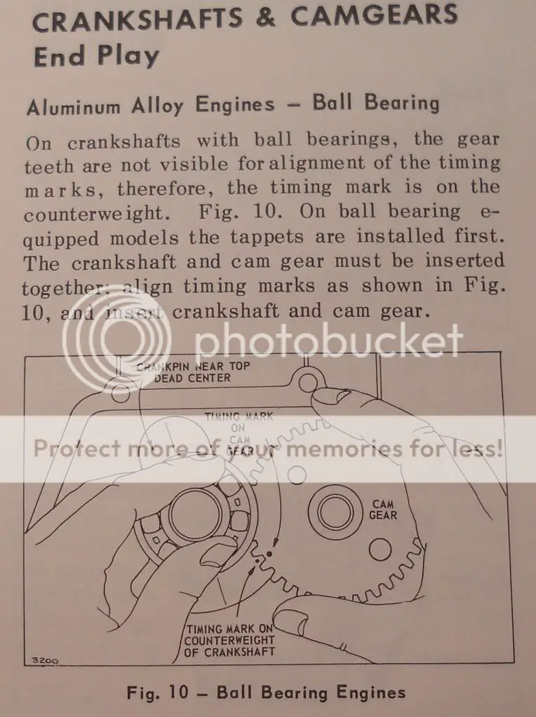

no i don't have the ball bearing. i have solved the problem with the cam timing
it is something whit the cam gear knocks. i took a cam gear from an other briggs engine lined up the two dots and the timing was as it should right away, so that problem is solved:) but thank you anyway.
