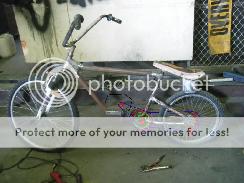

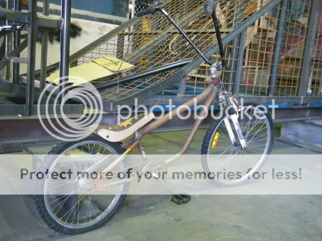

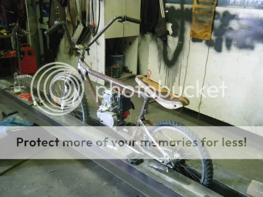

homebrew chopper on the cheap
bmx frame rear end, and a huffy welded together pretty
much sums it up. i got a old haro i had lying around and
chopped the seat post off the the back part the wheel attaches
to,and had it welded on upside down.so the v,brakes are pointing
at the floor,and the seat post is angled back. i was going to have
stupid long forks,bt was talked out of it. this is only a first build.
the frame tubes connecting the huffy to the haro are old exhaust tubing.
already had the bends in the right places and is quite strong.
the handle bars are the stock haro bars chopped with a straight
mountain bike bar cut in half and sleeved on each side. i will
get straps welded to the un sleeved ends.
i need to move the top bar about 10mm up to make room for the motor.
the length might need some extending too,not sure yet.
we welded it up just off the top of my head,as we went.not the best thing to
do if your paying someone by the hour to help you. any way we got it together so i
could see what needed to be done.to be honest im surprised at what we made,
even though its far from done.a crank will have to put higher in the frame to make
it more comfortable to pedal,but the chain wont clear a motor hanging out. the motor
i am using will be a huasheng 49cc i bought last week,should be here this week or next.
until then i dont think anymore welding will be done.
the pedals will just be there to keep the cops off my back,and i plan on using a shift kit,
so i might just leave the pedals where they are and just use shorter crank arms to get it
up off the ground some,i don't really plan on pedaling this one. i have my mountain bike 2 stroke
for work, this will be for summer weekends for fun. i plan on having a loud exhaust
on this :). if i keep the pedals where they are, i can mount pegs up front of the motor
for my feet.believe it or not we tacked the seat on and rode it,just for a laugh with
flat tyres.your knees are high but its doable,kind of. the seat wont be quite that low, and
i shouldn't have to pedal really anyway. i need to organize some sort of sissy bar for it
too, my mate donated the seat from an old dragster.
so, i cant really do too much till the motor arrives,but im pretty amped about this.
in the end i hope to have it matt black,with hopefully a slightly fatter rear tyre,
skinnier front tyre and if im really lucky a disc brake on the front. im going to take my
time with this one and get it semi right.its not a proper chopper,but im sure i will be smiling
riding it down the street.thats what its all about imho.
if anyone has any comments or input they are appreciated.
cheers.

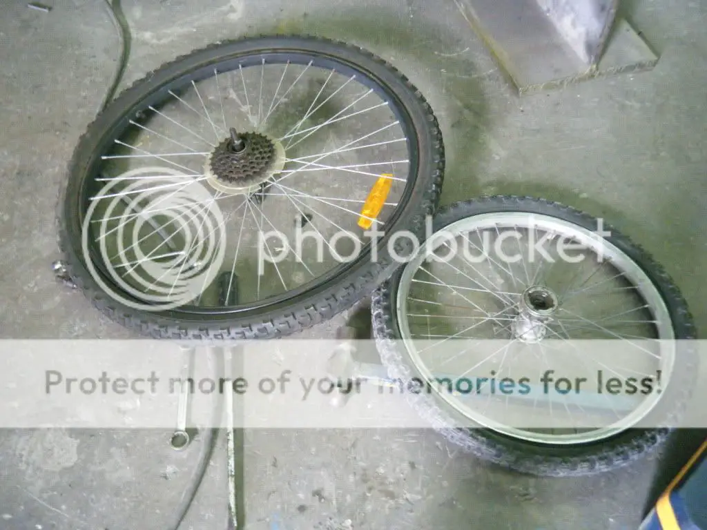

i dont have access to the bike that much but heres some pics i took.
should be good auflg

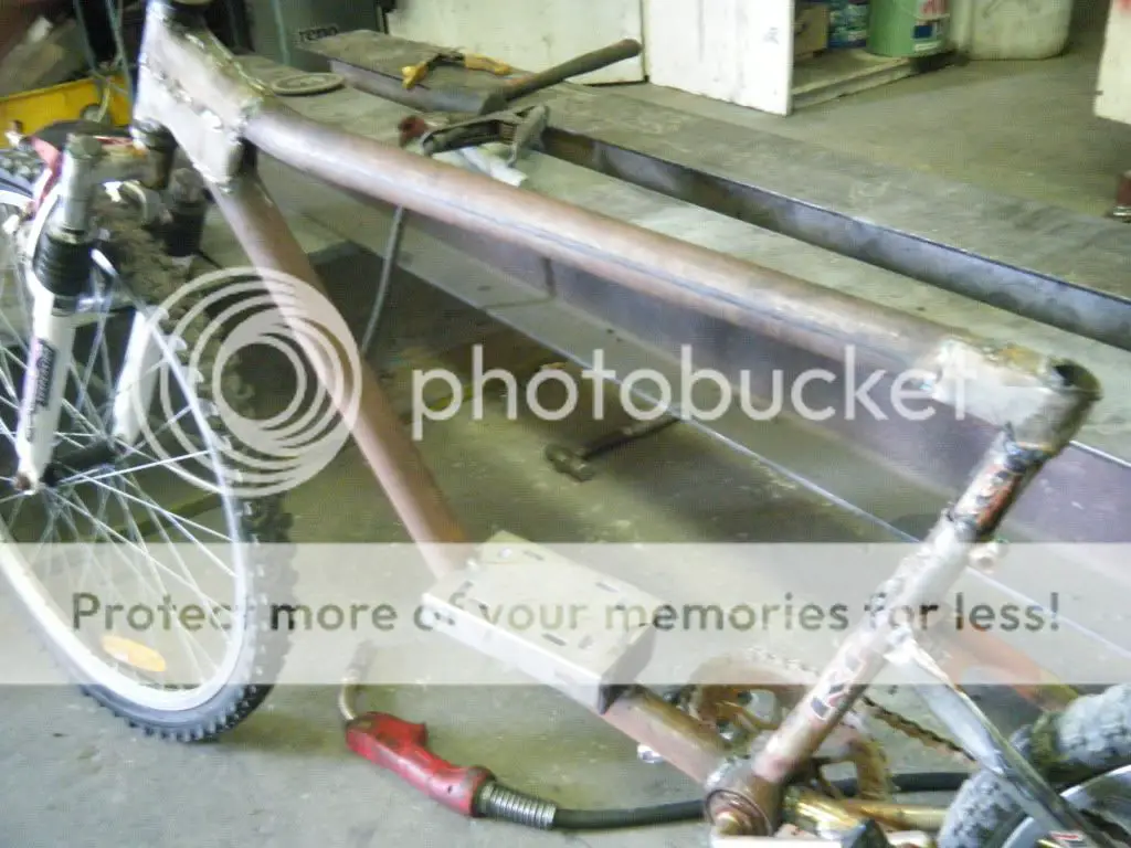

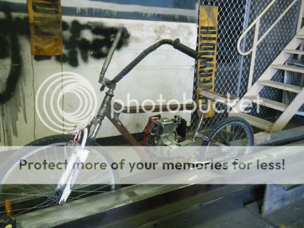

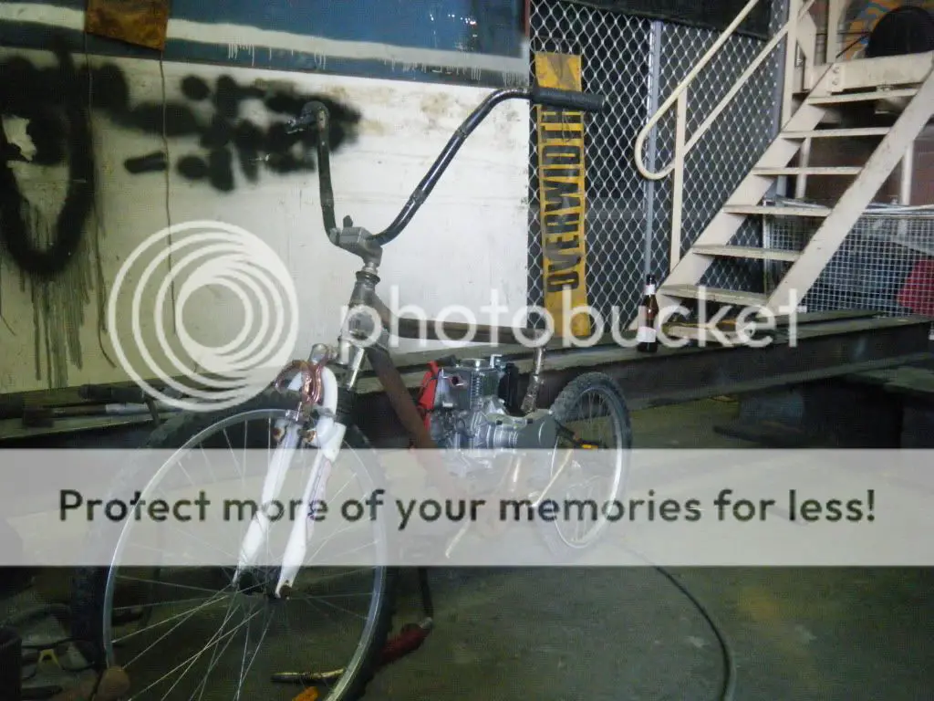

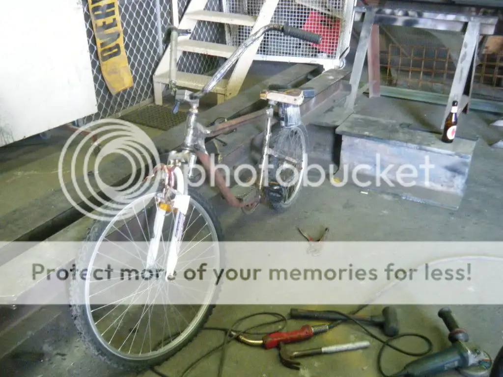

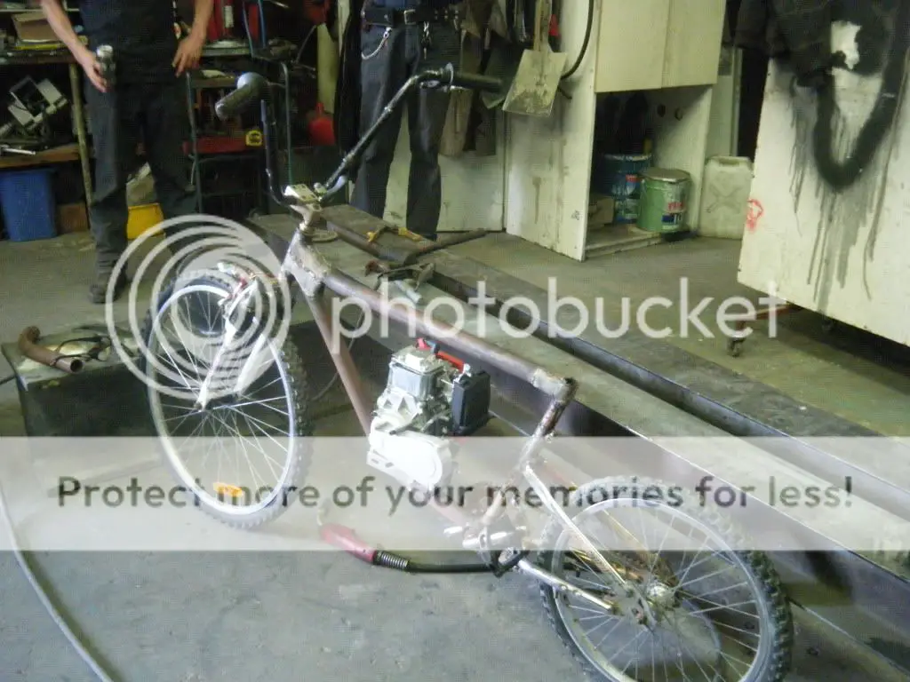

i got the motor about 3 days ago but havnt had the time to do much until
today. we raised the top bar top fit the motor,braced most of the frame
and tacked the engine mount in. the frame doesnt flow as good but when the
seat and sissy bar are fitted it should be sweet. i was advised to shorten the handle
bars some, which is a good idea looks quite good. i plan on having the pegs
just infront of the motor,to the bottom. so my legs sort of hug the motor,
my radical idea at the start has been altered for some drivability. its going
to be a pig as it is now, im glad i shortened the handle bars and didnt lengthen the frame any.
if anyone has any experience as far as "rake" goes, and the steering feel free
to chime in.
i havnt been able to pump up the tires yet to see how it rides,but i think she'll
be right. i have seen a stingray in the local paper for $400 bucks.:drool:
4 inch back tire. i know there are loads of them on the forum i often look
at them and just wish i had it.if i had the money i would buy that stingray,
and do that.
anyway heres some photo's. :)
not sure on the frames shape, but meh.

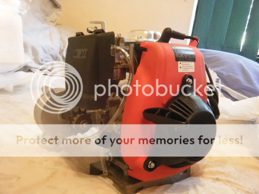

the motor-
modified frame-

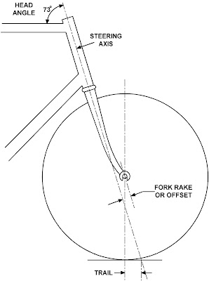

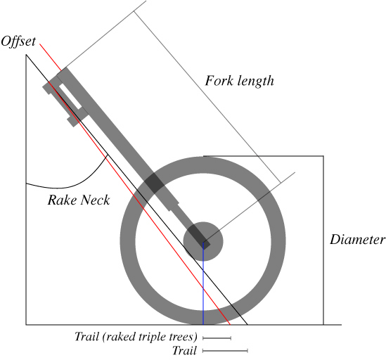

to chime in.
Do you know how o measure rake and trail? I can find a diagram if need be, what you need to try and aim for in between 2-4 inches of trail regardless of rake, any more and you will have very "slow heavy" steering that is very stable at speed but lower speed riding is more difficult, any less trail the steering will be twitchy/ over 'responsive' and can be 'nervous' at high speed, there is a happy medium between the two which by most accounts is between 2-4 inches of trail, where between this will depend on what the bike is and what you will use it for, downhill mtbs have less trail so they have nimble and fast acting steering while your average stretched out cruiser type bicycle has more trail for more relaxed stable riding. . I run ~2-3in on my cruiser and it is just right for my riding abilities and the bike is ultra stable at 45mph. If you don't get enough trail with a large rake you get what is called 'flop' this literally means when you release the handle bars they won't stay centered but flop to one side, this is not good for safety nor handling on road going bikes. Lemme know if you want a easy to follow diagram to workout rake and trail anywayz...i don't think i need to tell you how important this is to get right, it will make or break your bike...and/or your body if you get it hugely wrong :-)
best of luck buddy
KiM
best of luck buddy
KiM

No worries at all, heres a couple of diagrams that will help you understand and measure the rake and trail.
Most commonly dropouts on the lower fork leg are used to get the correct trail, but not always, forks can als be offset at the head to gain the correct trail required, can be seen in this below diagram.
The forks on your bike have an offset at the head rather than extended dropouts, alot BMX & MTB bike forks are like this., looking at the pics it looks like not quite enough for me but i could be wrong i often
am LoL..
Hope this clears things up, its not super difficult once you know what your looking at.
HAHA and yes, once you have a welder and an angle grinder the mind starts to create all sorts of things dont it haha ..best of luck, with lil practice you will soon be making bikes of your dreams...
KiM
thanks again. i still dont quite understand it but at least
i can measure it when i see the bike next.

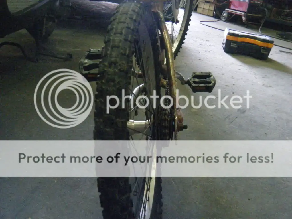

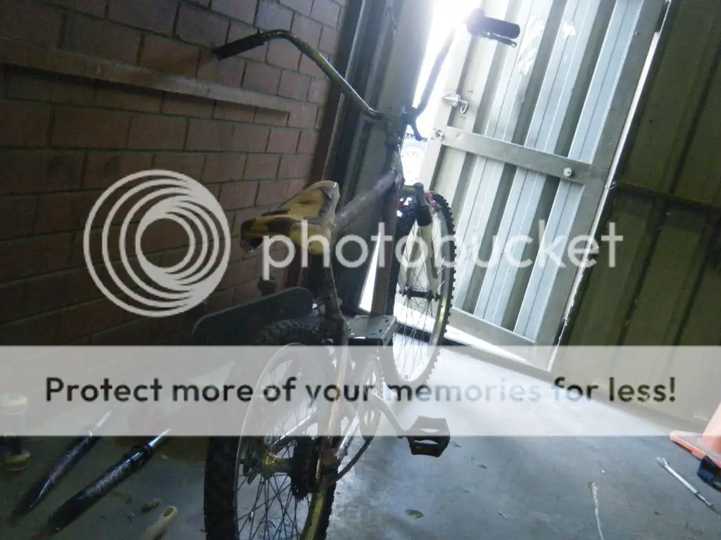

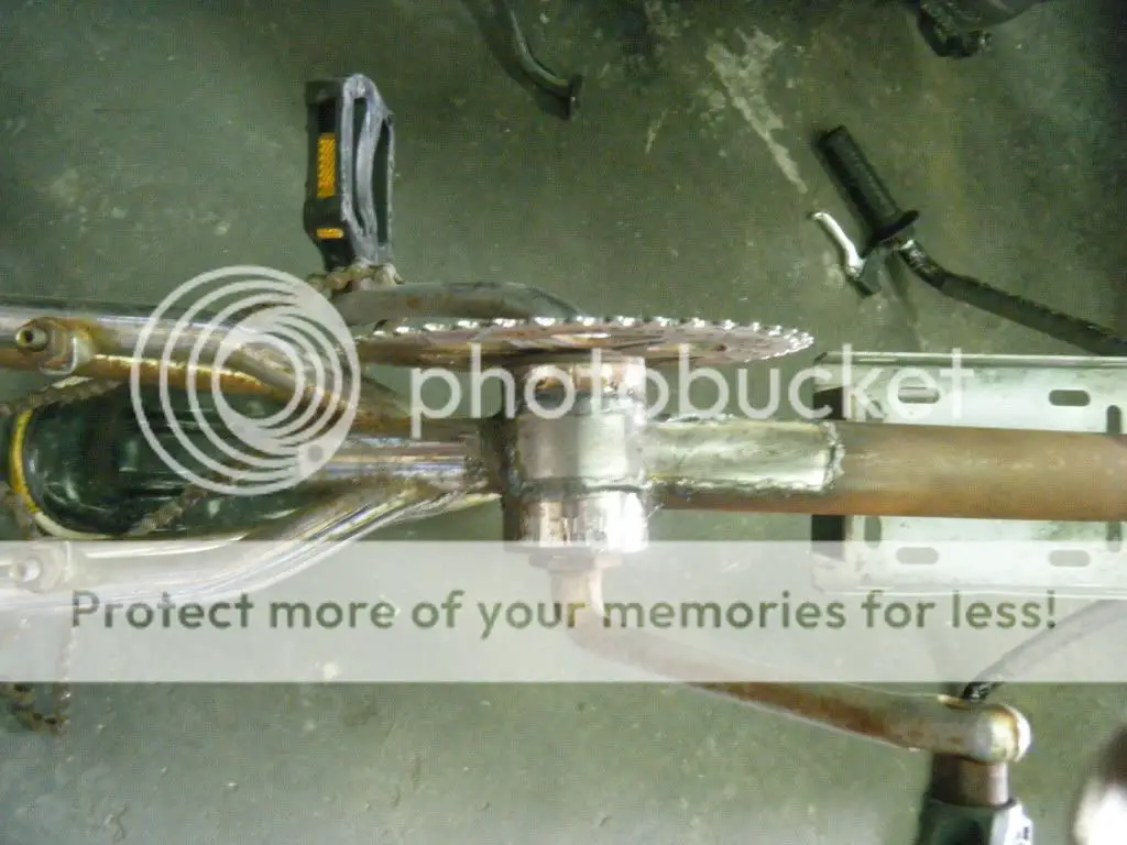

havn't done an awful lot,strengthening mainly. handlebars
got sleeved and welded top to bottom,straps welded underneath
crank and around the seatpost for the back half. bit overboard
really,its bombproof.other than that, the welds were cleaned up
and i started thinking about seating arrangements. (in case it wasnt mentioned
the seat post was extended about 2 inches up and the top bar bent,so the motor would fit)
i really wanted pegs out the front so i could stretch my legs out and lean
back,but that has proven impossible. feet would stop the front wheel
from turning,or you would be so far back you couldn't reach the handle bars.
my legs will have to be bent,and around the motor,and the seat maybe forward.
where it sits in these pics is o.k but when i turn the handlebars it stretches
my arm a bit. a sissy bar was made but its to heavy i think, i may not even
do a sissy bar i have other ideas.
for the jackshaft someone suggested not to even make one and weld sprockets
onto both sides of the hub when i cut the pedals off.two small gears. might be
a plan. i intend to have some kind of fake "clip on" system and keep some pedals
in my bag,try and keep the cops off my back. i can see me getting stopped the
first day.well yesterday i nearly threw the bike in the bin,and my welder mate i dont think
is overly impressed that i come down with no plans and just do what i think.
luckily im still on track. the bike doesnt quite look the way i wanted but i guess
its hard to tell atm. i put it down to being a first go and a learning process. if
i dont like it, i can unbolt the motor and start again.

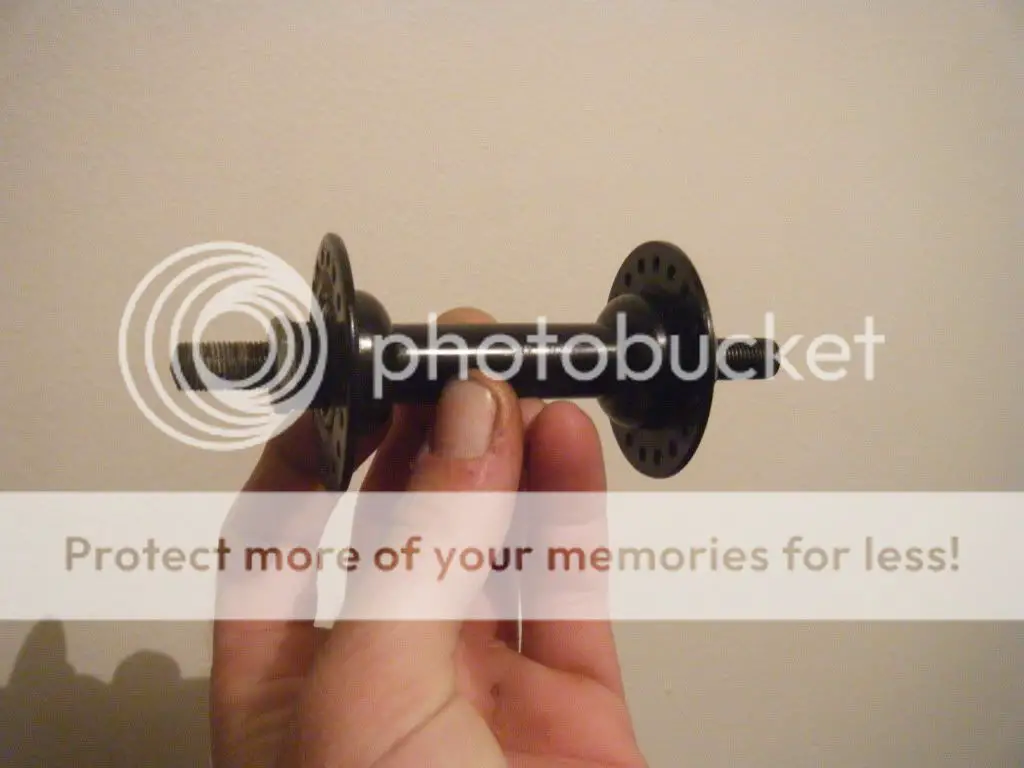

if someone has done the hub/jackshaft idea or knows a bit about gearing,
some advice would be helpful. say the motor has a 11t gear, i was thinking put
another 11t on that side of the hub (same pitch obviously) and another 11t (bicycle chain pitch)
going to the bike chain/derailleur on the other side? i have to look at the motor to see of it will let
the chain will go downward,might not even work. or put a big gear on the motor
side for some reduction then a slightly bigger on the the other side,i dunno.
starting to sound like the jackshaft is easier to do. decision, decisions.
couple of pics, not the most exciting stuff.
The way you outlined you wanted to do it ain't quite right buddy...
I have uploaded a gear ratio calculator for you to my ftp site you can download it and open it in Microsoft Excel and input sprocket size, rpm and wheel size and it will workout for you th exact size sprocket you need for your jackshaft and rear wheel sprocket in relation to the top speed you wanting to achieve it is what I used to workout the ratios for my builds.
KiM

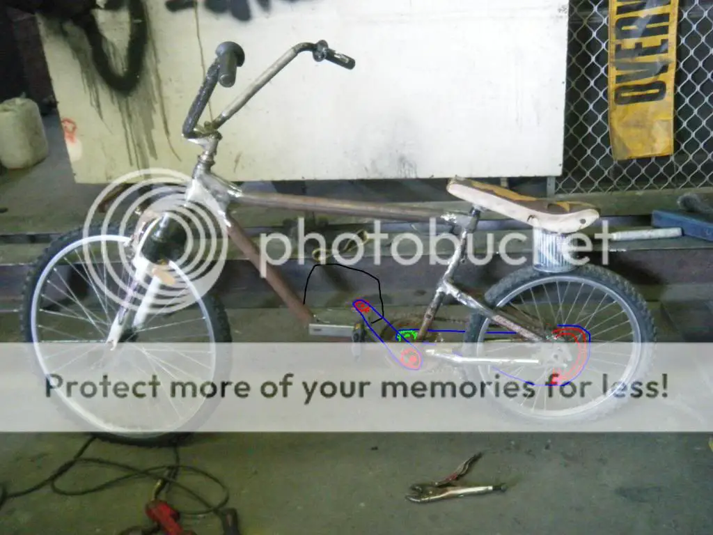

ok, just to make sure were on the same page i have done some
drawings on what im thinking,makes it easier for me to explain as well.
every idea i have here includes a rear gear cassette from a mountain bike.
how i do this i dont know,im thinking there are kids mountain bikes
whether they have a 20 inch rim im not sure but i could possibly swap
the wheel hubs and with a bit of modding get the cassette on the bmx rim.
im dead set on having the gears and a derailleur. that is the red thing around
the back wheel,needless to say my drawings are pretty ordinary.
standard jackshaft- 1:1,drives from motor to jackshaft,across the jackshaft and down
to the front gear where the pedals are. allowing use of the rear cassette gears.-
my first idea- do the exact same but through the hub. use the front hub as the jackshaft.
using two gears the exact same like the jackshaft, would work but i think would ruin its bottom end climbing power. -

the seat is about an inch forward of the old pics and im going to use two
shocks i cut off the front of another bike to support it.these will have a bar going between
them and through the seat instead of a sissy bar with a pivot front. i should have a shock
absorbing seat in the end. i cut the crank hub housing thingo from another
bike and popped out the "circular cups/bearing race" things to make room for sealed bearings.
this will be my jackshaft in the end. just need to chase down some sealed bearings
to fit in there and get some sprockets. need to make a trip to the bearing
shop and this place i found out about today for some gears. the homebrew jackshaft
will be rather wide,there will be very little clearance for the chain on both
the engine and the pedals side.
i am going to get spring loaded pegs for it and other than the jackshaft, my other
concern is getting a gear cassette on the bmx rim and widening the frame to accept it.
tomorrow will be working in the rear wheel and hopefully some pics. i will be going with 11t
gears on the jackshaft and just going the traditional route. if i run into trouble, i do.
also somehow need to fit a mountain bike crank with at least two crank gears,
one for the jacksaft to come down onto,another for the bike chain.
sorry,no pics.
did some work yesterday and got the gear cassette on the
bmx rim, wasnt really that hard. found out aswel that rather than
modifying a crank housing to accept sealed bearings, a bike shop
should sell one with sealed bearings fitted,as one unit. that will
help,the only thing i dont like about bike shops are the prices.
100 bucks to re-spoke a wheel, i can get a new bike for that from
big w. so today i think i will be looking at the jackshaft side of things and maybe
the pegs. surprisingly enough the back of the frame only needed
half an inch or so of widening,just stood on it and bent it slightly.
i have a good derailleur lined up for it also. heres some pics,
one of the pics shows the underneath strap,everything is strap
welded, i dont want the bike snapping in half at 30mph. maybe a bit
overboard, but better safe than sorry. hopefully next week or the week
after she'll be a goer. still have to work out how to get a dual/tri gear
crank off a mountain bike on there too,that should be fun. :( lol.
the seat and everything else is last minute stuff, im going to try
and focus on the mechanics of it for now.
in this last picture you can see the shocks lying on the floor, i have lined up for the seat.
thanks for looking.

came from,but on that note, i have decided to use a wheel hub off a mountain bike as
the jackshaft. i have been told not to use it, but i greased the bearings up good,cleaned it
all thoroughly, and i reckon she'll be sweet. just need to weld some sprockets on there
and weld it to the frame with some bracing.
today i did nothing really but stripped a wheel for its hub and took some more
pics. the lads had the bike with the motor on it, sitting on the racks. thought i would
snap some pics just for the sake of it.
instead of putting a mountain bike crank sprocket on there, i might drive the
standard bmx one from the jackshaft, and get another sprocket i have from a mountain
bike thats a bit smaller,and weld it on the outside.all will make sense when i get some
better pics next week.
my new jackshaft
