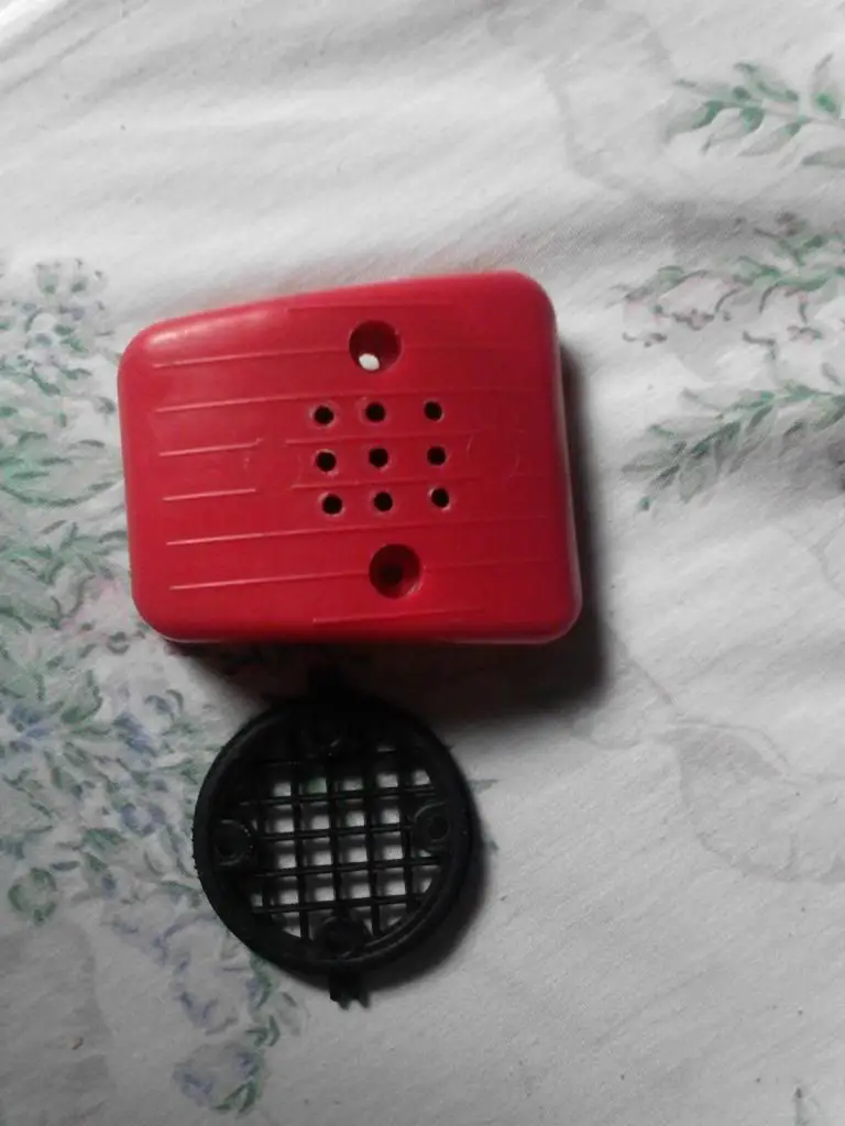

Hi guys, my motor pk66 is riding fine, great little thing. Performed plug chops to see if im running rich or lean (running 24:1 cheap 2t oil and had the needle c clip at 2nd to top setting) Checked the plug and saw it still flat black and kinda oily. And read about something about drilling a few holes on the stock pink 66cc air filter box to promote better air flow and possibly make my plug chocolate brown (trying to lean out my setting) .. after drilling a few holes, started my motor and it idled very high & adjusted the idle screw and the motor died. It only starts when I turn on the choke lever then when I turn the choke back off, the motor won't start. Did I messed up the air filter box? I want to start riding again :-||
Here's the air filter box I drilled

first thing I'd do is put some tape over those holes to see if problem goes away - you might have knocked something else out of whack while working on it

It SHOULD run pretty much the same with or without the filter. The stock filter should not restrict air flow that much. (which it sounds like it was doing.) Unless like crassius said and ya knocked something out of whack. Check for intake air leaks and a slipping choke lever. The choke might be slipping down and cutting air flow. And OH YEAH, Make sure the petcock is all the way ON. Hey, It happens more than you would think.
fatdaddy.
P.S. Read yer post a little closer. If it runs with the choke on then yer getting too much air from somewhere. Check for intake air leaks.

Thanks fatdaddy and crassius for the reply.
I did taped the holes and got it to start and run again. But I noticed that choking the motor isn't killing it. It used to kill the motor when I choke it after warm up but after I did the air filter mod, starving the engine of air isn't killing it . I'll try to look for that darn air leak.

I concur with FD... The holes shouldn't have much affect on it.
My guess is that some dirt is clogging the main jet in the carb.
That might explain why it only runs with the choke on?, (because the choke forces it to draw extra fuel from the float bowl). :confused:

i will check the intake manifold to see if it has air leaks. im suspecting that too much vibe & gas melted the previous silicone rtv i smeared on the carb connection since the rtv i used is only high temp & is not gasoline resistant. thanks for the help guys! :)
A quick, simple intake leak test.
Get a catsup or mustard bottle with a squeeze top. Drizzle water on both fittings, one at a time so you know which end. The engine will either stop or slow if water is getting in. And the little water that gets in won't hurt the engine at all. Cheap, simple, quick and DONE.

i use starting fluid to check for leaks, start the engine then spray a little around the intake and base gasket, if the engine revs up then you have a leak

Thanks a lot for the help! I did start the bike today and ran it for couple of minutes. I did a comparison run. With the filter box hole not taped, the bike ran fine at first but after several seconds of short burst WOT, the bike bogged down and sounded like it was starving of fuel (maybe?) After the 1st run, I taped the holes and the bike ran great and no bogging down, but when the bike was idling, the rpm is slowly increasing. Really suspect the leak is coming from the carb connection to intake manifold. disassembled the carb and intake manifold and cleaned the crapped out rtv and replaced em with fresh rtv silicone. Still have to wait for tomorrow to see if it works
Fatdaddy- thanks for the ketchup bottle technique. Will do that to check after the rtv has cured since I don't have starting fluid around the shop
