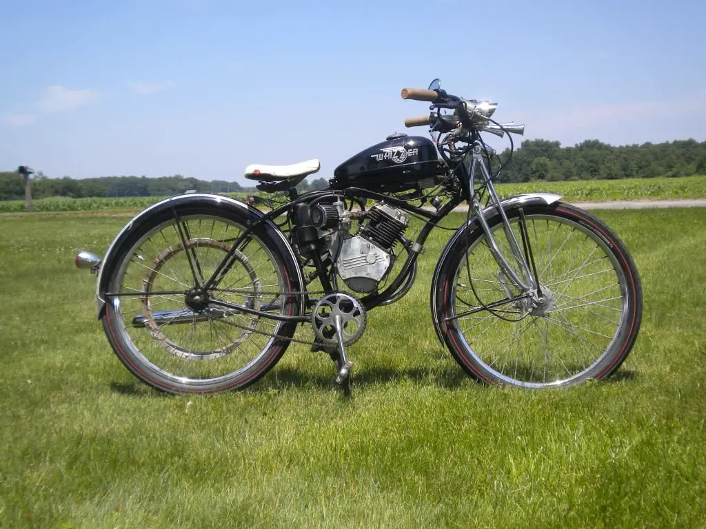

I finally mount the hi flow muffler that a friend here made me mm? aka Ray, and to my surprise the previous owner had removed the muffler,I thought It had, because had this mounted,before it sounded like mini HARLEY.trk and now sound like cruiserusflgbut I can live with thatbrnot Thanks Ray.

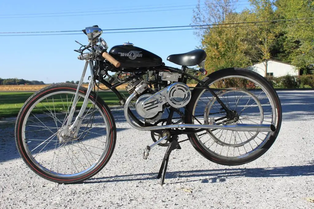

I installed a vintage seat and shorter stem to bring the bars down a bit and give the bike a more vintage look.

Here is a pic I took after riding it and putting it up for the winter. The bars are chopped Dyno bars. The seat is also Dyno. I had so much fun with this bike over the summer. I put over a 1000 miles on it this year going nowhere in particular, just cruising!
Looks good Highwaystar.
