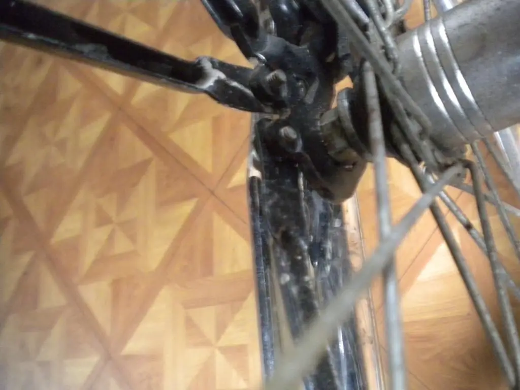

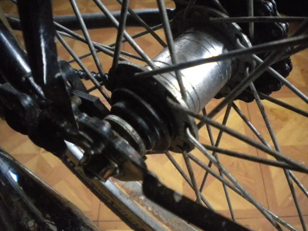

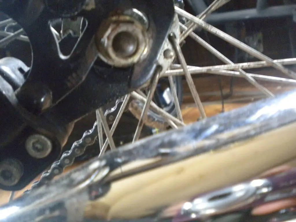

Here are a few pics of the Whizzer wheel. I am pretty sure the threads on the axle compressed when the axle bent. The nut will not budge. I am probably going to have to split it with a grinder to get it off.
Try a box wrench rather than a socket or open end, and give it a couple of whacks with a hammer rather than trying to tourque it off. Sometimes breaks it free quite easily.
Geo.
Geo.
The rounding of the nut was from using a 15mm Snap-On 6 point wrench and piece of pipe. It is hard to see in the pics but there is a nasty bend in the axle. I am pretty sure the bend has compressed the threads locking the nut into place.
