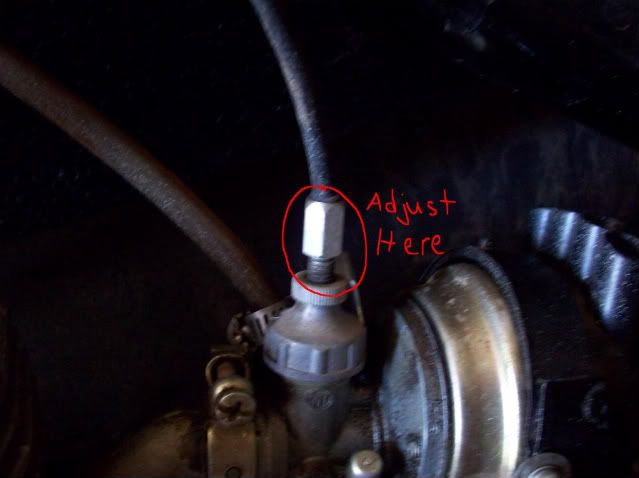

First off..... I'm hooked on this damn thing!! Finished my build this weekend...and took some residential cruises. My question involves idle speed. From what I have read, the screw on the carb adjusts the idle speed. As I was cruizing at a fast idle, I was adjusting the carbs screw and it didnt seem to make any difference in speed.

Yeah some of these idel screw's just don't work, I'm lucky mine work's fine. Maybe it is working but you have your throttle cable too tight and your throttle slide is not going all the way down. Adjust on top of the carb, hopefully this is what it is.

Yeah....I have the cable end adjusted all the way down at the carb....but I was thinking the same thing about the slide not being all the way down. Could it be possible that the throttle cable is too short?

I would try adjusting the cable at the top of the carb completely one way then completely the other if nothing changes then I would think you might have a cable problem. remove the cable end from the throttle handle on the bars to see if that helps if it does then you are probably right the cable could be too short.
