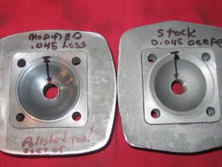

left is the machined head on the right is a stock head 0.045 is removed from head measured from the edge of the plug hole to the lip on the gasket surface. To measure this I bridge a flat plate across the heads gasket surface then measure it with the dial calipers to get a difference in the depth from the heads surface to the edge of the spark plugs hole.

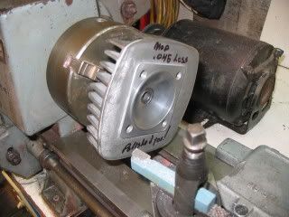

what it looks like chucked up in the lathe

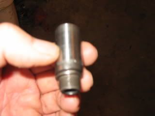

the holding tool made out of a spark plug. Some times I can get the camera to focus and some times I can't.
I made a fixture out of a china spark plug to chuck the head in the lathe then using the diamond wheel I cut me a bit out of a carbide tool to work over the head.
