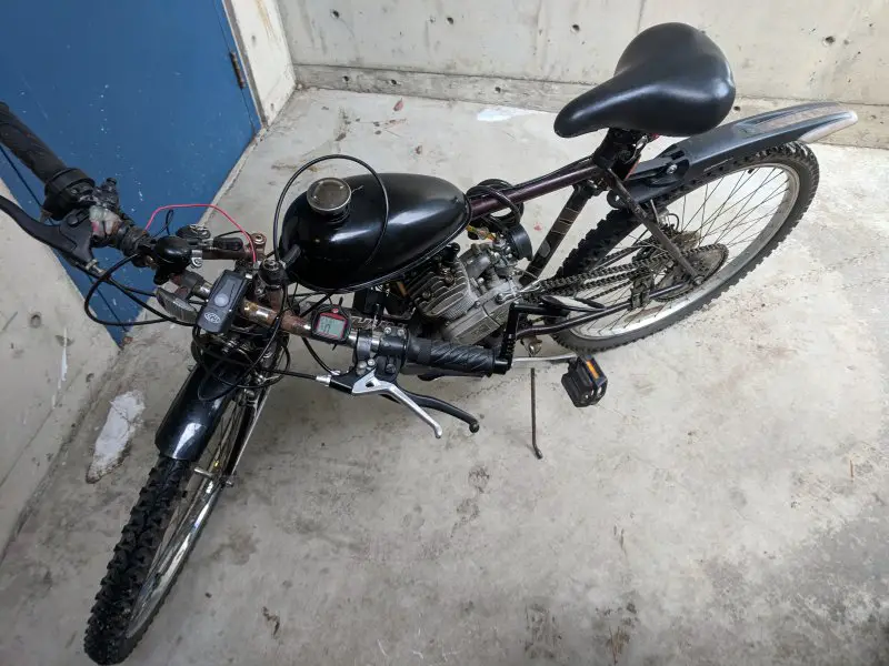

Howdy Folks,
I recently purchased my first gas bike kit - a Grubee Skyhawk GT-5A 66cc bike kit, preinstalled on a rusty but solid OLD mountain bike. Got it all "as-is" for $150 Canadian, which seemed fair. It appears to have 180PSI! Is this bad? Looks like I should have seen 100-120 PSI, maybe 130, with all these stock parts.

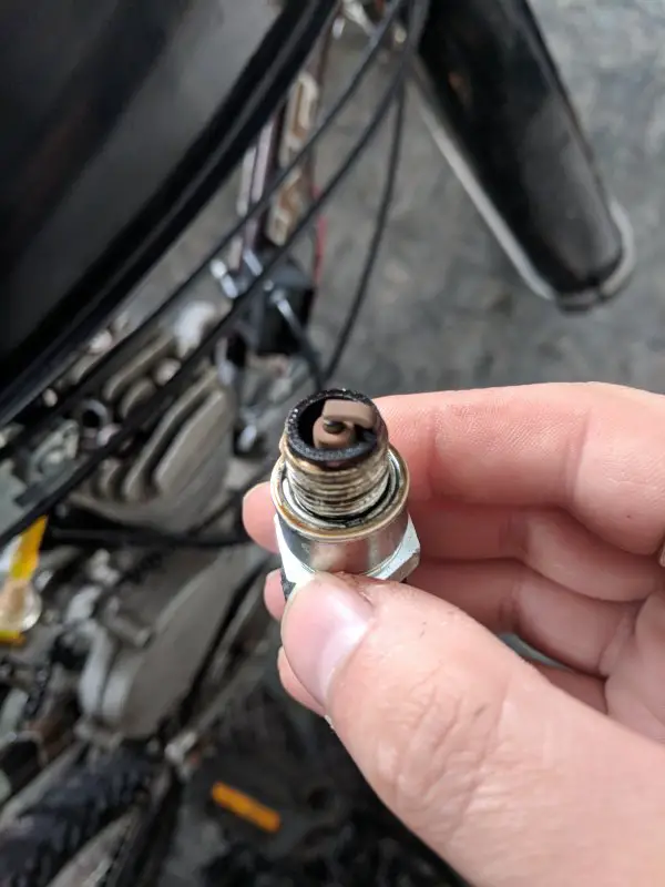

Although my spark plug has maybe an hour of ride time on it, it looks to be a nice caramel colour with needle on the "highest" (richest) setting, but I get MUCH 4-stroke action. Have yet to try the leaner end for more than 1 ride, but I'm worried about overheating my engine with this high PSI, if it is not getting enough oil. I did try lean for 1 ride, and it immediately has more power and less 4-stroking.

Probably Thursday I will check PSI again, and also check my spark plug for colour with the new setting. Should be approx 10km total with this leanest setting, so I'll see what my spark plug says. FEELS great tho!
Well, it is snowing AGAIN. Still no PSI test. I do have good news though. I am usong the leanest setting on stock carb with stock jet (and 89 octane gas with approx. 32:1 ratio), and spark plug colour looks gorgeous! I am not a professional, but I seem to ONLY be getting 4-stroking when cruising or lowering my throttle; no or VERY minimal 4-stroking occurs when I accelerate, go uphill, or put any noticeable load on the engine.
