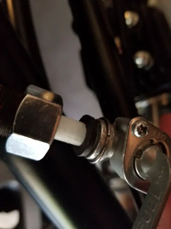

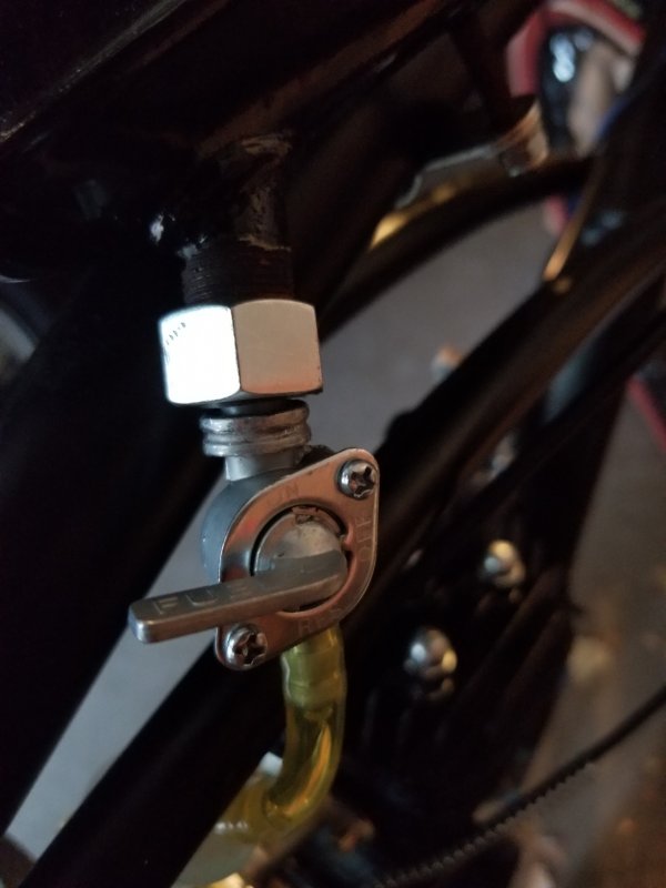

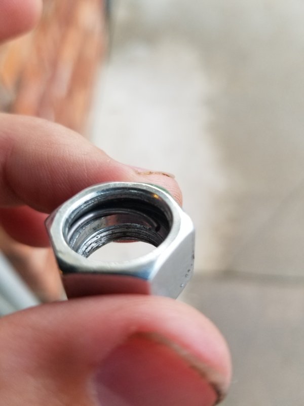

Cool I will! I have another problem tho... My petcock broke, like the nut that attaches it to the gas tank is just popping off of the fixture to the petcock. Might have to order another one, but I'm afraid the same thing will happen to this cheap peice of garbage. Any ideas?
Here's some pictures of the petcock problem.

Yeah but it's impossible to get it back on whether the clip is in the nut or if it's around the other part. .
He's got a petcock with male threads on the end... My gas tank has male threads coming out of it that's why I have a female petcock.
OK, so I solved the petcock problem. Also, I got an NT carburetor for adjustable jetting. It's running way way better so far. Still needs some fine tuning. I also got a long offset intake manifold thinking that would help boost power and acceleration, which it does a little bit. So now I am at the point where I want to fine tune this carb. I tried all the jet needle clip settings, and I think I have it on the middle one now. What else would you recommend for tuning this for high altitude to max out power and acceleration and speed? Do I need to buy new jet needles?
