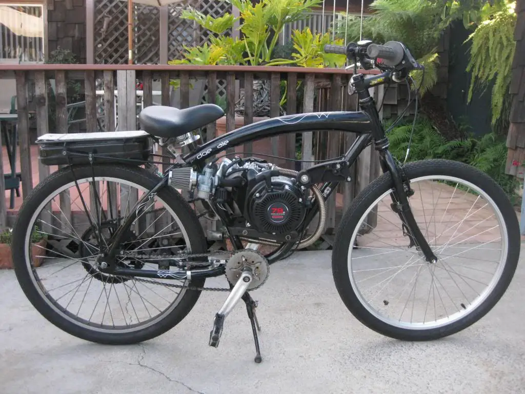

Finally finished the bike today. Hooked up the rear "V"brake with U adapter and a dual pull lever for one hand braking. It stops extremely well......powerful, yet predictable. Also got the throttle finished as well as the front engine mount. Took it for a test ride and it's running quite nice and smooth.
Will ride and dial it in completely tomorrow......stay tuned....dnut

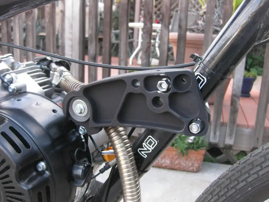

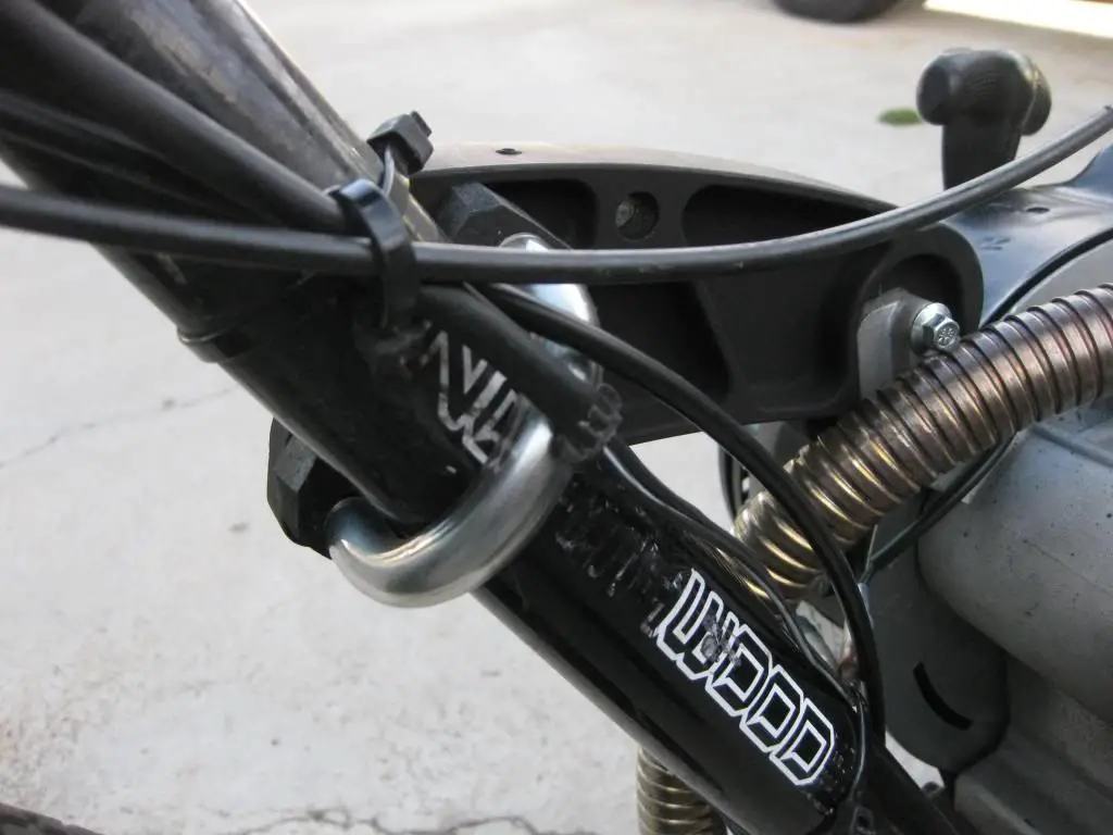

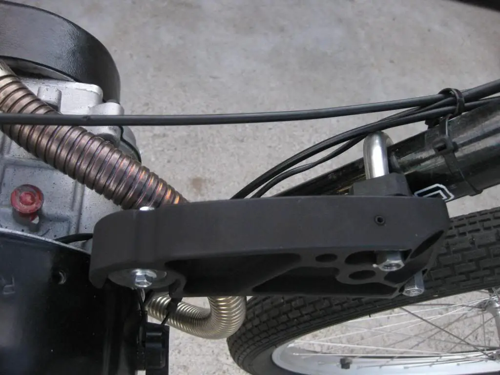

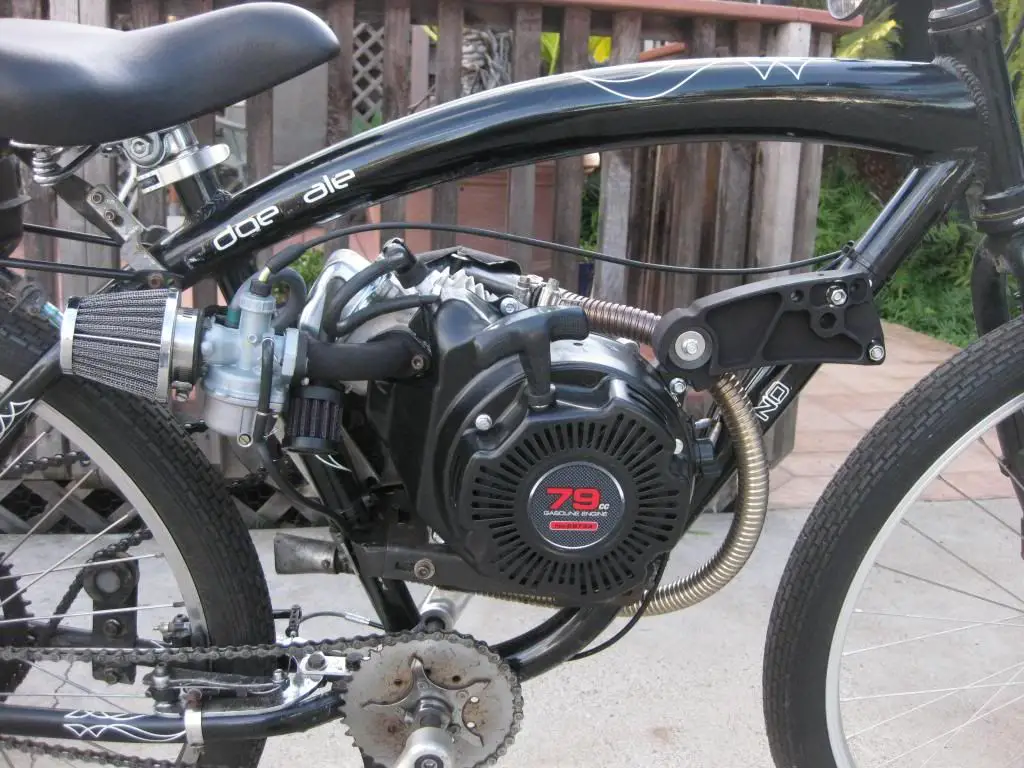

Here's the finished bike......runs GREAT! Some close-ups of the front engine mount and the painted AGK manifold and 19mm carb all finished.
I think my son Neil will like it.....all he had to do is pay for the engine ;-) I took it up one of the steepest hills in UC today and it flew right up it!
