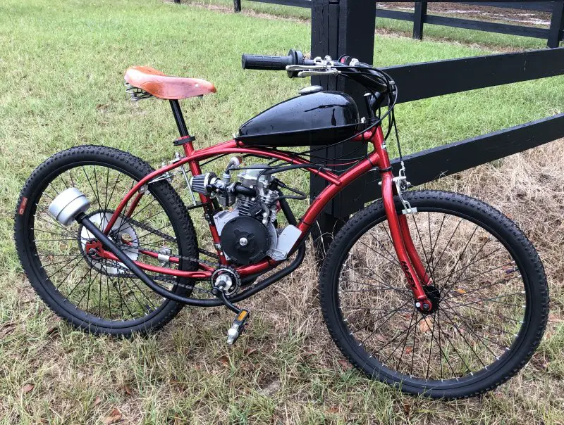

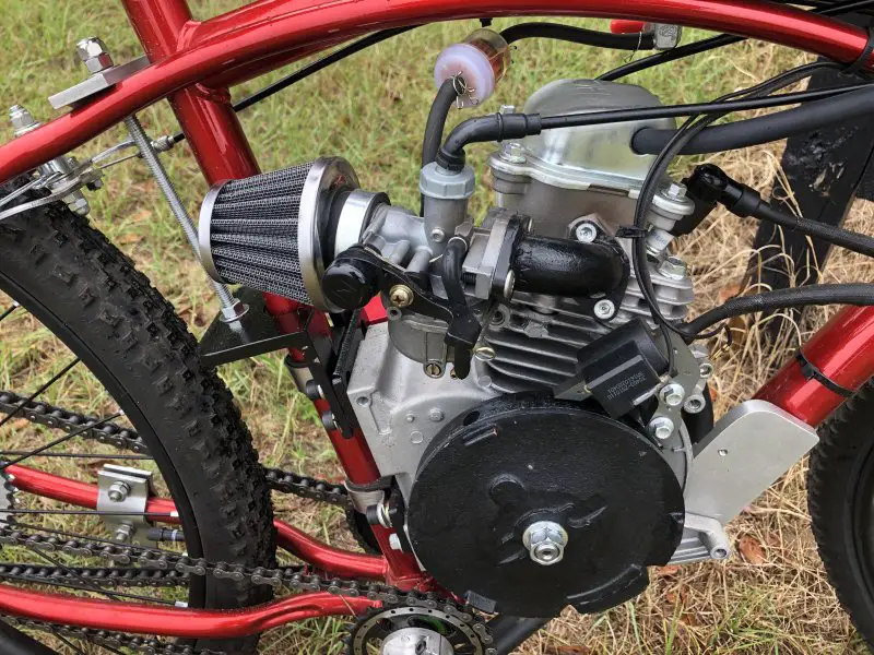

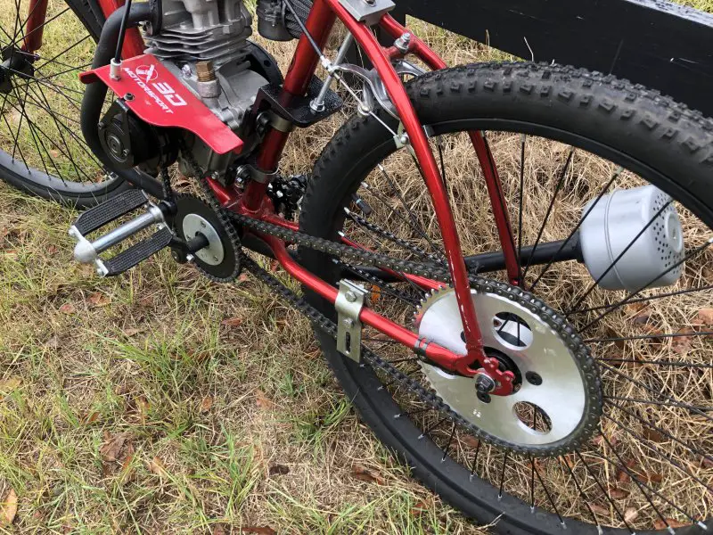

Finally mostly done and debugged
What did you have to change to mount the engine vertical beside carb manifold.? Will it oil ok mounted like that?
